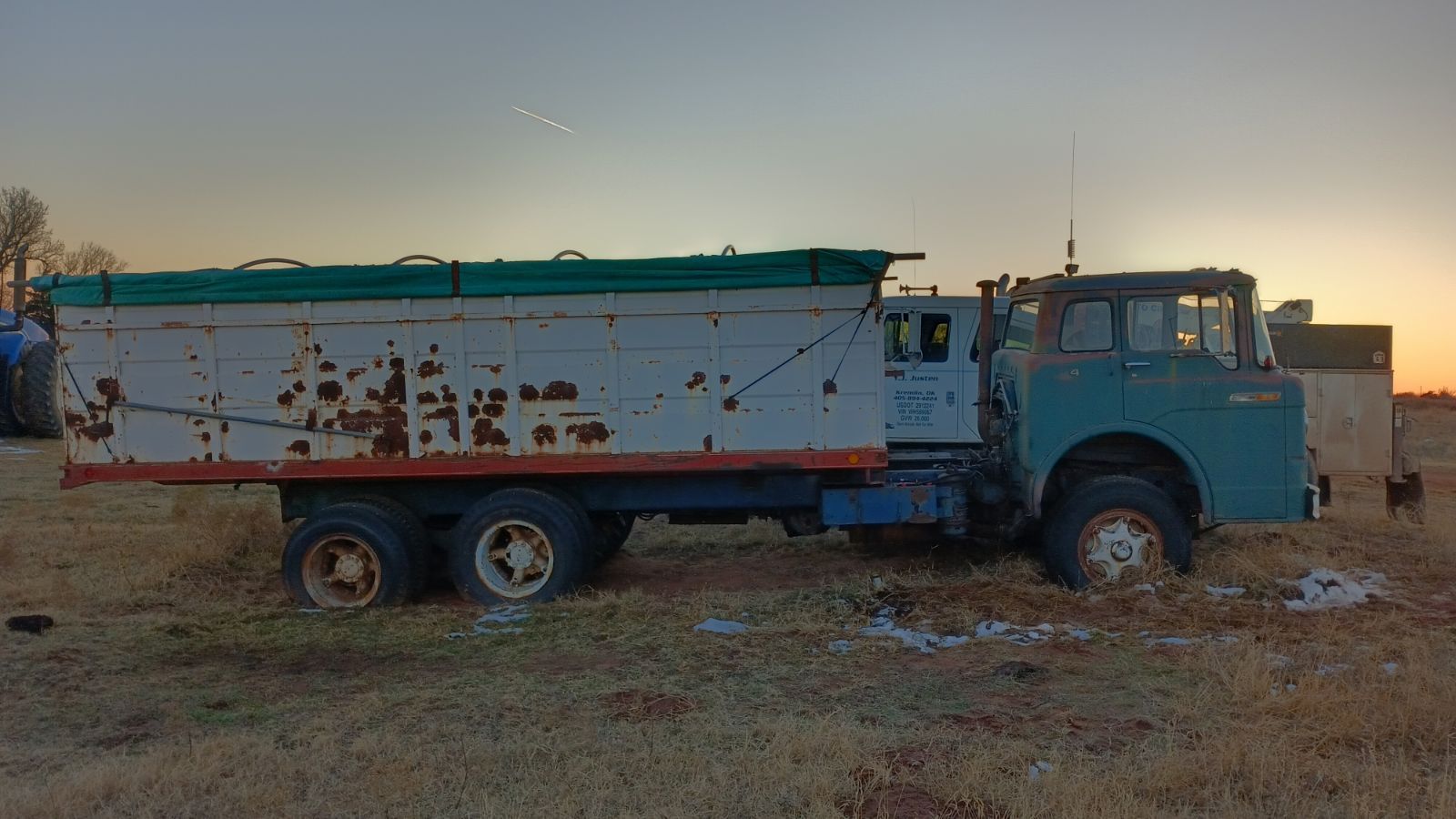

I know it's a 1969 with a C160 Cummins, 5 and a 3 tranny.
VIN: q80yue24310

Welcome back!
Q80 = CT800 diesel
Y = Cummins C-180 six cylinder 464 CID diesel engine (The C-160 used engine code "Z" for that model year--could be a swap?)
U = Louisville Assembly Plant
E24310 = 1969 numerical series, November 1968 production
194 = 194 inch wheelbase
L = Dark Green
Q800 = CT800 diesel, 43,000 lbs GVWR (Plate shows 53,000--could be related to the special order axles etc)
4 91
4 = Black Corinthian Vinyl (should be two characters....??)
91 = Standard cab, tilt cab
No transmission code
No rear axle code
H = Rockwell (Timken) model FG-903 front axle, 15,000 lbs capacity
53000 = 53,000 lbs GVWR
159 2500 = 159 Certified Net HP @ 2500 RPM
179463
17 = Washington District Sales Office (Wash DC)
9463 = Special Order Number
