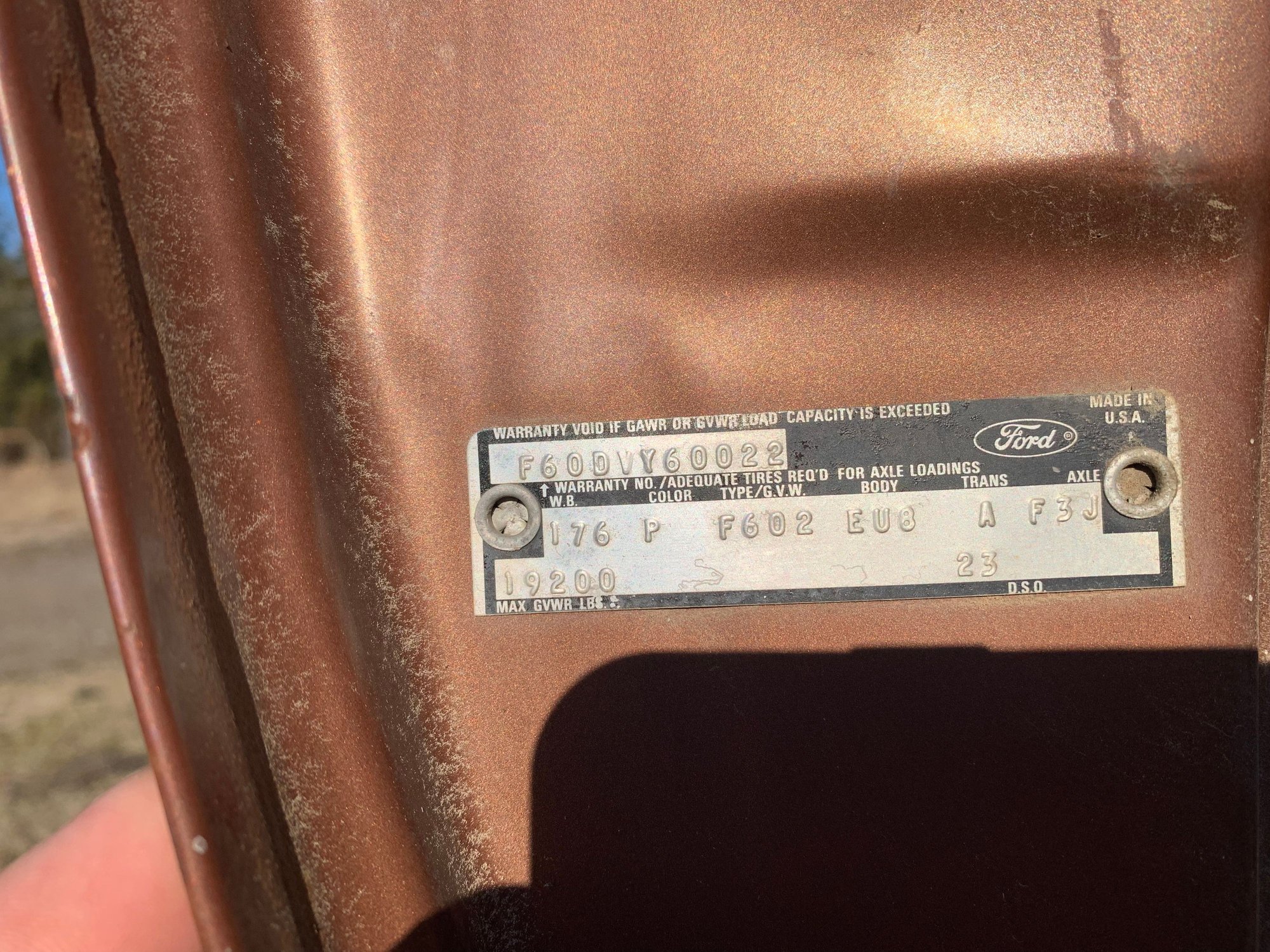

Vin Decode please Sir

F60 = F600 gas, 4x2
D = 330 2V HD "XD" FT gas V8. Check your crank snout diameter if you are going to do any engine work. I am pretty sure you have the larger one. (1 3/4" vs. 1 3/8") (It's the "XD" that makes me say that--strange things happened in the last years of the FT with the smog rules etc)
V = Kentucky Truck Plant
Y60022 = 1977 numerical series
176 = 176 inch wheelbase
P = Dark Nectarine Metallic
F602 = F600 gas, 4x2, 19,200 lbs GVWR
EU8 = Looks to be Custom Cab. I do not have all the info on upholstery or seat type.
A = New Process model 435 four speed transmission
F3J
F3 = Eaton model 15201 two speed rear axle, 15,000 lb capacity, 6.33/8.81 ratios
J = Ford 5,000 lb capacity front axle with power steering
19200 = 19,200 lbs GVWR
23 = Charlotte District Code
No special order
Let me know if something does not line up.
