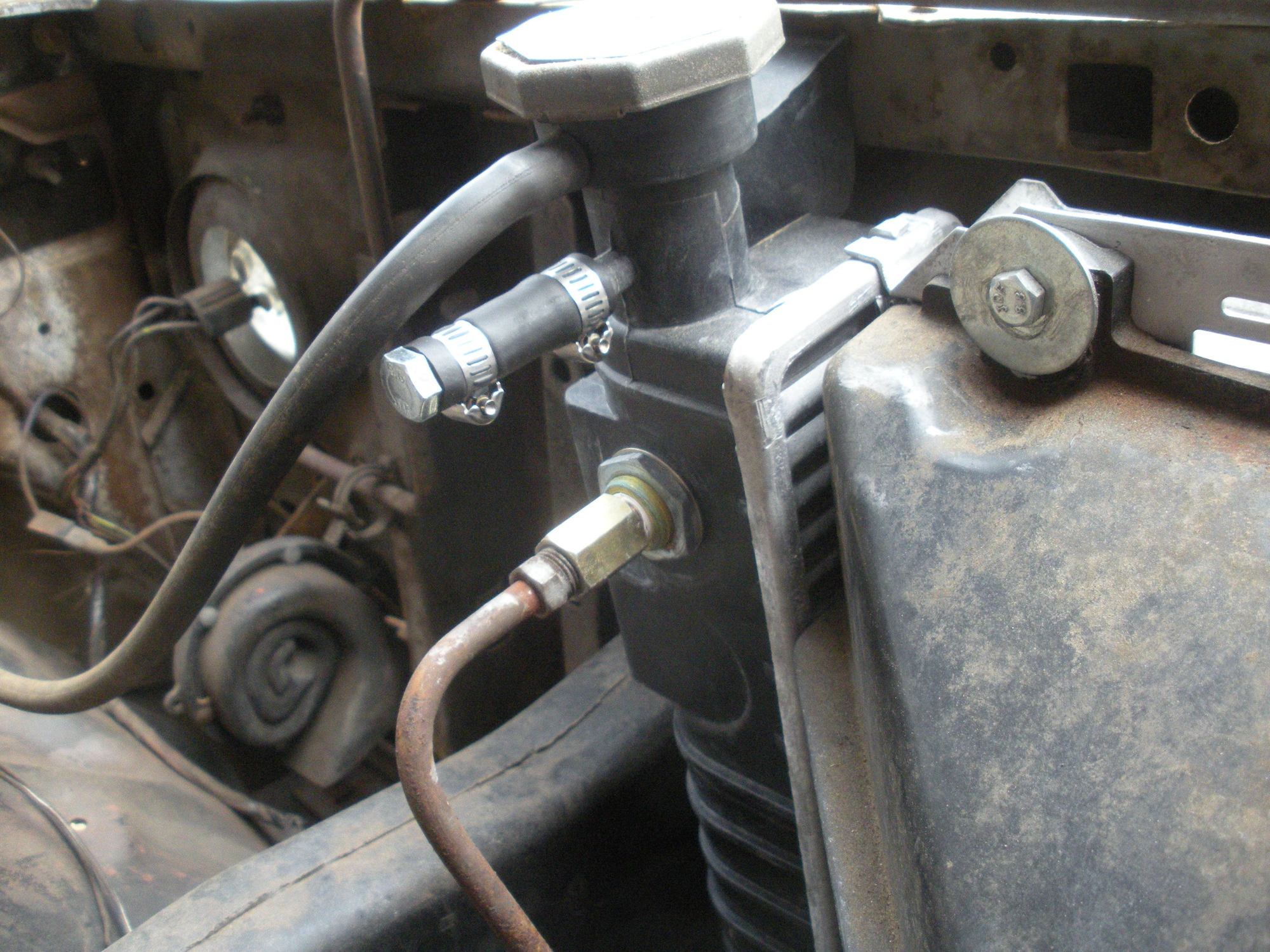

I just replaced my STANT cap(maybe 2 years old) with one that has the red lever. For the first few drives it seemed to fix my problem, but then noticed it was overflowing again.
My Rad has 2x ports on the neck. One below the cap which goes to the tank, and one above the cap that drains to the street.
It shouldn't be "over pressurized" like this, right?

The Rad is aftermarket, though only an OEM replacement. If I block the lower port and move the overflow to the upper port, then it will only flow to the tank when the cap is compressed due to heat. But then the tank won't be able to fill the Rad either.

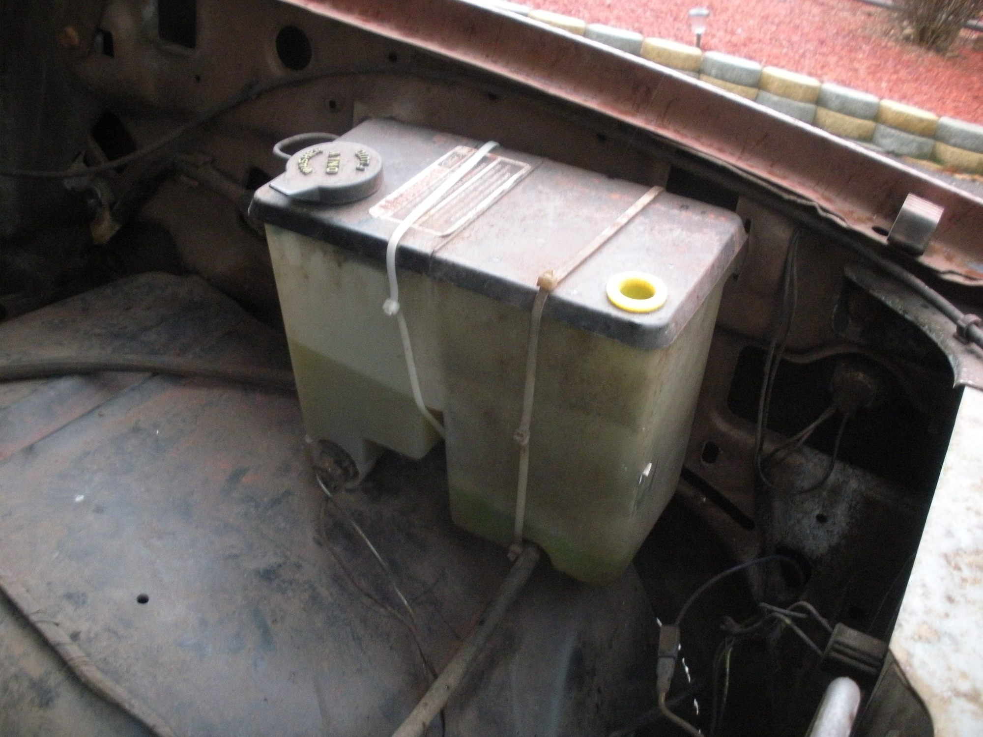

Larry and RYan, can you guy's post pictures of what your radiator, cap and overflow tank look like ? Here's mine in my 86' 302EFI. This with the engine cold. Notice the level in the overflow tank. Radiator is a OEM style replacement .
It's a 13lbs cap.

Max it looks like you have a recover tank and not a over flow like I have.
I guess some did have recover tanks?
Dave ----

My Rad is the same. I have my overflow connected the the lower port. Yours is capped.
my upper port is just a hose to the ground. It stays pretty dry....because coolant comes out of the overflow tank.
It seems like I should try your setup.
Dave mentioned that our overflow tanks are not recovery tanks. My tank - the hose from the RAD goes in the bottom of the tank, not the top. Like the pic above. *how important is it to cap the overflow tank? Mine is open. I know I should be careful of debris, but it's not a pressurized tank.

I would hook the recover tank up like Max has it.
As for over flow or recover I did not know the tanks came with the hose to the bottom like yours & Max that wold be a recover tank as the hose is in fluid all the time and can be pulled back into the cooling system when it cools off.
There is no need to cap the tank but if you want to measure the opening and look for a cap to fit.
I need to get a picture of mine but it dose not have a cap or any way to clean or fill it.
I had to use a small funnel to fill it where the hose goes in at the top.
The full blck top on mine is also glued to the bottom so no way to pull it off for cleaning
Dave ----
