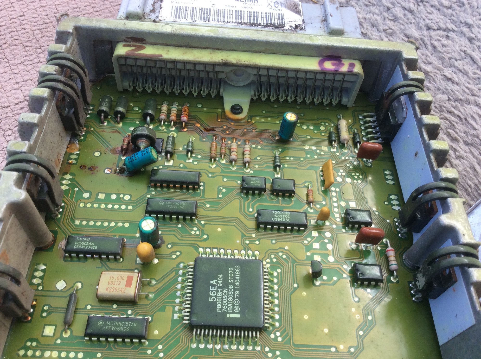

I removed my truck's computer(Ford EEC IV). I found that all three electrolytic capacitors had been leaking. I saw this YouTube video
I am not as capable as that guy. I won't attempt to replace the capacitors. I am amazed that the truck was still running with all that circuit board damage. Also amazing is that when my truck was scanned, no error codes were emitted that described my computer problem. Here is a photo.
The capacitor that I pushed over only had one lead still attached.
Now, I will try to find the proper replacement. I inputted my details into napaonline.com and they listed several items. I just have to figure out which one to order. The price is about $225.
