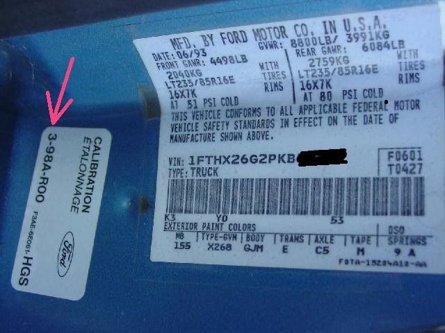

How do I get the right one all the stickers are torn off

Is the calibration code on the driver’s side door jamb?

Is that the only number I need

Yes. Put that number here and in the search function to see if someone has already asked for the correct part number. I cannot look it up but there are people on here that can.
