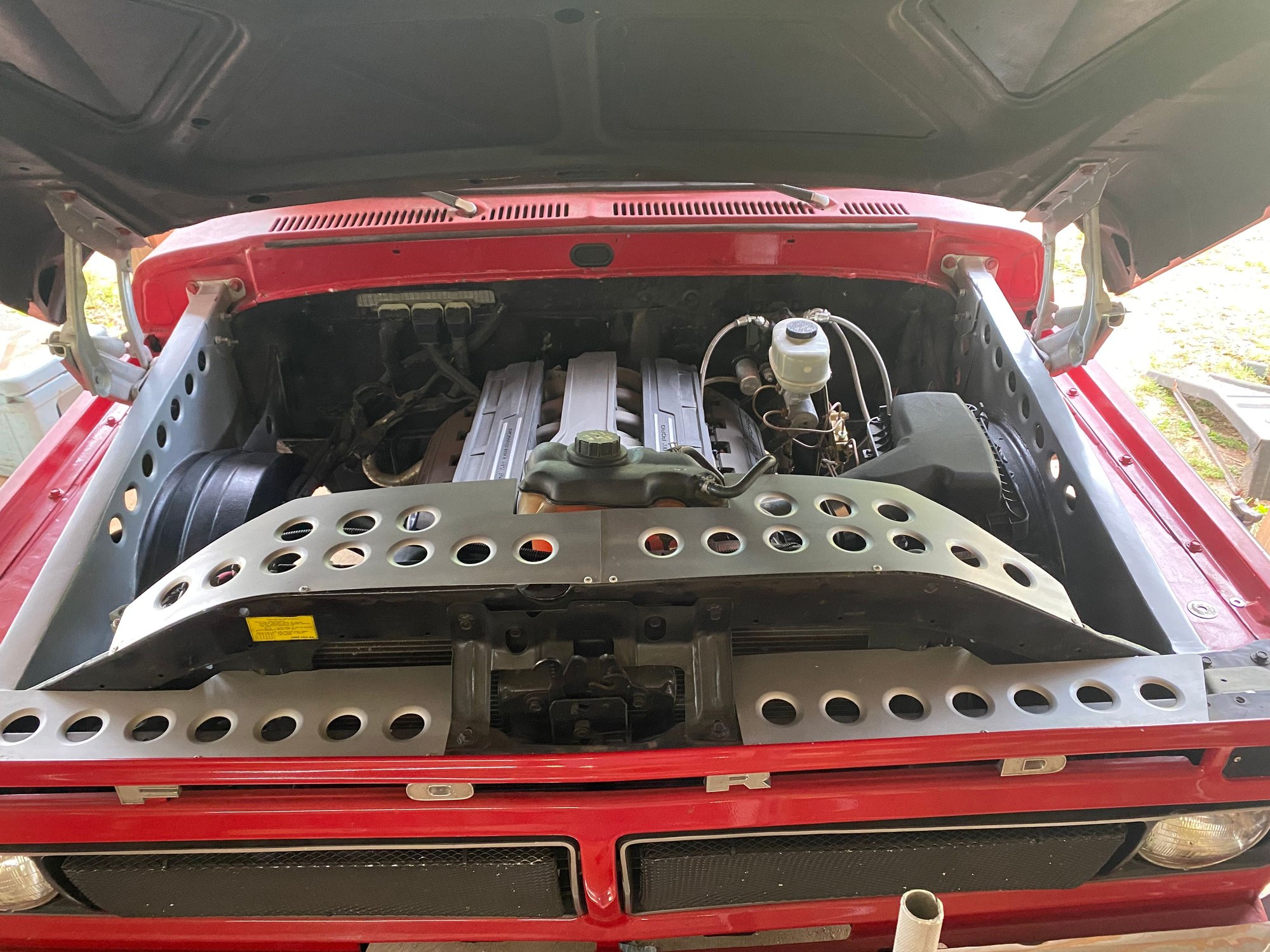

For one that has done the swap, go for it, but only if you love this truck! It’s expensive but oh so worth it. Look for a gen1 f150 and 6r80 for least cost, but still expect to spend 10-15k minimum. I love it and have no regrets swapping out my 460. Super reliable, absolutely 0 problems. Crazy power and in my lowered ‘73 with 6r80 and 28” tire I get 22-25 mpg. Last road trip was 165 miles round trip at steady 70 and used exactly 6.5 gallons. I think this is primarily due to the truck weighing 2,000# lighter than a modern truck along with the 6 speed. I would drive it anywhere and do drive it a couple days a week. Here is install photos. Be glad to help with questions.
Engine and Trans - 5-8k
Fuel System - 1k
Gauges - 1k
Steering - 1k
Engine and Trans wiring and Management - 2k
Miscellaneous -2k
Labor??
Old Nov 5, 2023 | 10:00 PM

For one that has done the swap, go for it, but only if you love this truck! It’s expensive but oh so worth it. Look for a gen1 f150 and 6r80 for least cost, but still expect to spend 10-15k minimum. I love it and have no regrets swapping out my 460. Super reliable, absolutely 0 problems. Crazy power and in my lowered ‘73 with 6r80 and 28” tire I get 22-25 mpg. Last road trip was 165 miles round trip at steady 70 and used exactly 6.5 gallons. I would drive it anywhere and do drive it a couple days a week. Here is install photos. Be glad to help with questions.
