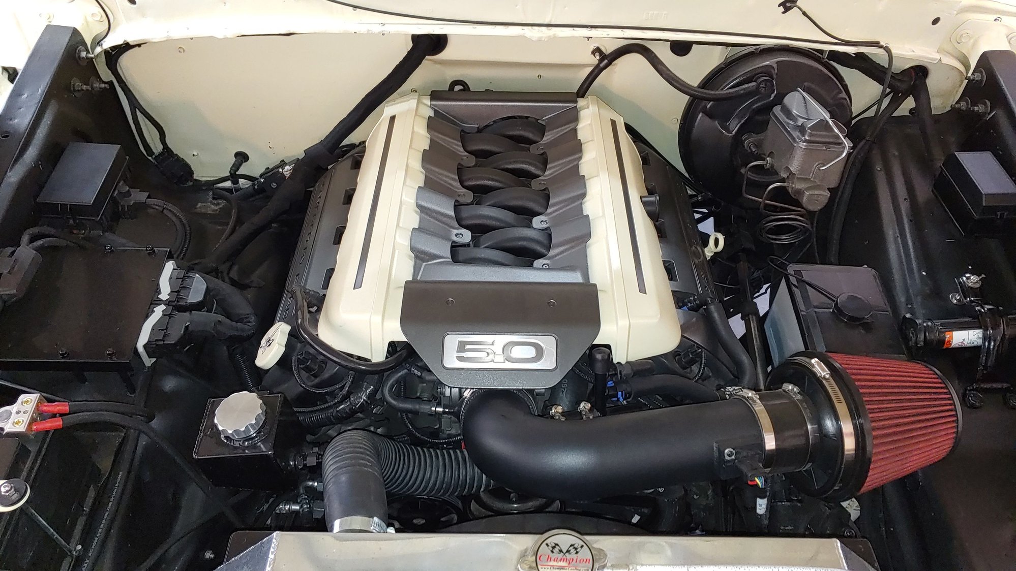

I'd say swap in the Coyote. You won't recoup the mileage for what you'll spend but if done right, you'll have an awful lot of personal satisfaction. I always said do it because you can and no other reason. I sold mine for a tidy profit which I never expected would happen. Then the guy that bought it from me sold it for $15K more. The countless compliments and thumbs up as well as the "What the hell is in that?" when it shifts at 7000 RPM with 3 inch exhaust is priceless. It's spendy, but oh so fun! I went GEN II Mustang with 6R80 and Ford Control pack which consists of connecting 5 wires and firing the engine. Crazy simple. Only 1 regret...........I sold it.

Thanks for the compliment. Have a look at mine and 73 FOMOCO's build threads. Every question you have will be answered in detail. For your gear ratio, jack it up and put stands under it. Put a chalk mark on the rear tire and one on the driveshaft. Turn the tire and count how many times the driveshaft turns for one rotation of the tire. Eg. if the driveshaft turns three times with one tire rotation you have 3.00:1 gears. You may be in over your head as far as skill but you'll learn as you go. Have no fear!
https://www.ford-trucks.com/forums/1...te-swap-7.html

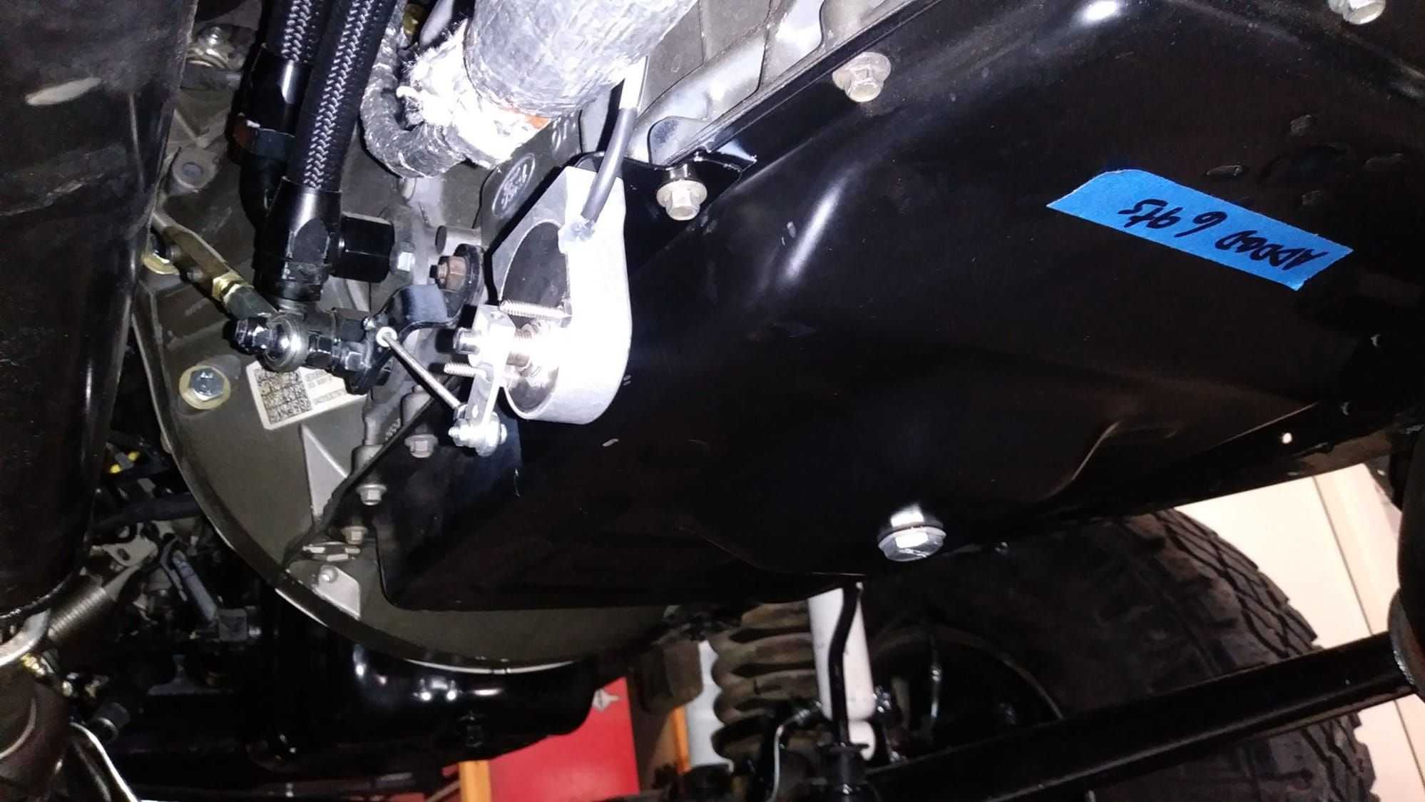

Another q. Obviously my existing column only has D, 2 & 1, how’s that work with with the swap and 6spd tranny?

You buy the shift rod and connect it and it works the same, however the indicator on the column does not line up. I added select shift which is like paddle shifters but instead uses a toggle switch if you want a gear lower than the drive gear. You will only ever use P R N D. You can see a close up of the linkage in my thread. I never installed the stop for the linkage like some have and yes I've shifted past drive into the next detent and it gears down just like a normal trans. Insane easy for this and cheap. I didn't use FFg shift lever, I simply flipped over my existing shift lever. Watch this video.
