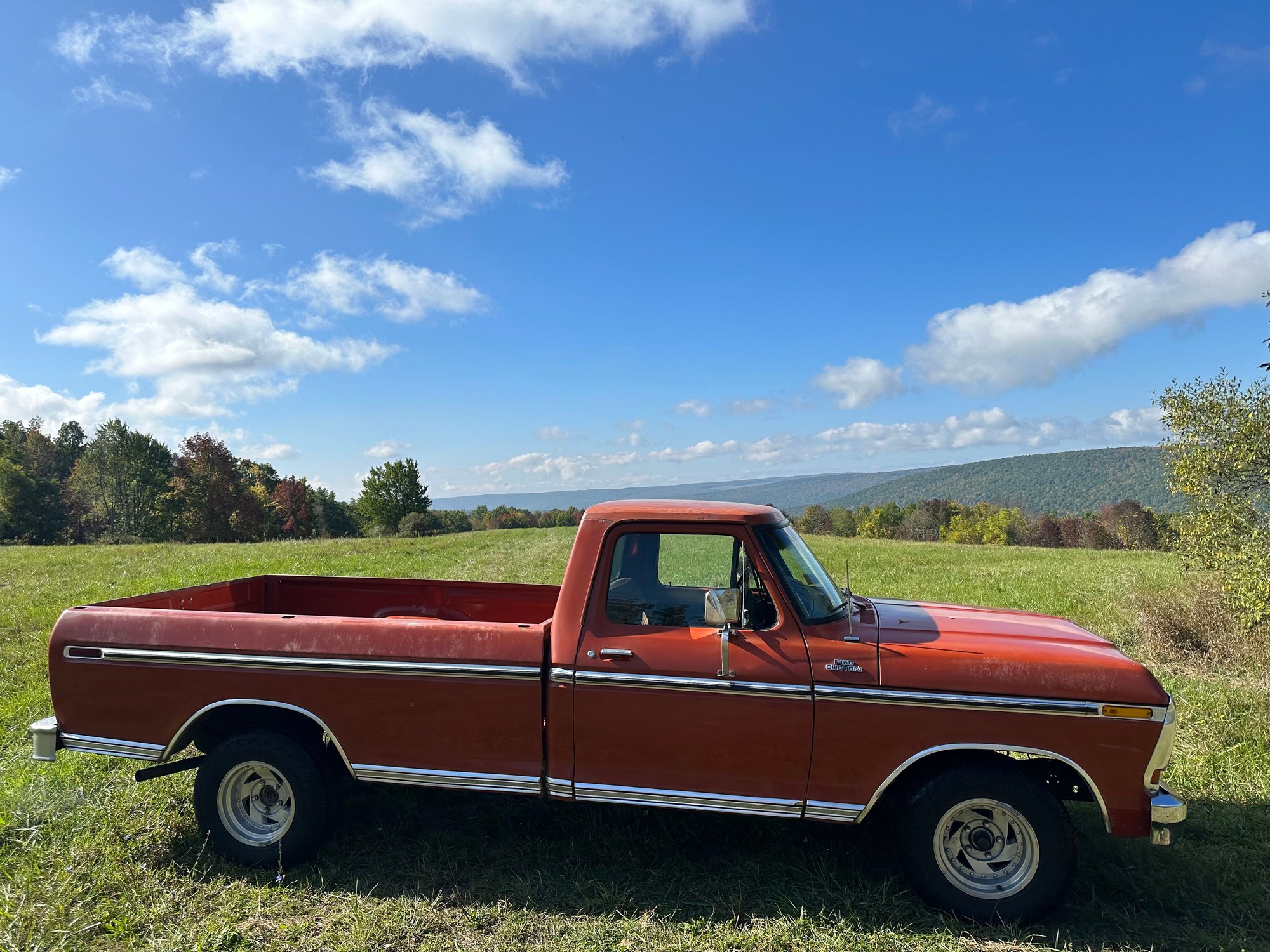

I get so many compliments or thumbs up. In NY you don’t see many at all here.
Here’s a pic.

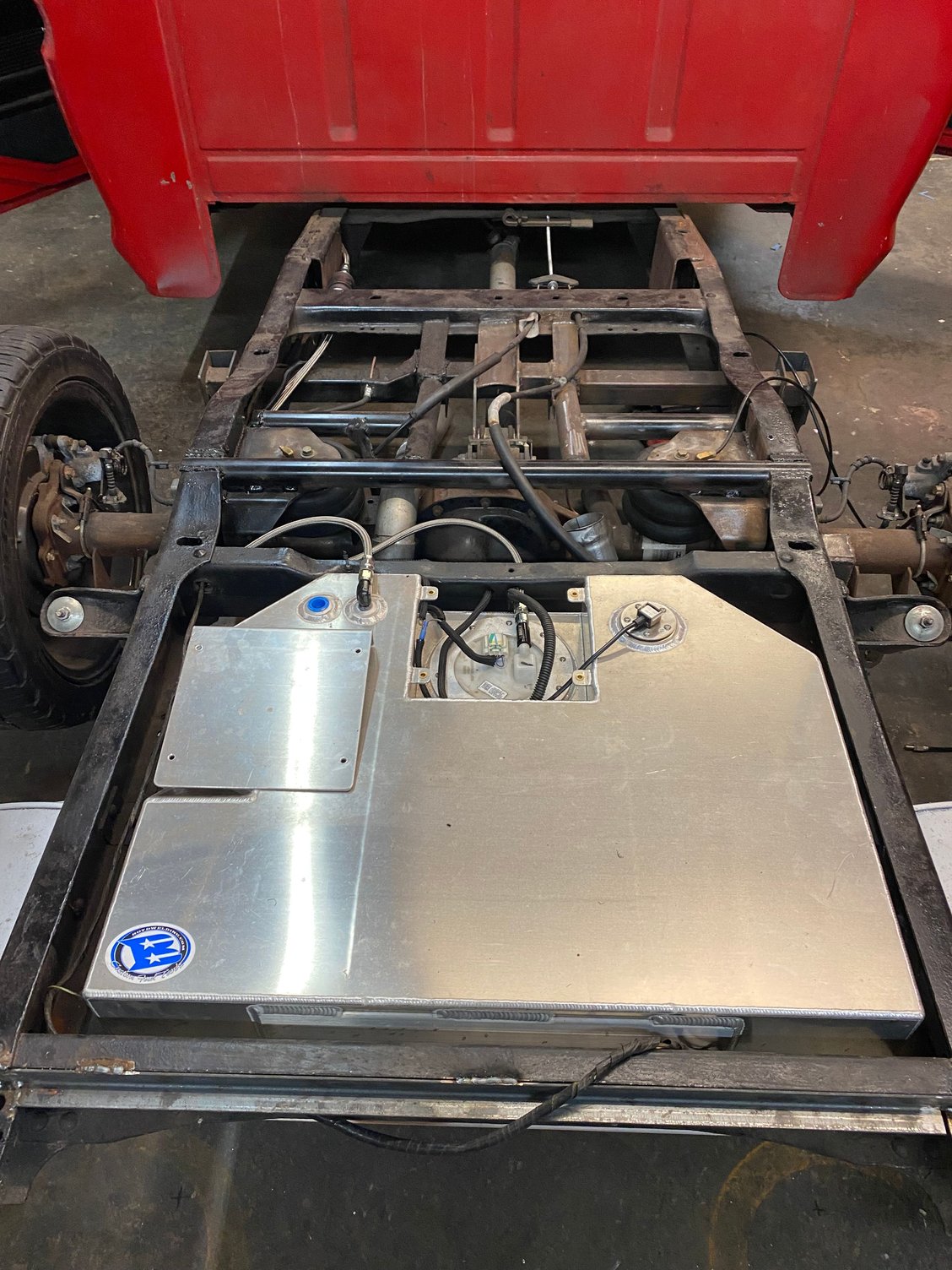

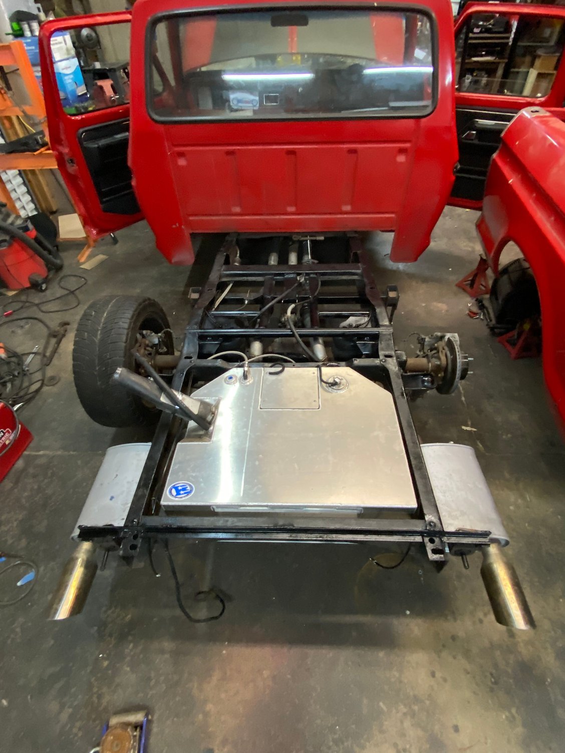

23 gallon Boyd’s Aluminum Fuel Cell, VDO sender. The tank is built so a Stock GM ZL1 pump drops in perfectly. Big plus that you can pickup a factory pump if you ever were to need a replacement. I used a C5 corvette fuel filter regulator mounted on the frame rail close to the fuel cell…it filters and regulates and returns anything more than you need to the tank. It’s used a lot in LS swaps and works perfectly on the coyote swap. Here is a pic of the fuel cell. AN fittings and braided PTFE line to the intake manifold. I did shorten from LWB like yours to SWB. Due to the shorter wheelbase I had the 2 piece driveshaft shortened and balanced. I took all the length out of the front shaft. No issue to 7200 rpm redline. I did have to change yokes to match the flat plate output of the 6r80 and also the flat plate of the 3 link mustang 8.8 disc rear axle. I can get pics of those if needed.

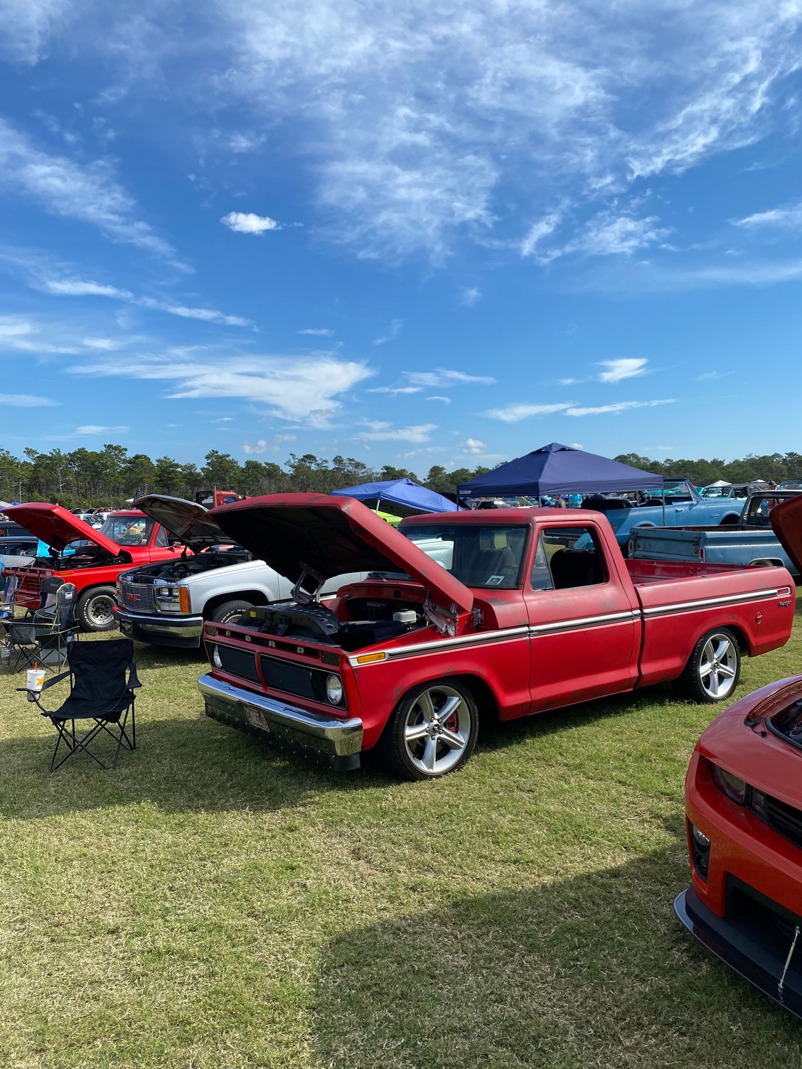

100% agree on the lowering and air dam…helping with mileage. Notice my homemade air dam under bumper. I did all of this for stability. On a closed course when tuning the setup I had to do a wot pull from 15mph to redline locked in 3rd gear….which was 114mph. I wanted it planted and it is very stable at speed. I did do away with the rear bags in the above pics and using summit’s dual adjustable coilovers on the rear. QA1’s on the front with crown vic front swap.

Nice truck! This was almost my truck exactly. Mine was Ranger but same exact exterior color and trim package I had to start.
