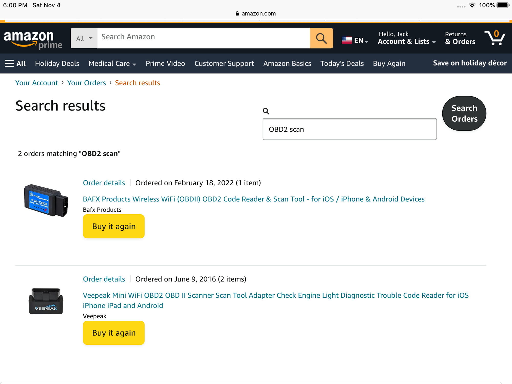

iPhone; ForScan, which is the best, with an OBD2 Bluetooth. Either of these work, I prefer the smaller, cheaper one with my F350 as it does not pultrude into the leg area.
And why I have a T/C in both exhaust manifolds.

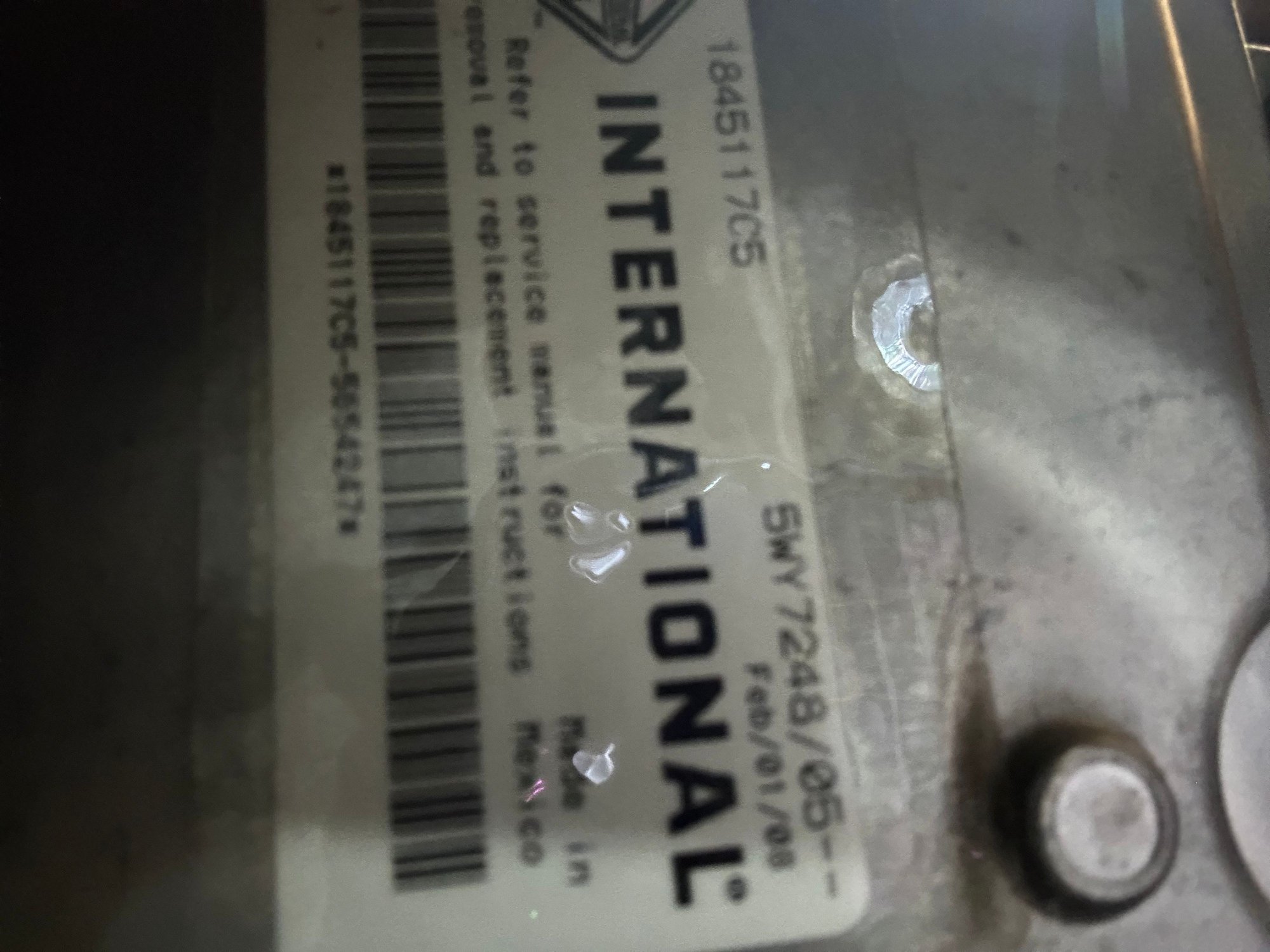

After installing the SCT I’m seeing low FICM voltage (32-33) in the mornings. I was able to get a pic of the backside sticker since there aren’t any identifiers on the top. p/n 1845117C5 and date stamped Feb 01/08.

Your FICM needs to be repaired.
FICMRepair.com
or
CircuitBoardMedics.com
Old Nov 13, 2023 | 02:55 PM

FICMrepair is en route. Quick on the phone , very knowledgeable and great advice
