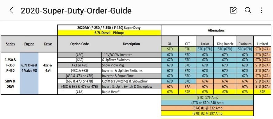

Originally Posted by 4wd6.7L
Yes, it is dual.
Judging by the list of options, the only one that I have is the first one (43C, inverter in cab). So, I have the 240A single alternator. Thanks for the chart, that's very informative!

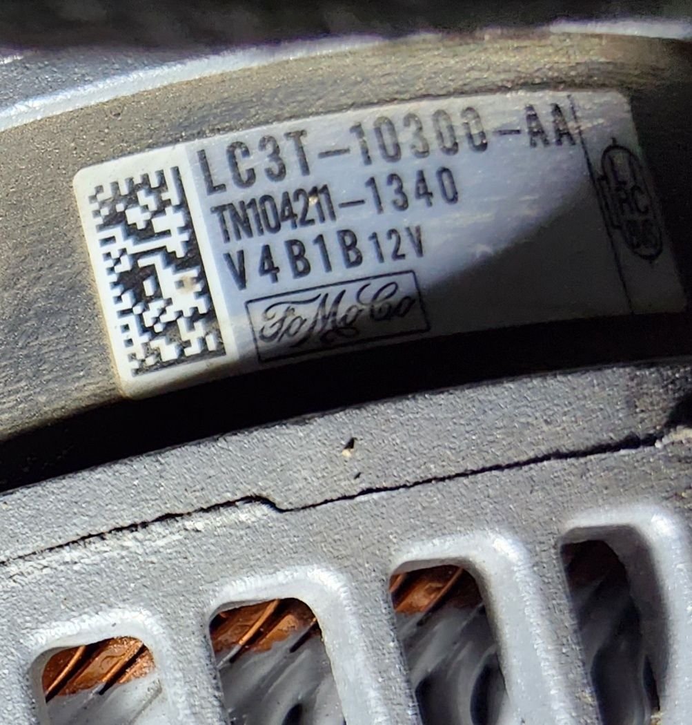

Originally Posted by Great Danes
I will have to disagree on this point. My truck has the supplemental heater but only the single 397amp alternator. Perhaps this is something that changed from 2019 to 2020?
Are you going by the window sticker? I think you have dual alternators. My window sticker says "397A alternator" but I have two alternators. I checked the part numbers; the one on the left is 240A, the right one is 157A.
