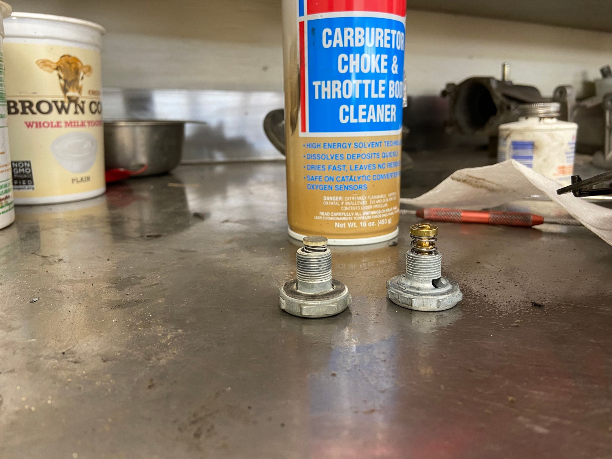

My carb was leaking at the accelerator pump so it was time for a rebuild. The first time I ever heard of a power valve was when I rebuilt the Ford (Holley?) carb on my F1. It seems the Motorcraft on my 351M has this too. But my rebuild kit came with a power valve that is significantly different from the one that came out.
My question is will it matter?

Often the new style power valves won't interchange with the old ones . you could try it.
The blow out protection is in the metering block.

I decide to try it and it seems to working fine.

The power valves are interchangable. The larger holes will give a little bigger shot. blow out portection is through the bottom of the carb, most never Holley's have it and there is a kit for older ones.

I think one of those is a two stage power valve. Either will work.
