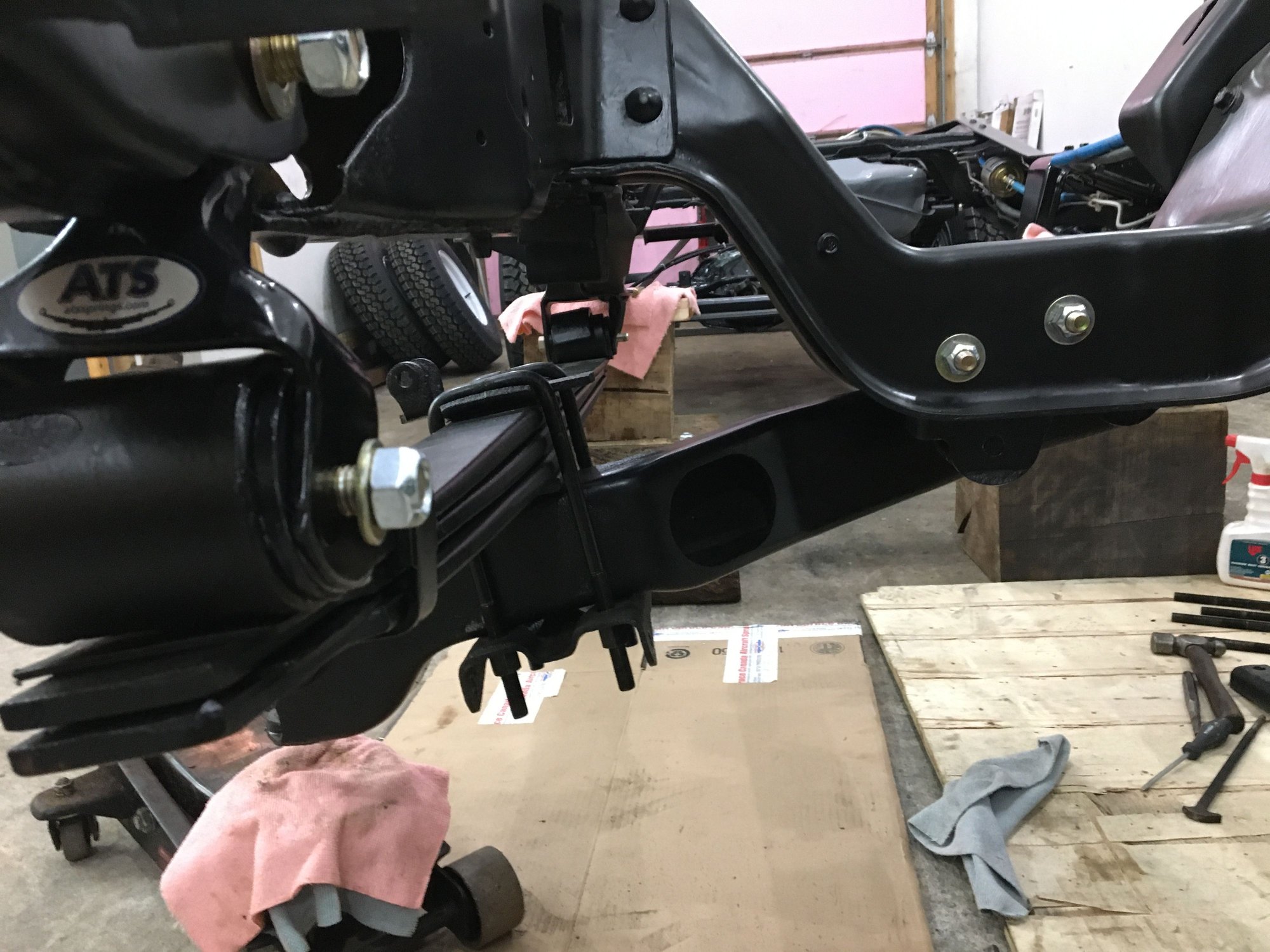

Not to highjack this thread.. but I’ll post these for demonstration purposes the difference in hardness/flex between oem rubber and poly bushings. Big difference in my experience. Polyurethane is a much harder compound than oem rubber, or the S&B silicone. And will continue to harden over time.
Overview - this is a TTB setup, with heavier than stock springs, a lot of twisting force on these springs through the spring bushings. The actual shackle bushing inside the frame rail with oem rubber bushings (which I don’t have a pic of handy) deformed to the point of hard metal on metal contact between the frame and upper shackle sitting static. The poly did not deform at all. (That I have a pic of).
Over view. All parts are new and defect free.

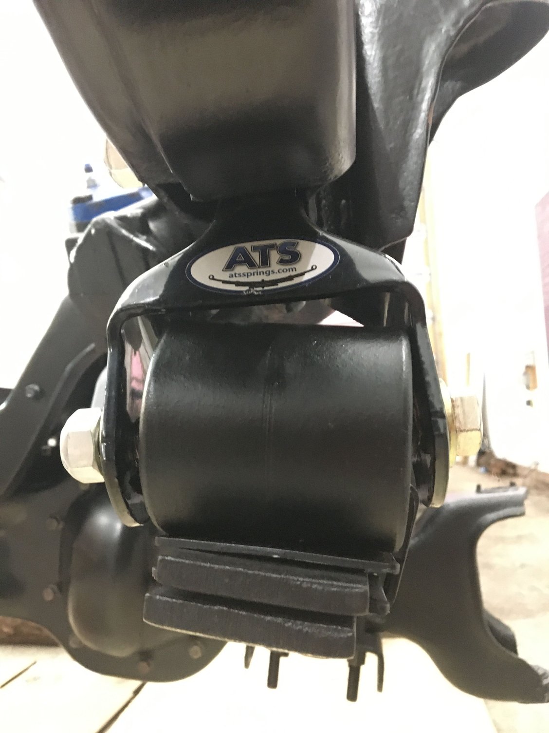

OEM bushing. Hard over metal on metal. Bushing has completely deformed. Upper oem rubber shackle bush failed inside the frame rail. Shackle is hard over on the frame.
Poly, held the leaf in place with little deforming.

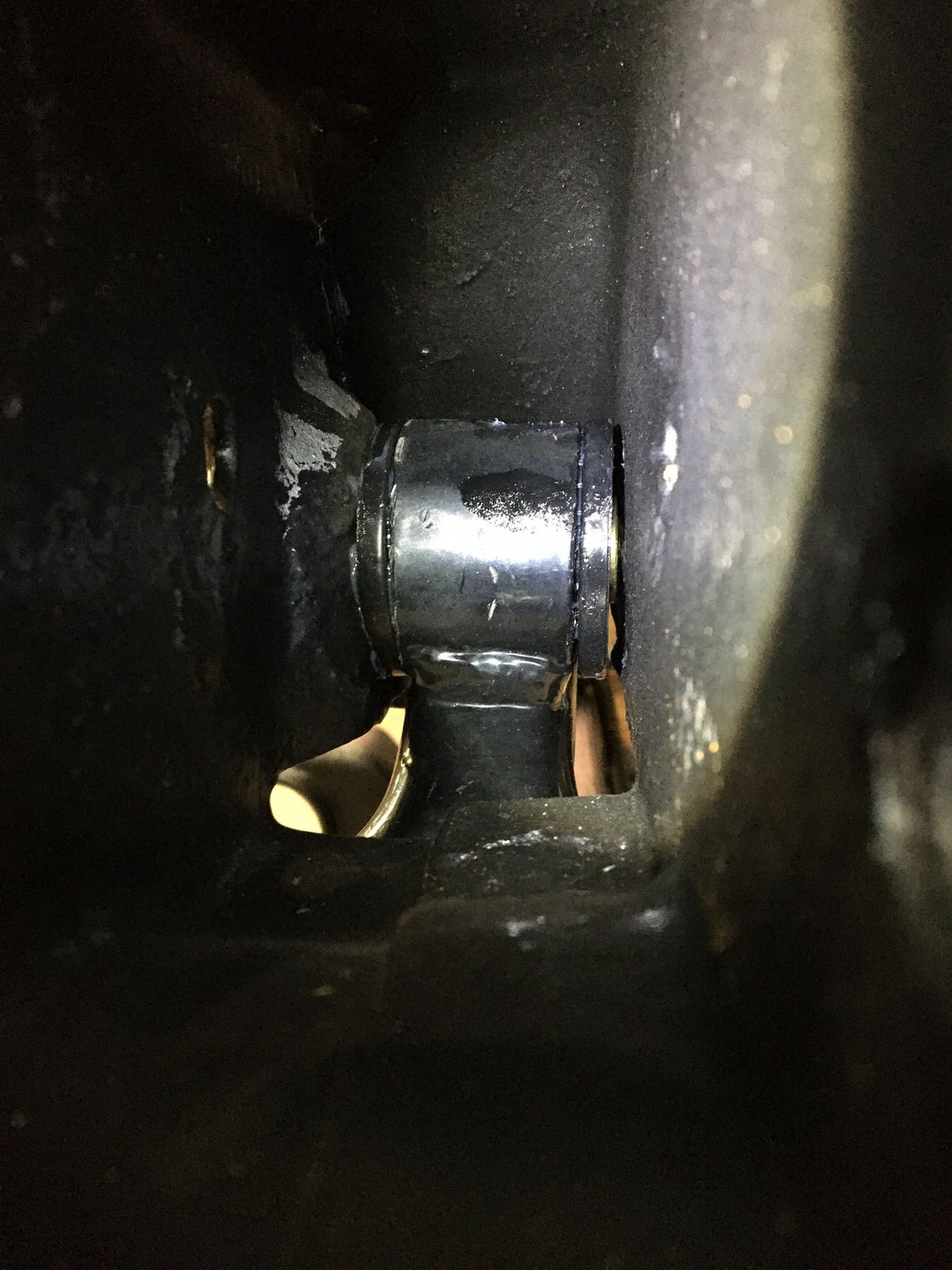

Upper shackle bushing. Unfortunately I don’t have a picture handy of the oem rubber. The Poly did not deform. OEM had deformed to the point of shackle and frame hard contact. The oem would not support it at all. It deformed to the point of failure. (If you look close in the two previous pictures, you can actually discern that deflection.)
