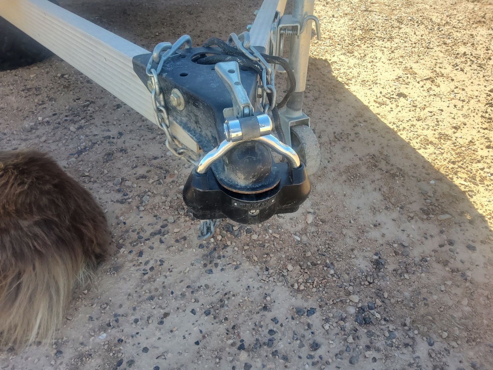

Old Nov 24, 2023 | 05:20 PM
scraprat's Avatar
scraprat
Top Answer: 5
Joined: Jan 2002
Posts: 8,653
Likes: 4,740
From: Itinerant
This is what I was talking about. It won't stop a thief but it might slow them down or move on to the next trailer.
Old Nov 24, 2023 | 11:16 PM
CathedralCub's Avatar
CathedralCub
FTE Community Team
Joined: Jan 2019
Posts: 10,745
Likes: 1,498
Ah I see. Trailer by itself. Yeah that makes sense.
One suggestion: Make sure the safety chain is welded to the tongue, then when the trailer is parked, run the tongue jack all the way down (so that the tongue is way up high). Then lock the safety chain around the crank handle so that even if someone were to tow it, they'd have to deal with the tongue jack dragging on the ground or have a really really high hitch. Another way to make it enough of a spectacle that they just move on.
