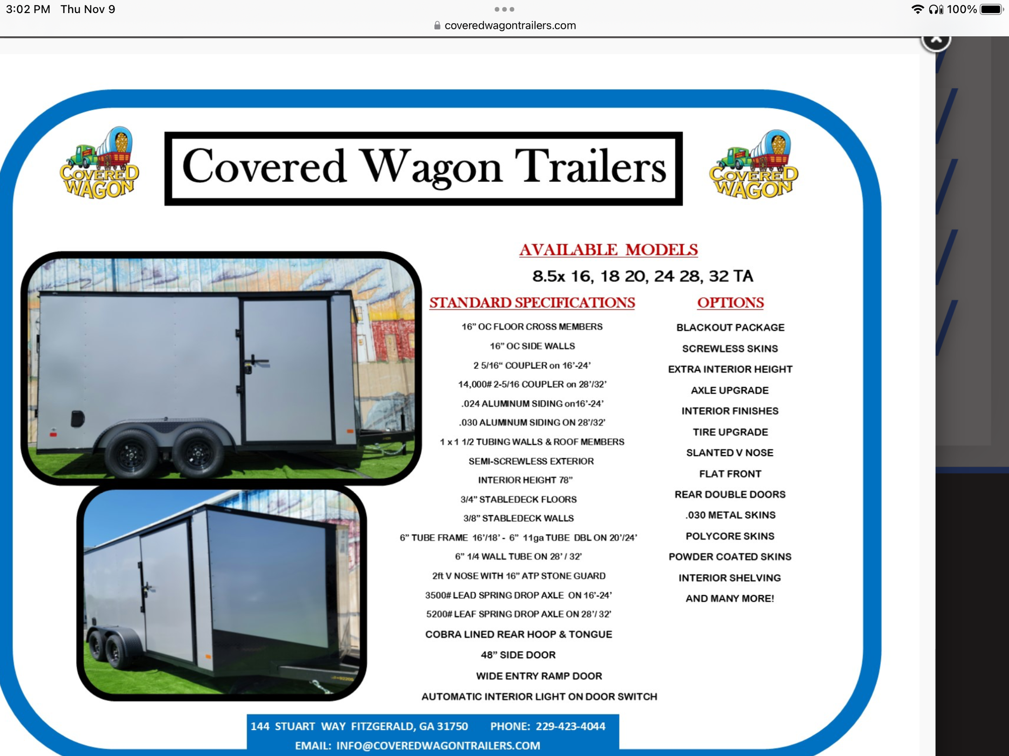

Here are their specs on their enclosed trailers

One thing that looks good is the 1/4” X 6” tubing for the frame in the longer trailers. If that is one piece, not welded in the center over the axles, it should be a good trailer. I have seen broken frames in the situation I described. IDK if it was just a poor weld, or if it was due to excessive speed on the wonderful roads down in the Baja peninsula!! Or a combination of all of the above.
I had a 38’ enclosed gooseneck with triple torsion axles that the frame was one piece 3/16 X 8 and had no trouble with that.
Good luck.

Thanks for the info on the frame. I will check that out when I look at it.

I ended up getting it. The frame was one long piece & painted with with paint that is supposed to resist chipping and rust. The tongue was powder-coated as well as the coupler. All the plywood is treated to repel water & resist rot. The roof is 1 piece aluminum. The split axel tows nice. There were a lot of strong cross winds on the way home & the trailer tracked nice behind the truck. Looking forward to hauling the car & golf cart down to Florida in this thing. Thanks for the tips on what to look for,
