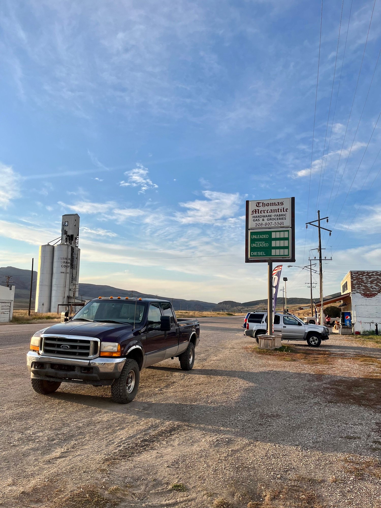

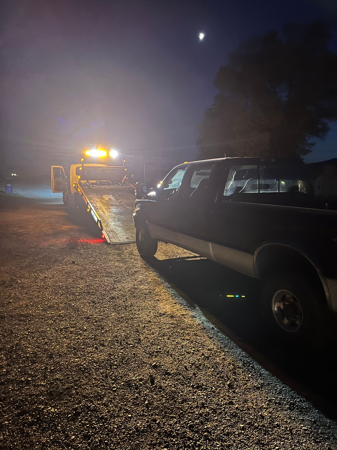

Hey fellas, can you talk to me about the NP271F transfer cases? I have/had one behind my ZF5 and it nearly left me stranded in the back country of Idaho lol. I coasted for miles down to a little town where I was able to call for a tow. Anyway I think a shift fork(s) is broken? It’s like it’s stuck in neutral and won’t go in any gear.

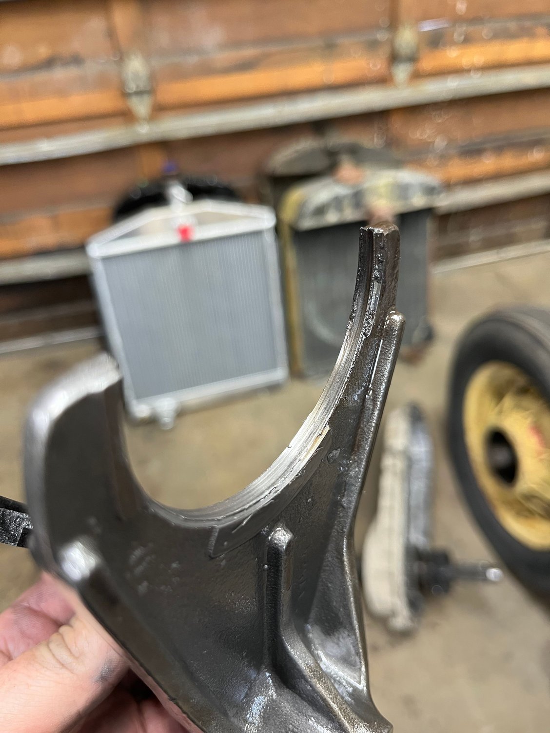

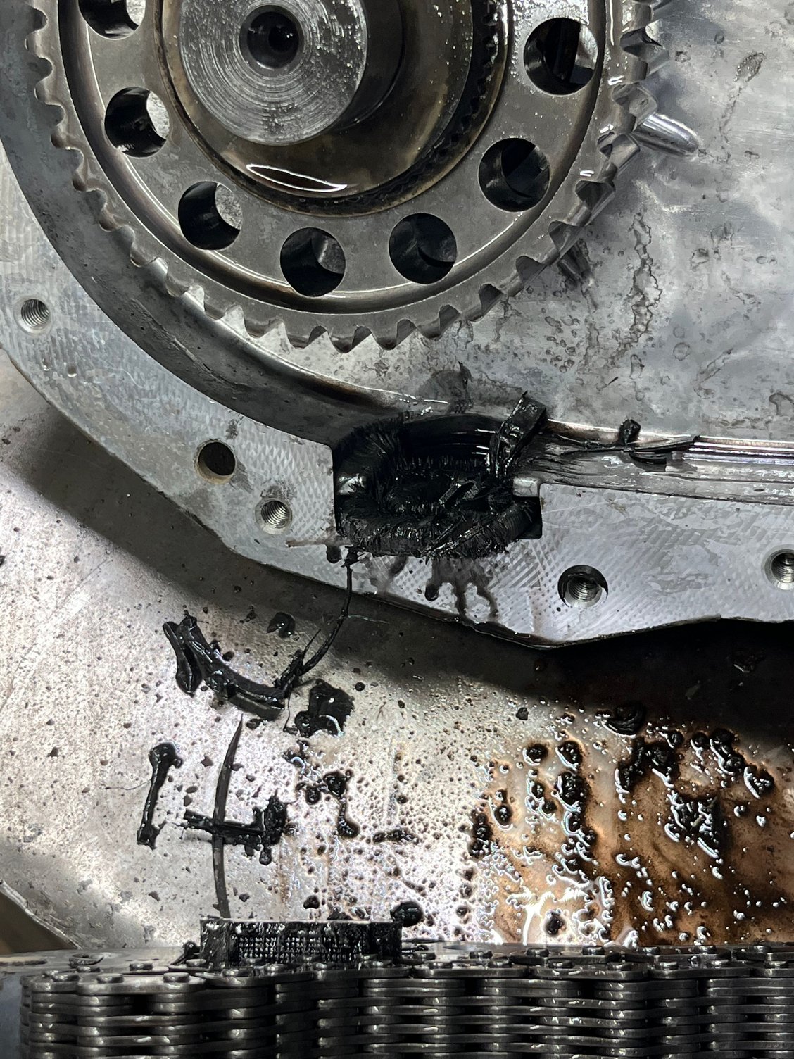

Thanks for the help that makes sense. I took the case apart and it looks like the bushings failed on the range fork which took out the fork. I’m seeing an updated range fork option but not sure what that’s about.

Thanks again for the help! Turns out there’s two NP/NV271F’s. Early and late. I have the early transfer case but it appears and though I have the updated main shaft, slider and fork. Kinda hard to tell as the fork is chewed up pretty bad.
Anyway the range fork gave out and destroyed itself. I gotta say the internals of this case are HUGE I’m surprised I broke one lol!

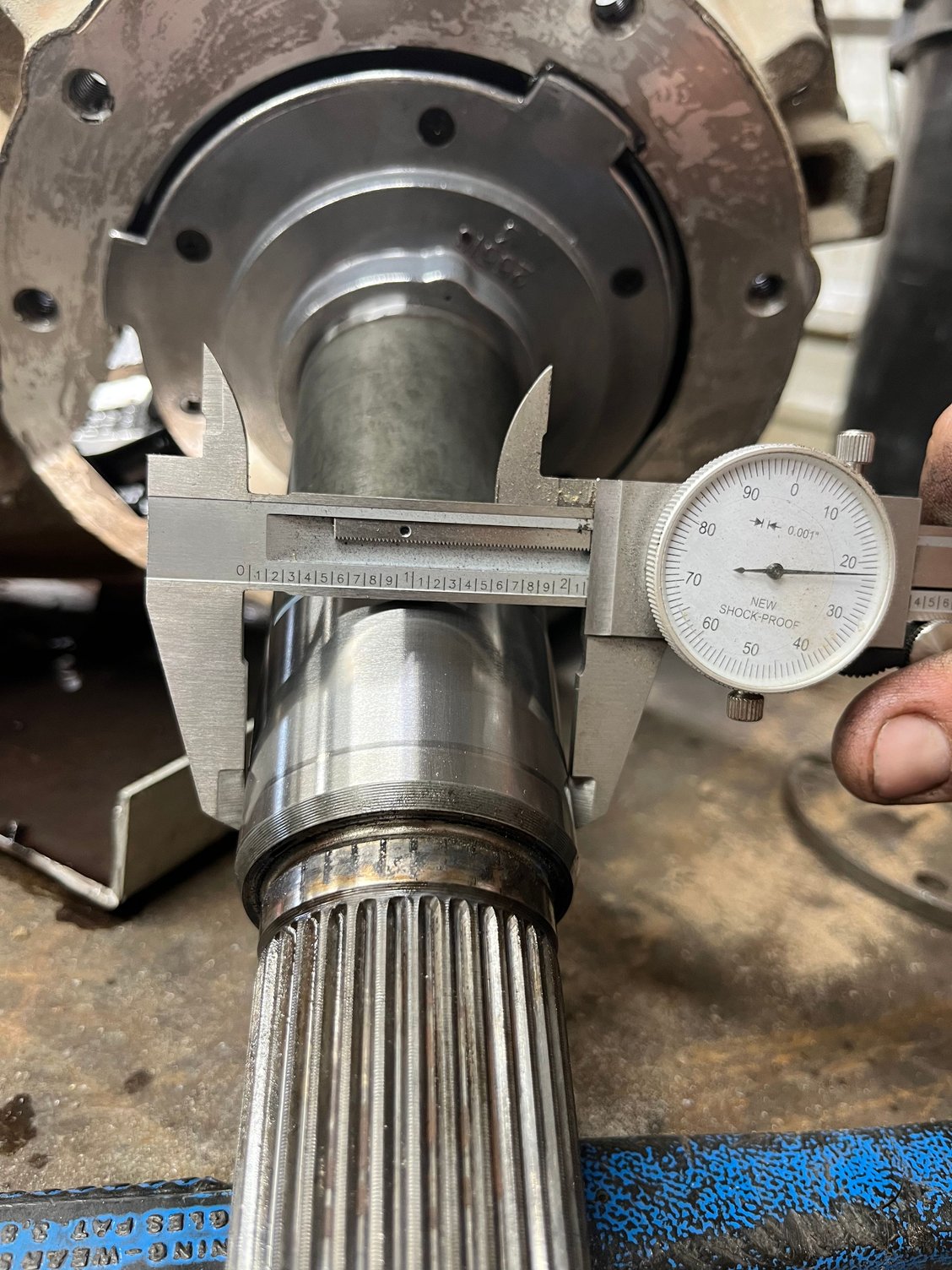

I'm not sure if you have seen the post on my thread, but since you're the only other person to have experienced the all bolts coming out make sure your splines are in good shape in the transmission output and transfer case input. Don't make the same mistake I did and send it for 5k and lose all your splines.

Thanks fellas, my splines look great so I definitely dodged a bullet there.
Makes me wonder how long this thing was working loose and how that contributed to frying my range fork?! Life’s little mysteries I guess haha.
