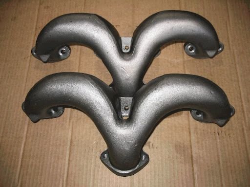

Rams horns from big Lincoln Yblock . The bolt holes at the ends are not in line with rest and
as Kevin said, do not fit the 54-56 Yblocks.
Rams horns with all bolt holes aligned. Originally these were stock on the N-series
cabover trucks
