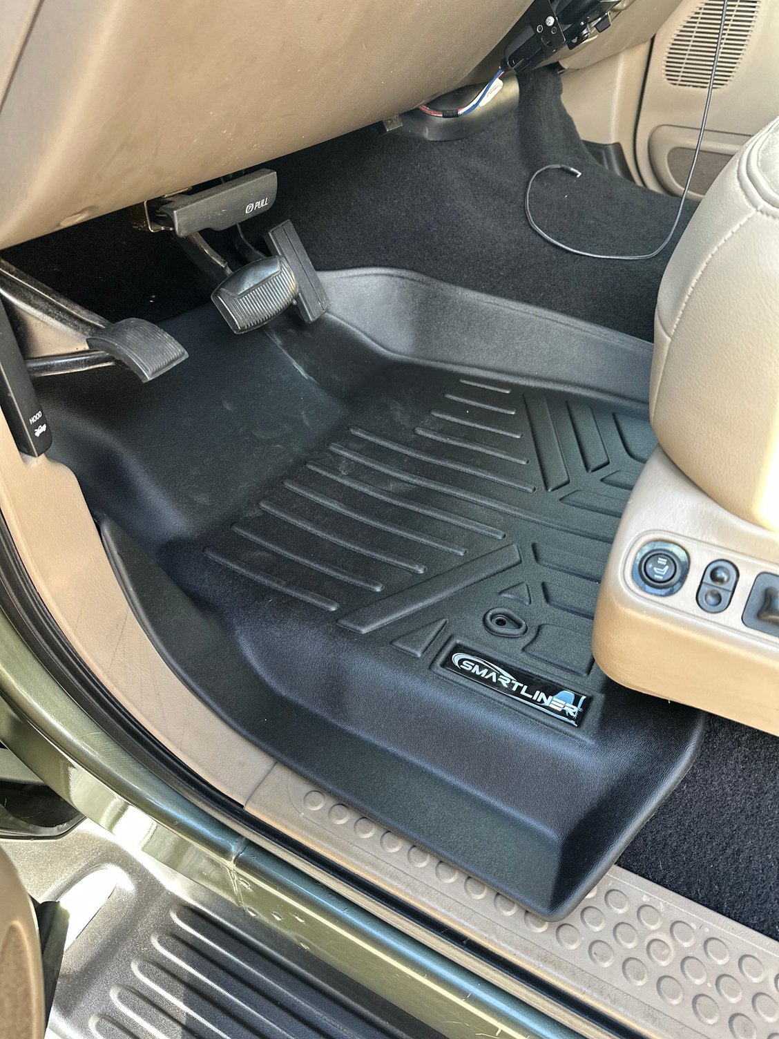

New black carpet installed!
And it looks fantastic! I stressed to the shop that I wanted an OEM fit. The shop said that the padding provided by ACC was falling apart and even though glued, the carpet still moved causing my fitment problems. Regardless of the reason, it’s done, it’s black, and it looks great! The black carpet is a beautiful contrast to the tan interior. I also have a new molded black Dashmat. No glue, no velcro, or attachment. It sits on the contours of the dash beautifully!
I even ordered some new Weathertek knockoffs called Smartliner from Amazon. The were ~$100 compared to the Weathertek at $155. The only difference is the pattern of the inner ridges is different but the shape and fit are identical.
