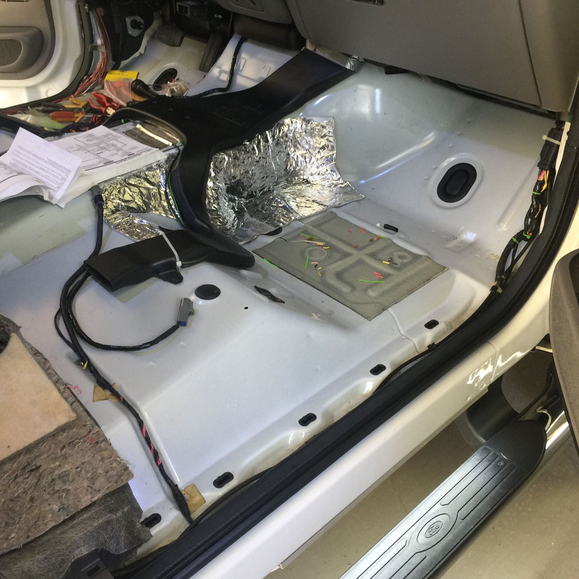

If the carpet was laid too far back, and was molded correctly, than you'll have issues with flatness, and proper contours where the front seats rise. You'll have a continued abnormality elsewhere as the floor pans have many highs and lows. In some cases new after market carpet needs time to remember its molded shape from crunched in a box to in the vehicle. The best way to tell is to remove the front seats, and verify the carpet follows the floor pan contours for the front seats, then see where the carpet falls everywhere else. Pic for reference of the floor pan under the seat.
