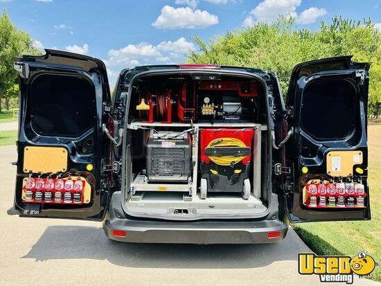

Not our van, Not saying your van went to this extreme, but this is a basic idea of what and how the vans are set up, assuming one has the money to set the van up this way. We've never had a water issue with van *knock on wood*

That's gorgeous. My setup isn't going to be quite as elaborate I don't believe. I have a single 60" long shelf that I'm attaching packout boxes to for most of my tools and supplies, and I plan on maybe getting a slide out box for some misc. tools on the passenger side, and an inverter to run a tool battery charger and probably most importantly, a coffee maker. I think that's probably the most important thing I want to put in this van. LOL. I've watched dozens of videos on van tool load outs, but it's still kind of up in the air still. A lot of the van's I see are bigger than my Connect, so they have more space for shelving/ storage. The problem, is that I can't even get everything set up until I deal with this floor liner issue. Once I get the floor liner issue resolved, then I can put get the shelving in, and then I can start organizing/ figuring out what kind of space I have to work with.
