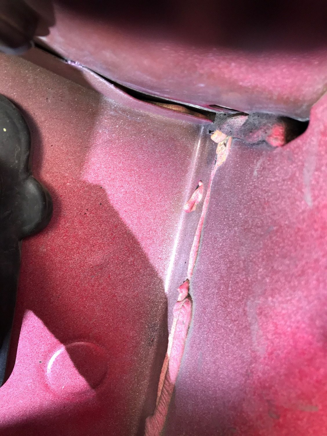

Originally Posted by Robert Luland
Top of the day people. Got a major problem that I hope some one here can help with. I have two 2013 E350 chassis cabs that are leaking water from the wind shield area that has rotted the floor out on the drivers side. A little back ground. Both units came from Supreme Body in PA. There vin numbers end in 02 and 03. So yea they came off the line one after the other. I yanked the wipers and pulled the crowl. Blew out all the dirt and even dumped some water in there which seem to drain away just fine. I don't think the leak is coming from this area. The real shame of this is one van has 28k on it and the other 6k. Help! Thanks in advance, Bob L
My '13 E350 leaked here, i guarantee this is your problem! This is where the firewall, wiper tub, and drivers inner fender all meet up and is poorly sealed/aligned. Take coolant tank loose and moved aside, Stand on stepladder, stick your head in there and this is what you'll see! That round dimple in firewall, lower in photo, watch it from the inside while running water on it outside, down the windshield. Same size hole in black insulation reveals round dimple. You can watch it entering here. Mine was pouring in here, getting under carpet/insulation, never felt wet except at edges depending how van was sitting. I used YamaBond sealant as im a dirtbiker, made by 3M, I believe. Only seal up small horizontal crack at top,not the drain holes! If this isn't your problem, I'll buy the beer!
@Pingpop I am having exactly same issue on the driver side. I used a flexible scope camera and saw that there is a hole behind dashboard. The tried to seal the area you have shown both here and below the cowl seal which stopped it temporarily though it came back , I think the seals were weak. I am in the process of removing dashboard to fix the hole that I see behind the dash which is the cause of water leak. It dripped drop by drop but has caused rusting of the bolt beneath driver side carper.
