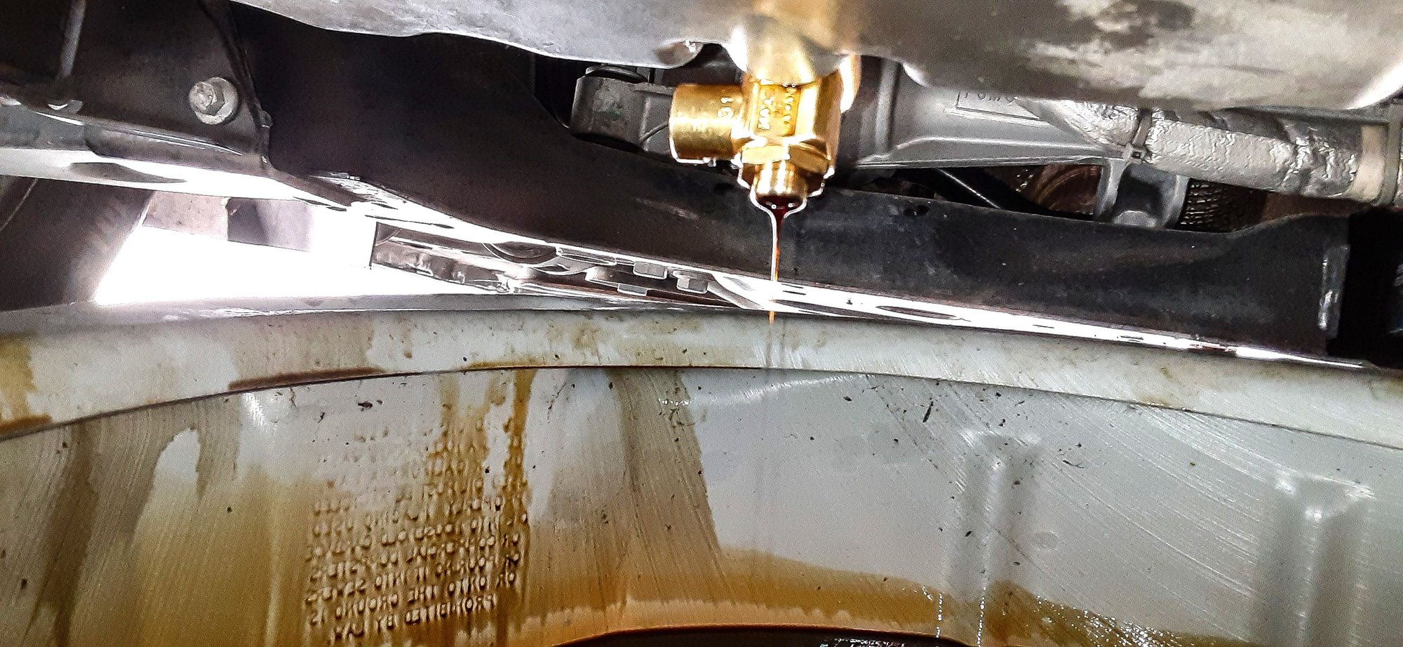

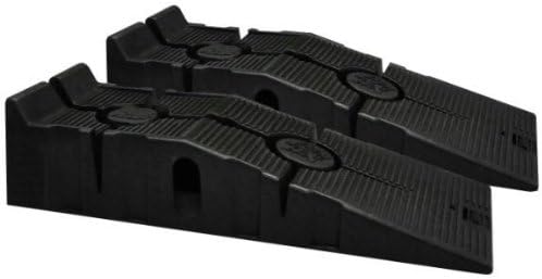

With my Transit Connect, an oil drain valve and FloTool RhinoRamps has made oil changes a lot easier. FYI Motorcraft FL400S filters fit, and work, on a Transit Connect.
Fumoto F107SX M12-1.75 Sx Series Drain Valve
FloTool 11912 RhinoRamps MAX Vehicle Ramps - Set of 2 (16,000 lb. GVW Capacity)
