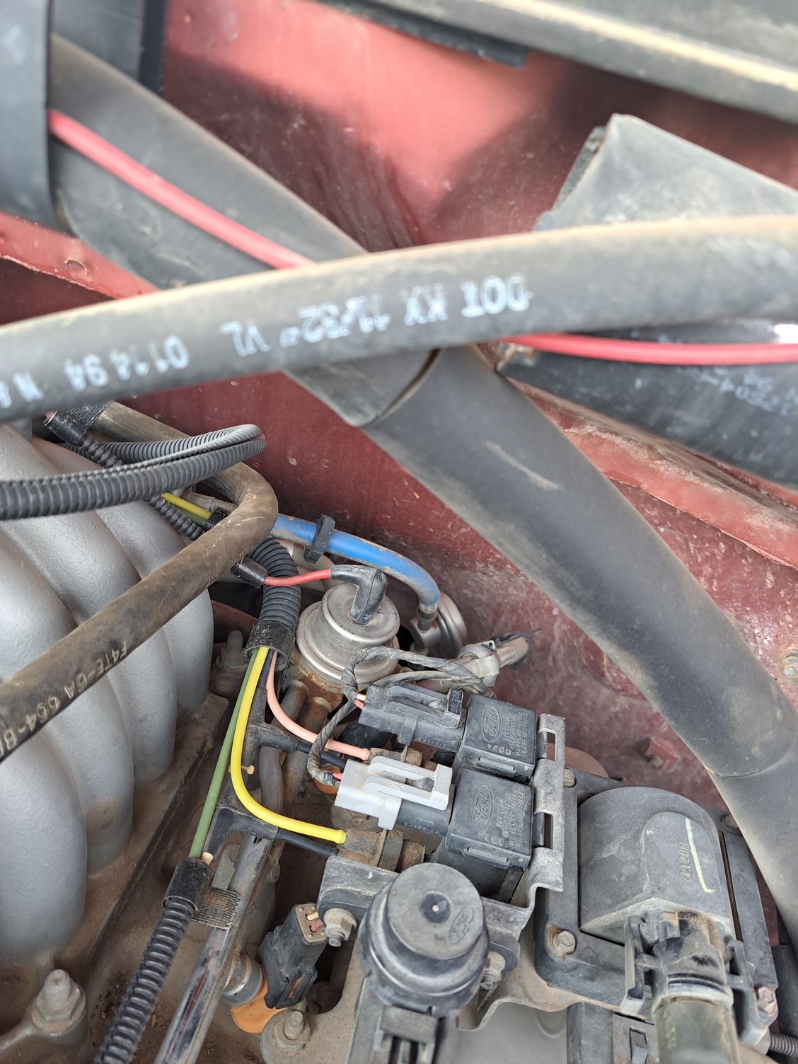

Wondering if the fuel pressure regulator is possibly bad. There is a diaphragm in them but usually when they go bad the diaphragm inside them crack and cause super high fuel pressure. I imagine it could be possible it would cause low fuel pressure but hard to tell for sure.
If you don't know where this is it's that round metal piece with the red vacuum line coming out from the top. Pop that line off that top of that regulator and smell the line. If it smells like fuel it's probably bad. Do check your fuel pressure first though. I wouldn't think it'd be an issue but I wouldn't assume it's not causing issues either.

Replaced fuel pressure regulator im really thinking eec at this point

What was the fuel pressure after replacing the regulator?

Yes it was before and after and new fuel filter I’m about to try a new pressure tester to verify

Verified fuel pressure with different tester but just doesn’t seem right I’m wondering if the valve on the fuel rail is bad how else could I check fuel pressure tap in to fuel line under truck?

Thinking back I had issues with it wanting to hook up. Might look and make sure that adapter is opening the valve and fully threaded on. Can't remember what I did to mine to make it work but it was something not hooking up right.
