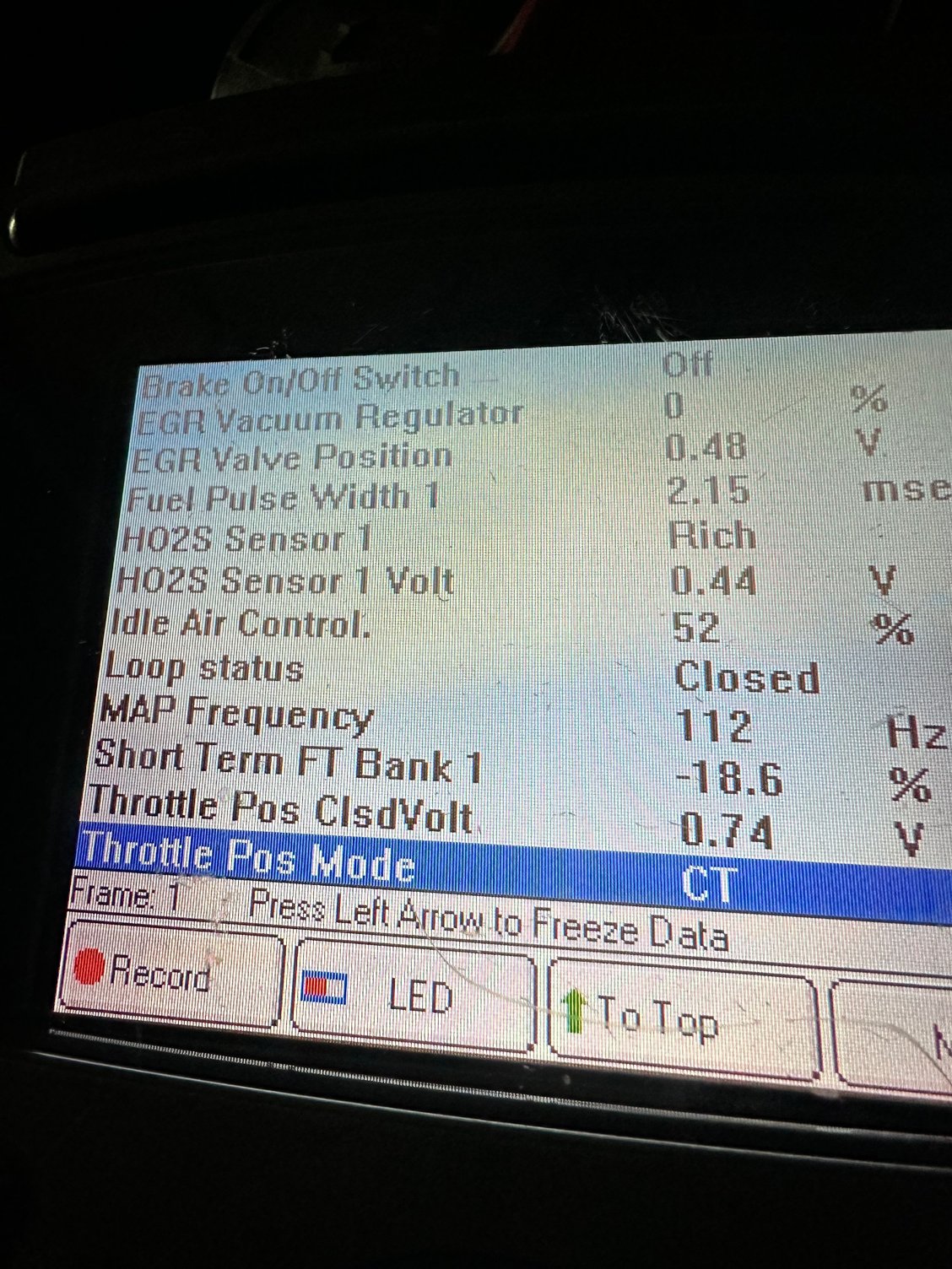

Ok guys pulling my hair out will try to include everything been working on my sons first truck last few months truck needed lots of work and have thrown lots of parts at it I’m sure some were needed anyways so here is the following air pump was removed when bought truck have checked and rechecked for vacuum leaks check fuel pressure replaced fpr map sensor o2 sensor ect sensor act sensor new injectors replaced exhaust manifolds removed the o2 harness near battery ohms out ok still running rich removed eec looked inside granted not real sure what to look for but nothing obvious only thing haven’t replaced is the tps also other issue can’t get the truck up to temp wants to stay under 160 on my scan tool and I believe that’s accurate by feeling hoses and using heat gun I’m out of ideas except running compression check or find some one with a breakout box

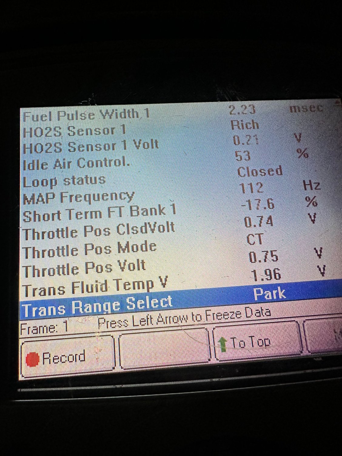

The fuel trim indicates the processor is cutting fuel and trying to maintain 14.7 to 1
I see the front O2 sensor at .44 and .21 (both on the lean side) are they switching?
You may have a drizzling injector (leaking)
I built a injector test apparatus out of an old fuel rail that I pressurize with injector cleaner
I use a trunk switch to momentarily fire the injectors one by one, squirt by squirt
You will be able to see a bad one right away
Check the map sensor vacuum line, (plugged)
Test the hertz coming out of it (to see if it corresponds to your altitude)
Is your fuel pressure regulator leaking?
