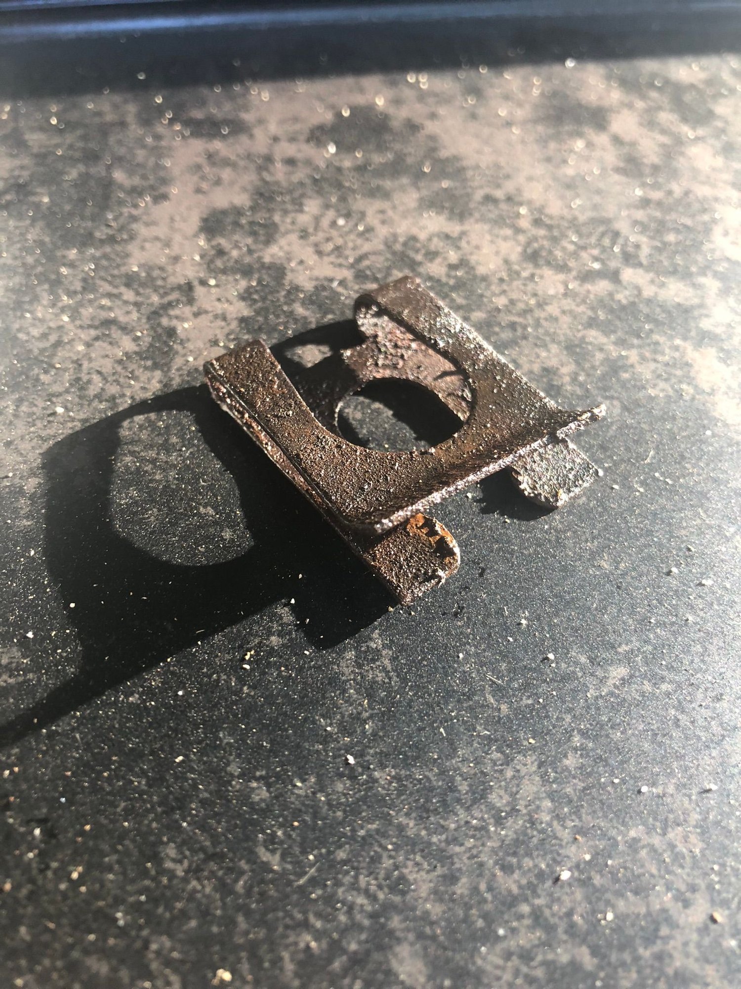

Here’s what the clip looked like
Originally Posted by Skibum49
how do you install the new clip?
I struggled with it too and changed both sides.
