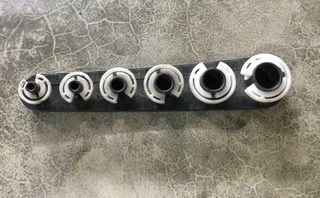

1996 f150 5.0. Yes, I searched. So I've been battling this thing for a couple days, soaked it with pb, brake cleaner, blew the fittings out with air, hosed them down again, pushed the hose into the tool, and it's not budging. I'm thinking of cutting it out and trying to get the stubs out by themselves. There's probably a good chance I'm going to mess up the fittings doing this, can you buy the lines anywhere? I've looked but came up empty, unless I'm just an idiot and using the wrong names. Anyone done it this way successfully? Thanks in advance

Are you using the metal or plastic fuel line release tool? I found the cheap plastic version worked better for me.
I do not think you can find new replacement fuel lines anymore.

I've tried three different ones, this thing just doesn't want to come off. I'm sure I'll get it eventually, I hope

I use the ones from Lisle
Twisting, turning, pushing and pulling is the only way. Whatever you do don’t damage the fuel line. I repaired the nylon hose end on the Bronco II. It took me three kits to get it work. I don’t know if the spring lock type hose repair kits are available.
