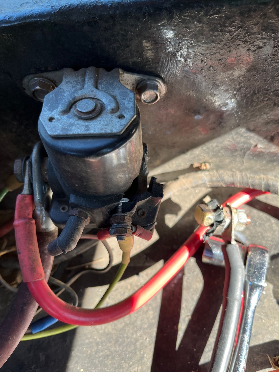

Got to watch that cheat now $27 solenoid as the cheap ones tend to stay engaged when you let the key off and the starter stays engaged, makes a not so good noise LOL.
It is a on going thing in the 80 to 86 truck area and when I had issues with my truck, it would just click once every time you turned the key to start.
I would do that a bunch and it would then turn over and start.
Thinking bad connections I cleaned them all even where the solenoid bolt to the body, it was even worst then
I picked up top of the line solenoid from NAPA think it was $50 IIRC no issues in years.

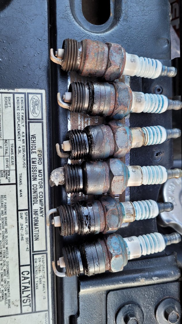

well I am on the right path
#1 thru #6 left to right or top to bottom.
Changed the plugs, first 3 did not look bad and was thinking this is not it then got to #4 and WTH!
The motor never showed any signs of a miss up to this bucking but looking at #4 I dont know how that could be?
Took it for a test drive and the bucking is pretty much gone under load (empty but it did buck before the plug change).
Thing is I can feel a miss at steady throttle and trying to speed up in the higher gears, 4th and 4th OD.
I will let the motor cool down some and see if I can swap the plug wires from that plug to another and keep and eye on the 2 plugs to see if they show any signs of an issue.
I will also recheck the cap closer for spark tracing. But it is strange if it was cross firing I am not getting any back firing anywhere as you would think you would?
When I pulled the first plug and saw the greenish color at the top I was like
Then got looking closer and it is blue paint.
I installed them when I first got the truck to fix a miss it had and left them in when I detailed the motor (painted it).
They been in for 8 years, first 4 just to move it in & out of garage when building it.
Then 4 on the road. It is not like I only drive it on slow back roads because when I take it to work it is 70 MPH for 45 min.
Dave ----

Well you definitely are on the right track as that one plug in particular was beat. Now like you said richen it a little and maybe see if that miss goes away.
