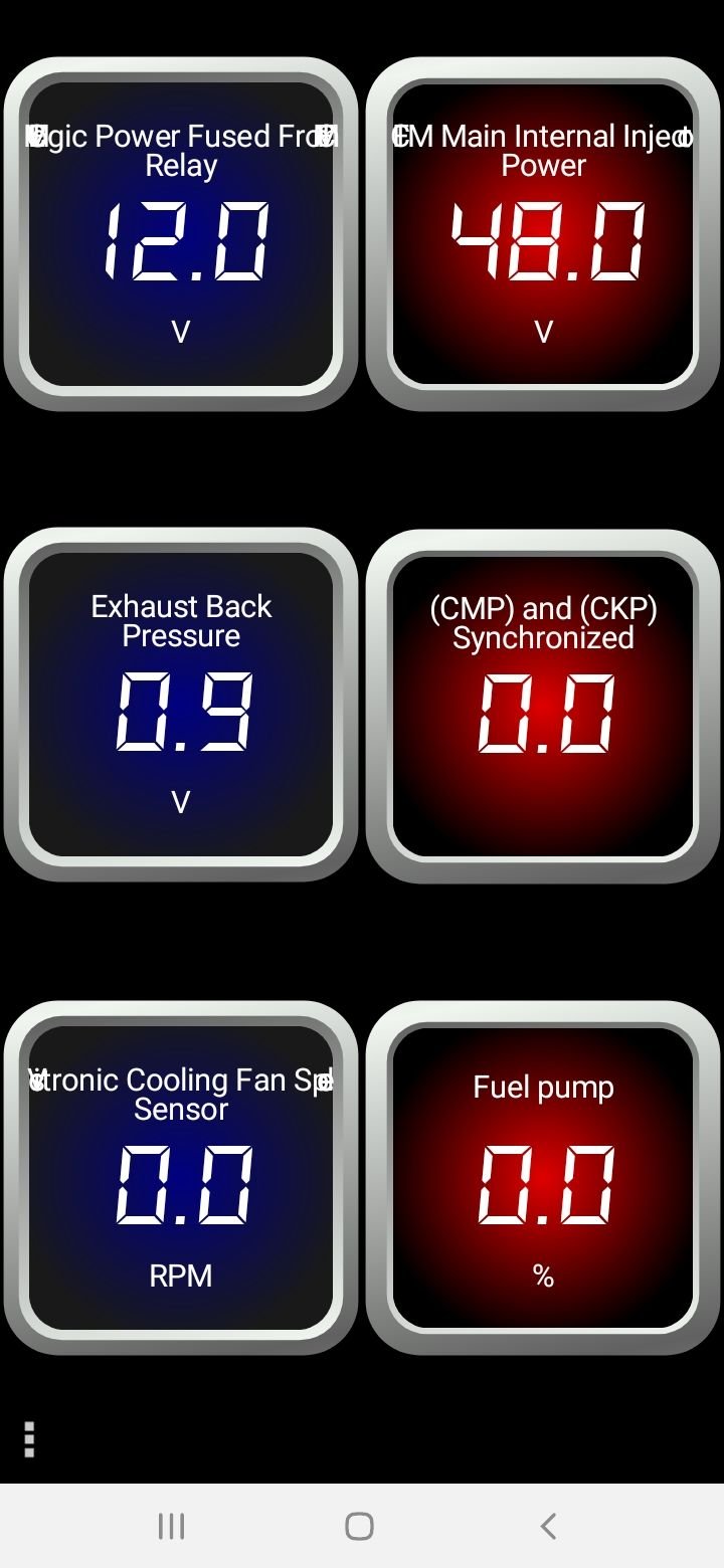

Here is some data from my phone. These images are key on engine not running. I will post more screen shots in a second post to this one. Any ideas guys? Good one I mean, nothing like, it's 46's fault. Thanks, B.

Ok, here are the same screen shots key on engine running. She's not quite at running temp yet so take that into account. Alternator putting out 13.7 volts at idle. Remember, I did quite a few cranking attempts so the batteries are a little low. The batteries, by the way, are only a few months old. Do you think I have an ECM issue? A FICM issue? Or a harness issue? Thanks, B.
