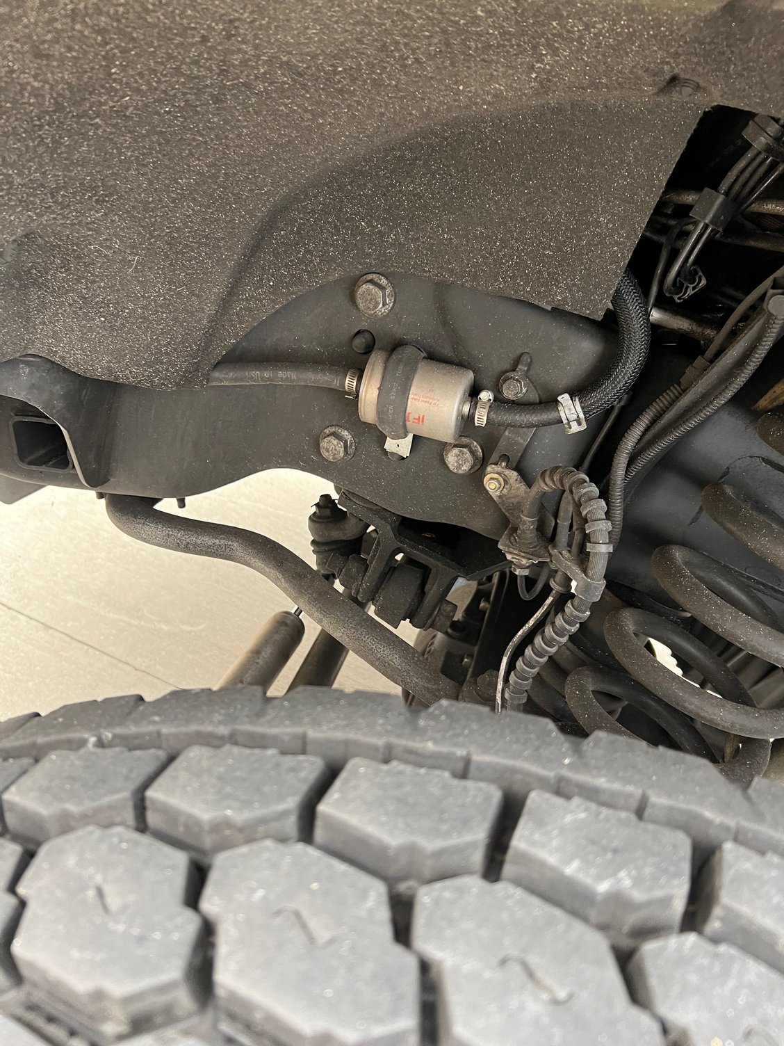

Put a shot glass size filter on the return line to the tank.
Old Sep 28, 2023 | 07:32 AM
speakerfritz's Avatar
speakerfritz
Joined: Jul 2013
Posts: 14,291
Likes: 2,197
Old Sep 28, 2023 | 08:49 AM

Man nice clean mount job!
