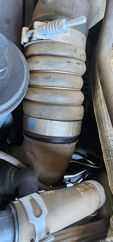

does anyone make an aftermarket cold side cac pipe that is CARB compliant? this 16 work truck I am driving is on it's 3 ford pipe and it almost left me on the side of the road yesterday.

I have only looked at CAC pipes for my '19, not many are CARB compliant. Sinister Diesel comes to mind as being CARB legal for your year.

So because I have a S&B air intake, which has a CARB EO number, I figured I'd look at theirs.
CARB EXEMPT ID D-590-42
STREET LEGAL IN ALL US STATES YES

Rudy's diesel makes a CAC pipe replacement for a good price, and it's metal. Has bung for sensor mounting. Mine has been on the truck for years, and been thru several Commie-fornia emissions checks. I have a 2015

i just ordered the S&B
