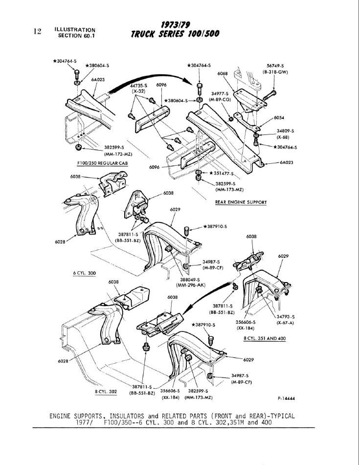

Old Sep 17, 2023 | 04:17 PM
77&79F250's Avatar
77&79F250
Moderator & parts slinger
Posts: 50,189
Likes: 5,793
Old Sep 17, 2023 | 05:06 PM
Branden Heine's Avatar
Branden Heine
Joined: Aug 2019
Posts: 253
thanks for the diagrams, do we know if the 73-79 mounts fit the later 91 460 block?
Old Sep 17, 2023 | 05:13 PM
77&79F250's Avatar
77&79F250
Posts: 50,189
Likes: 5,793
I believe they are all the same bolt pattern, as far as the motor mounts bolting to the block.
