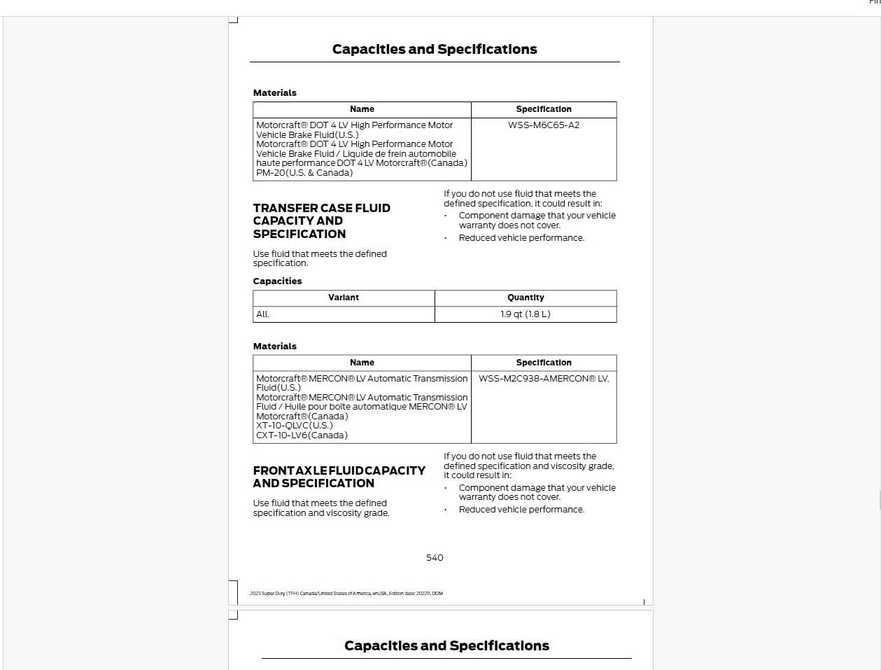

Rear diff, 11.6, appears full. Not easy to check as fill hole is completely covered by rear diff, with very minimal clearance.
TC, is about 1/4-3/8" low. 23 Owners Manual claims this for TC, that correct?

Yes, T-case is about 2 quarts. Fill until it runs out of the fill hole.

Checked my 2023 today. Rear Sterling 11.6 was a few ounces low. Transfer case was several ounces low, very poor on Ford's part. Front D60 was actually over-filled from factory, gear oil came running out pretty quickly when the fill plug was pulled. Now to come up with a way to check the 10R140 transmission at some point. Based off of Ford's track record on nothing else being correct, I wouldn't assume the 10R140 is correct from the factory either. Oh, and my 2023 was missing a hose strap for the lower front radiator hose from the factory also....still waiting on that part to come in.
