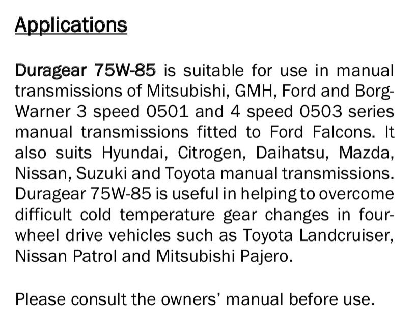

Not to dwell on it, but I got curious when I saw 75w85. I owned a lot of cars and trucks, and don’t think. I’ve ever seen that spec. So I did some digging…looks like it mainly a manual transmission fluid? Source

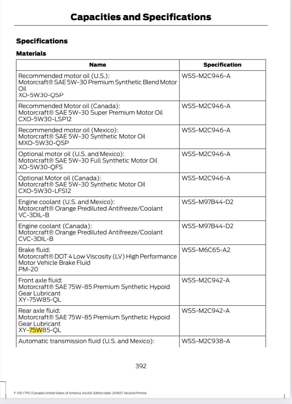

Page 401 of the owners manual states 75W-85 Syn Hypoid lube only. Unless you have a limited slip diff which also requires the friction modifier additive.
Whoa…I should have checked the manual. Yep, you’re exactly right. 75w85 is specified for the rear axle.
