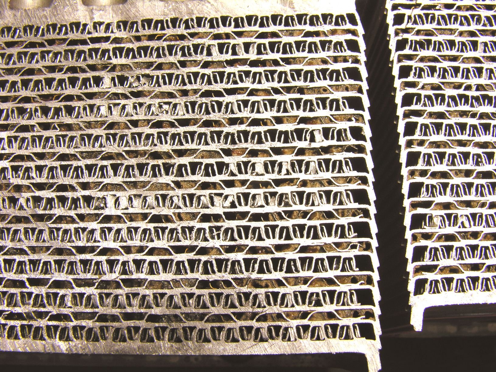

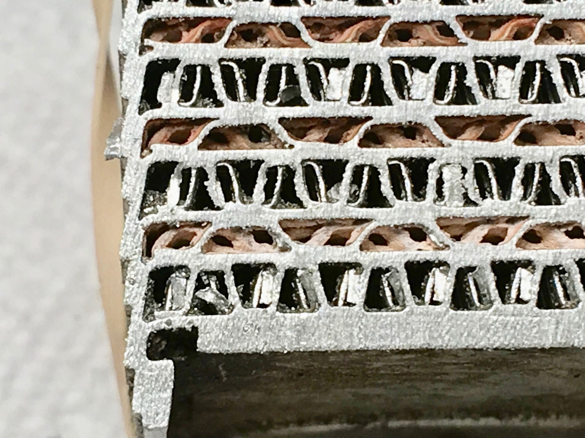

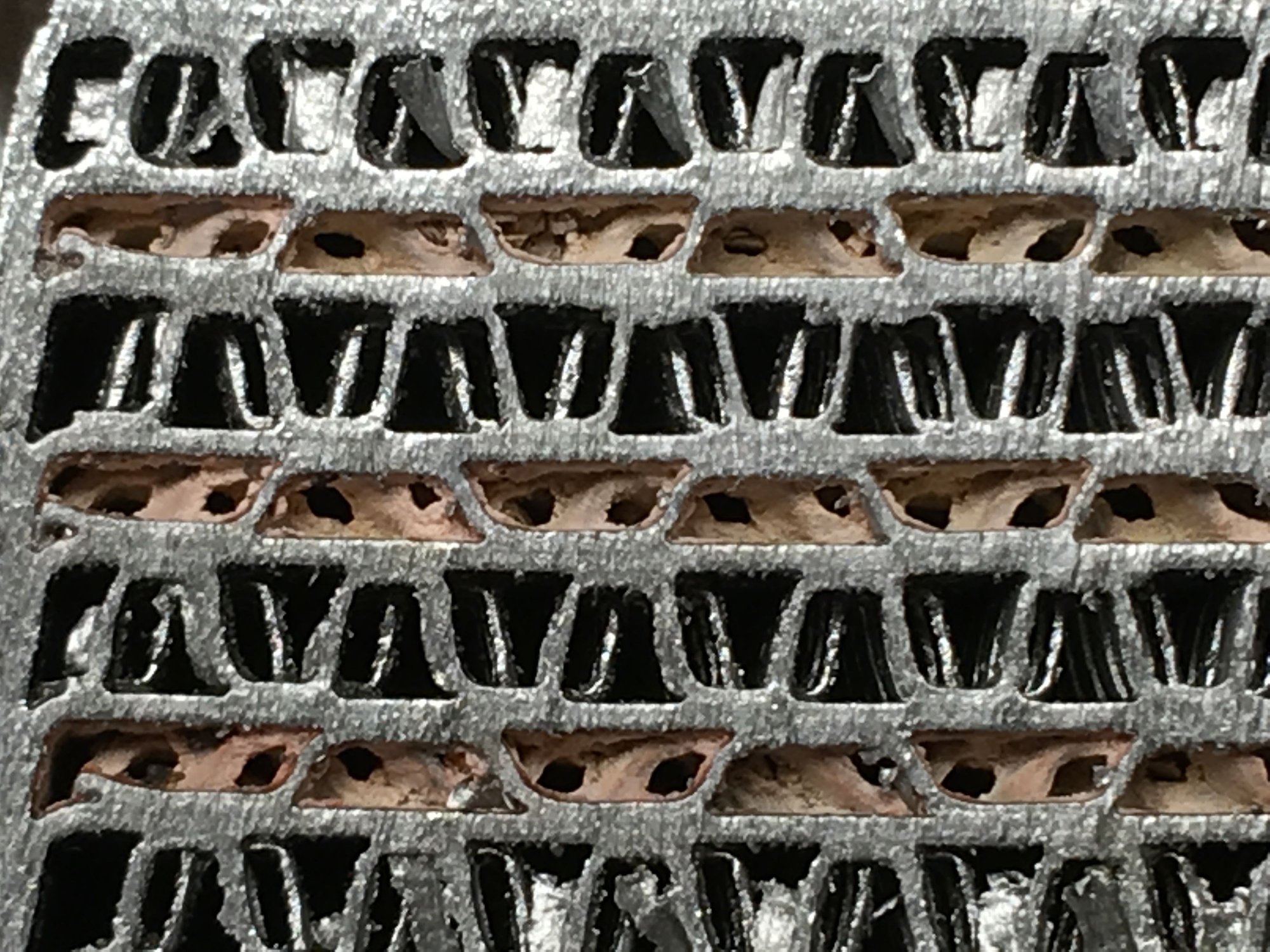

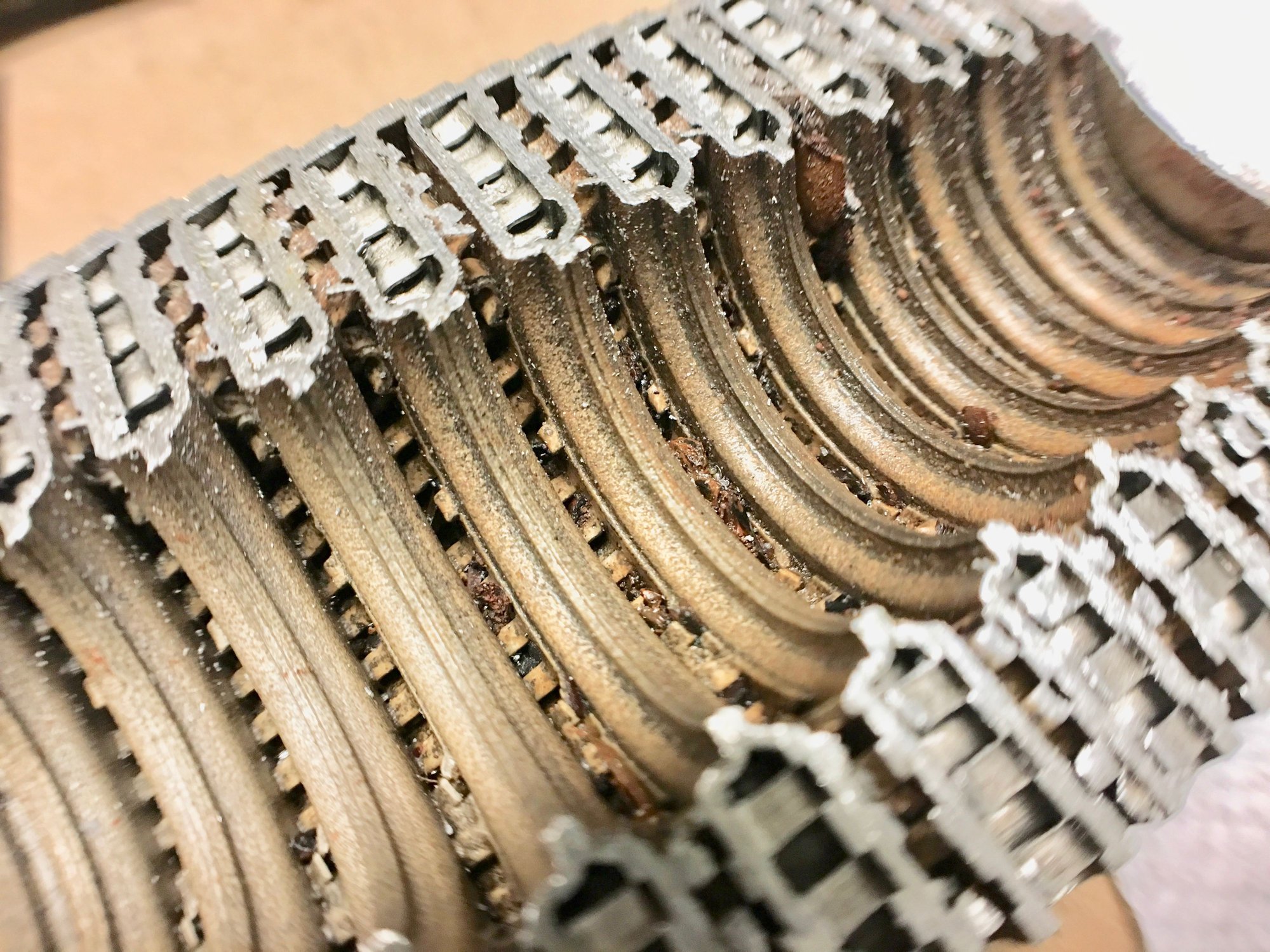

Karl's clogged oil cooler; not flushed.
The scrapings.
My highly flushed cooler.

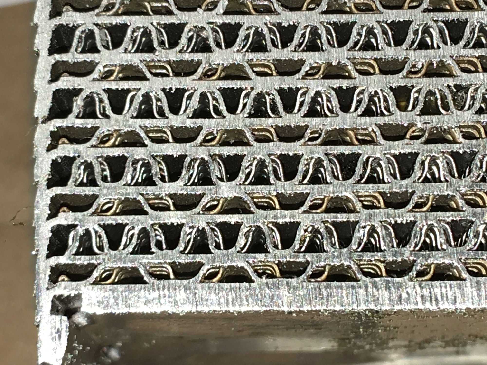

75,000 miles of Rotella ELC.

Jack, in looking at our last set of pictures with 75k of Rotella, back flushing on a cooler that has only seen Rotella might work really well.

Absolutely! I wish I had tried that, but I was in full forensics mode. All of the clogging was at the intake port, probably from whatever the Ford engine rebuilder put into the cooling system to prevent rusting in storage, with some rust.

Jack, awesome information thank you for compiling it. I never noticed all of the offsets plates International put into the cooler to improve the surface area/turbulence. Glad to see the fine results with ELC!
Have you cut apart any of the aftermarket coolers yet to see construction, flow paths, etc?
