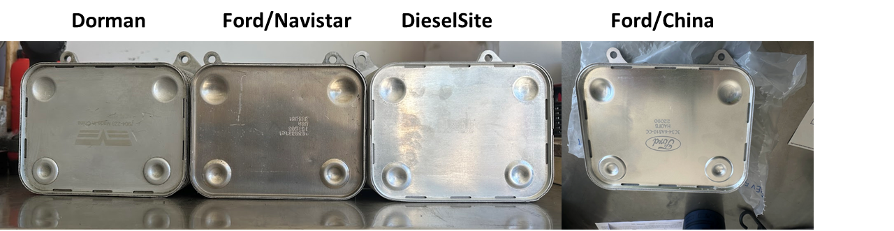

Since I've had access to a few different oil coolers lately, I decided to take some comparison shots. Maybe this will help a little bit.
Background:
Dorman- Used, came out of an excursion with 170k miles, I don't know when it was replaced. Seals looked pretty bad and I had to hammer it out of the cover and damage the cooler to get it out.
Ford/Navistar- Used, Purchased from a dealer a few years ago, worked well... until my engine siezed. Unrelated.
DieselSite- New, purchased a month ago when I got the ford/china one. I wanted to keep it on the shelf. I ended up putting it in the excursion engine so we'll see how it holds up.
Ford/China- Purchased new from dealer a month or so ago. Installed in my truck, have about 1000miles on it so far, mostly towing my 10k trailer. Issues early on, but that was my fault for not flushing the system properly. After backflush its running pretty decent temps. Not great but decent. Deltas get pretty wild but my EOT stays less than 220 towing 10k flat and less than 230 pulling a grade. I think my radiator has something to do with it too, its a cheap aftermarket one.
My conclusion, I'd rather run a dieselsite cooler than the new ford cooler. Looks better all around, even packaged better. (I am not sponsors by dieselsite, I actually had a negative experience with them recently).
Anyways, on to the photos.
The bottom stamping imprints (donut shape) appear similar between the dorman and ford/china... suspicious.
It's not really legible, but I did go through with red numbers and mark each plate to prove the count. Its hard to count by hand after about 10 plates in they all look the same and I get mixed up. The red numbers prove it though.
Hope this helps anyone trying to decide on a cooler.

I think it was over on the org in a thread about the oil coolers, I said I wouldn't be surprised if Ford were now getting the coolers from Dorman or whomever Dorman gets them from.
I also said that Bob may be repackaging the Ford USA coolers he got from Ford as his own, and when his stock runs out, they may end up being from China. However, there is a difference in the manufacturing process at the bottom between the Ford USA and Dieselsite construction. It looks more like the Ford/China build.

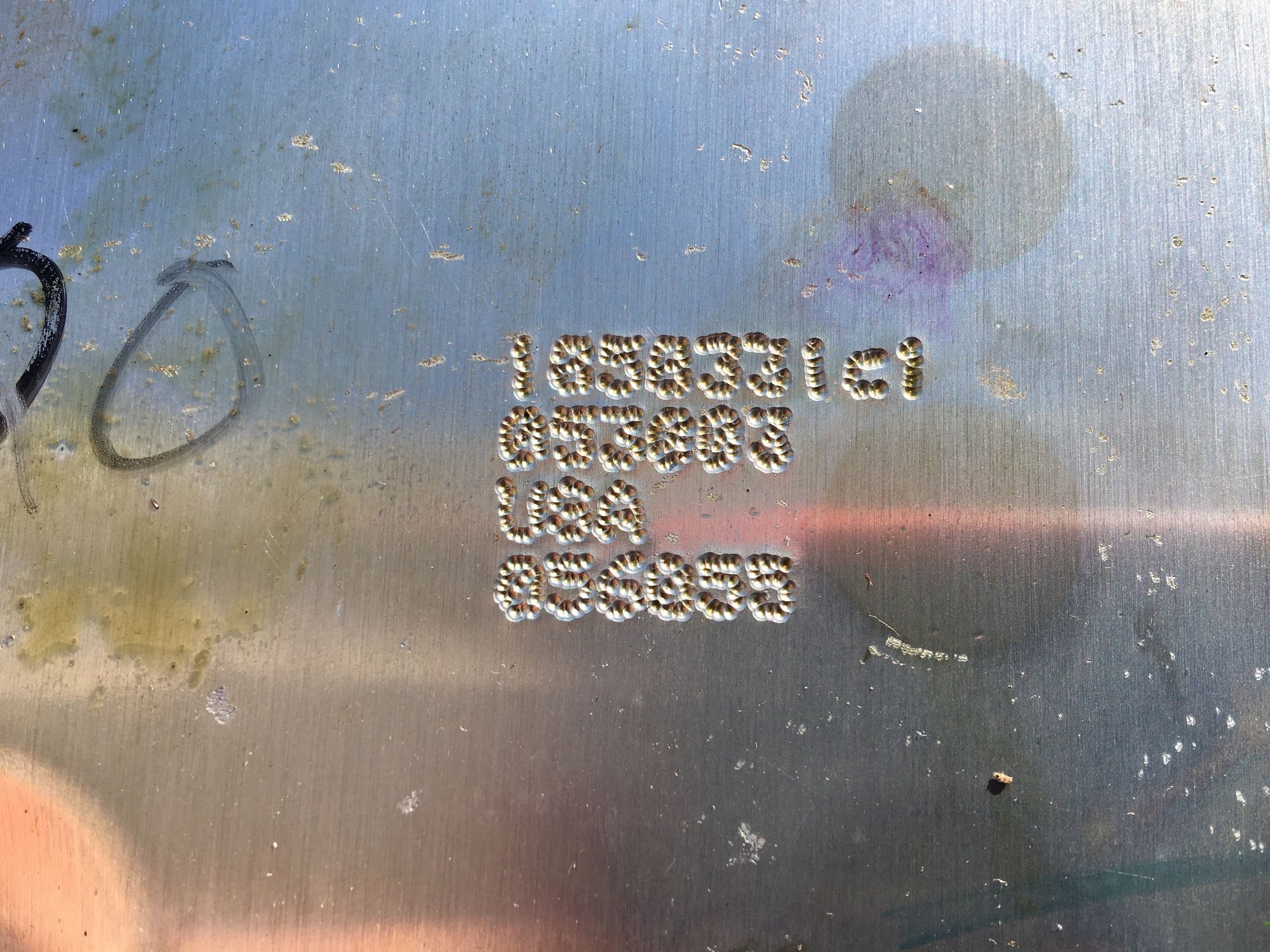

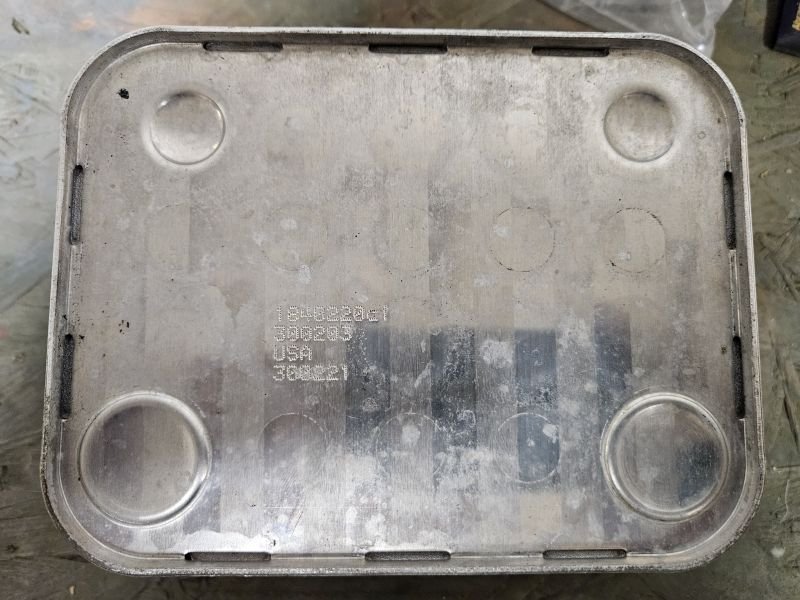

I fired up my older computer, where I have the oil cooler work I did in the past.
These are the two older coolers out of my truck. The image to the left was the cooler from the Ford rebuilt engine installed in 2010. The cooler on the right was the cooler from the original engine in the 2003 truck. Back then, the top plates were dimpled. The Ford/Navistar version in Post 21 does not have the same bottom construction as these, and both are different. I'd have to find these in the shed to pull them out and count the layers, but the early production does not have the added layer.
This is the test I did to check the flow rate between these situations a few years back.
The state of air flow was new, 156 cfm, clogged intake ports only with a 12ºF differential, 112 cfm, and clogged silicate passageways with a 28ºF differential, 20 cfm.

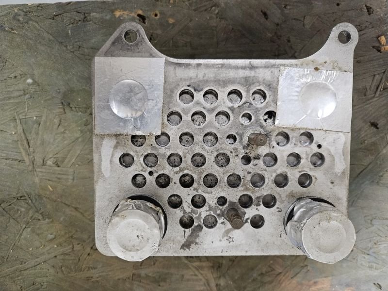

This is my original cooler, truck build date is 11/2002.
