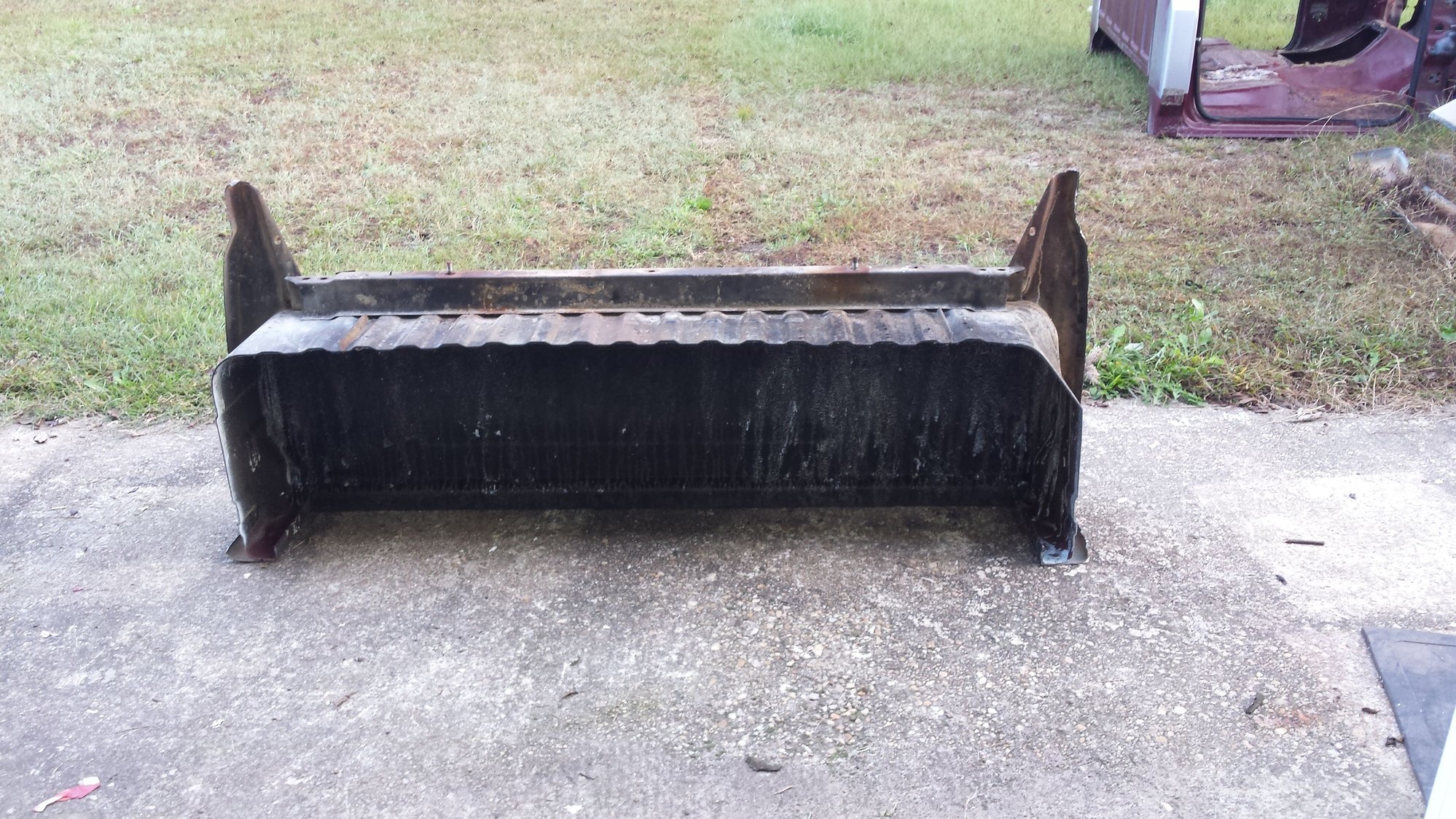

In my case I had to cut the outer and inner bed sides off leaving just the floor.
No one had done this before me so I did a lot of measuring to make sure the bed bolts would line up.
I did have to make the floor shorter and move the front cross brace. You should not if you get the same long bed to long bed or short to short.
I know it sounds like a lot of work and might be best to find a good bed to start with and not wast time or money fixing yours?

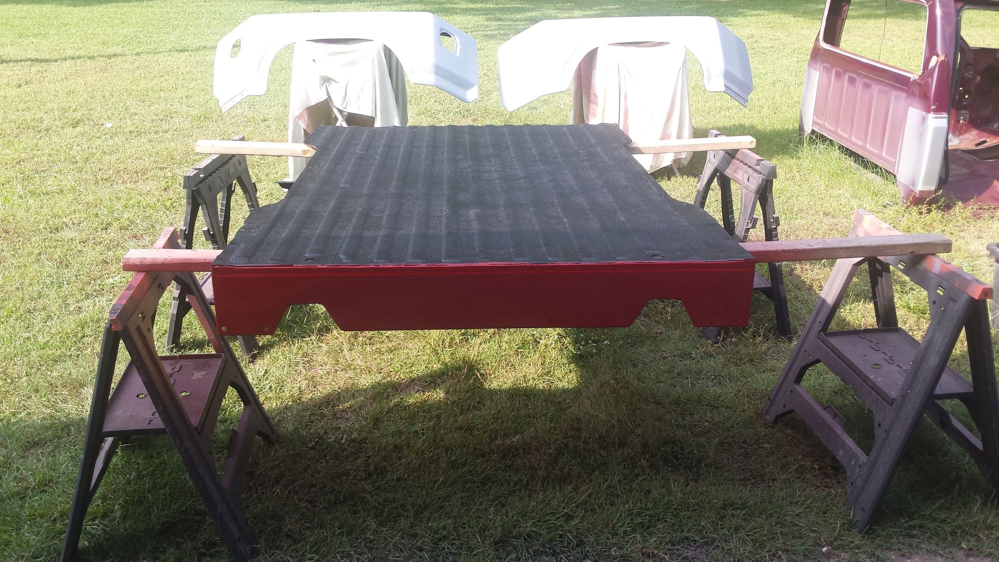

I like doing this type of metal work and I had the long bed with a crashed side and rust on the other but floor good.
Outer bed side cut off a style side long bed. I used a plasma cutter as I was not reusing the sides.
Floor made shorter
Most of the inner wall cut away.
Fitting my flare side bed sides to the floor
A little more work to get it to this point (ok a lot of work LOL)
