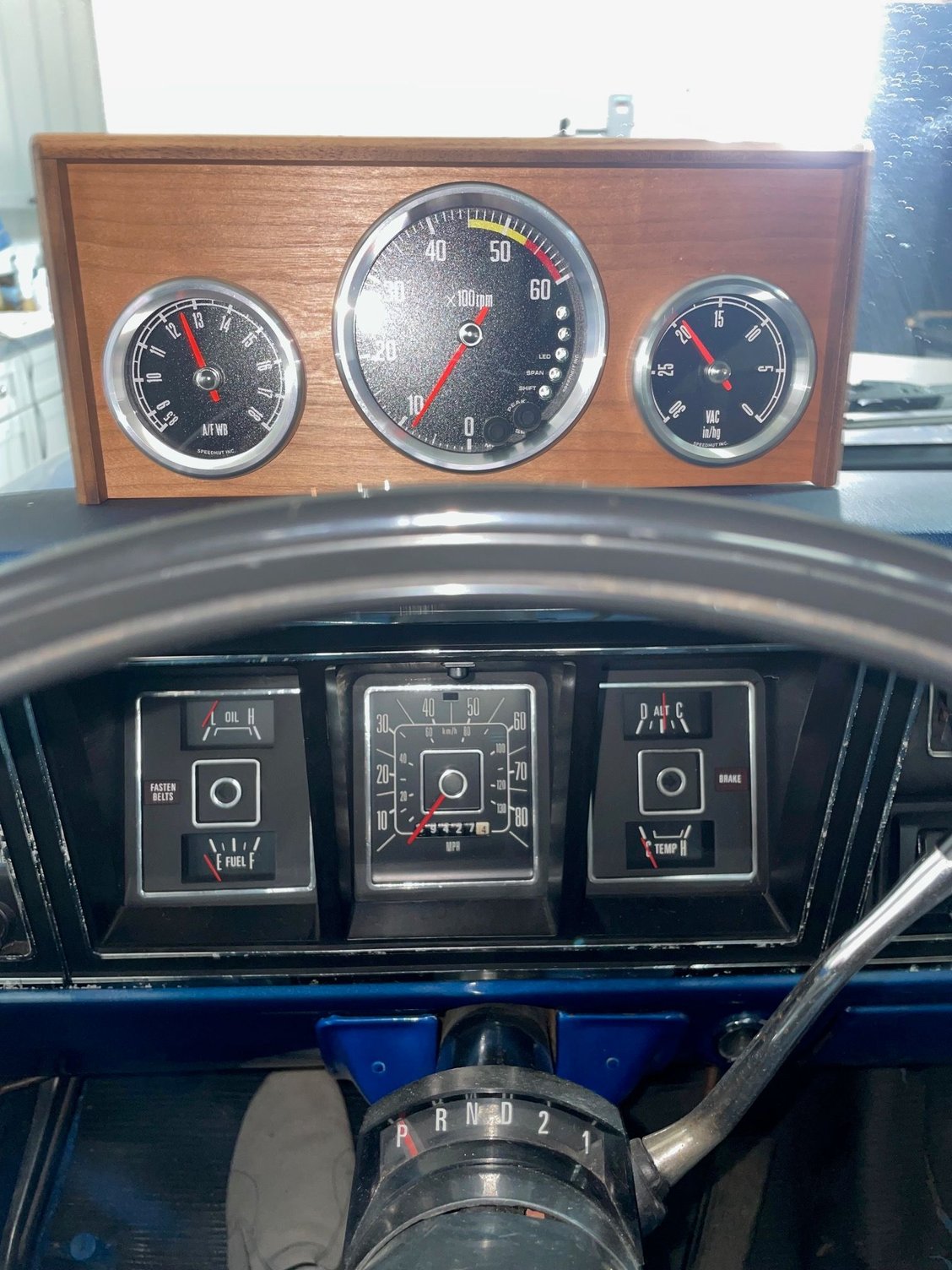

Part 2 is to augment--I added a custom tach and wideband A/FR and vacuum instrumentation, along with a purpose built hardwood "shoe box" to mount it all.
Gauges are from "speedhut"--I paid an extra $75 for them to make the custom tach face with the yellowband and redband, which I got to choose the limits (6k is plenty for me with the big 460).
I found a craftsman woodworker in Ohio that made me the custom enclosure.
Photo taken just after a warm idle shutdown. Note that these gauges "freeze" wherever they were when power is cut.

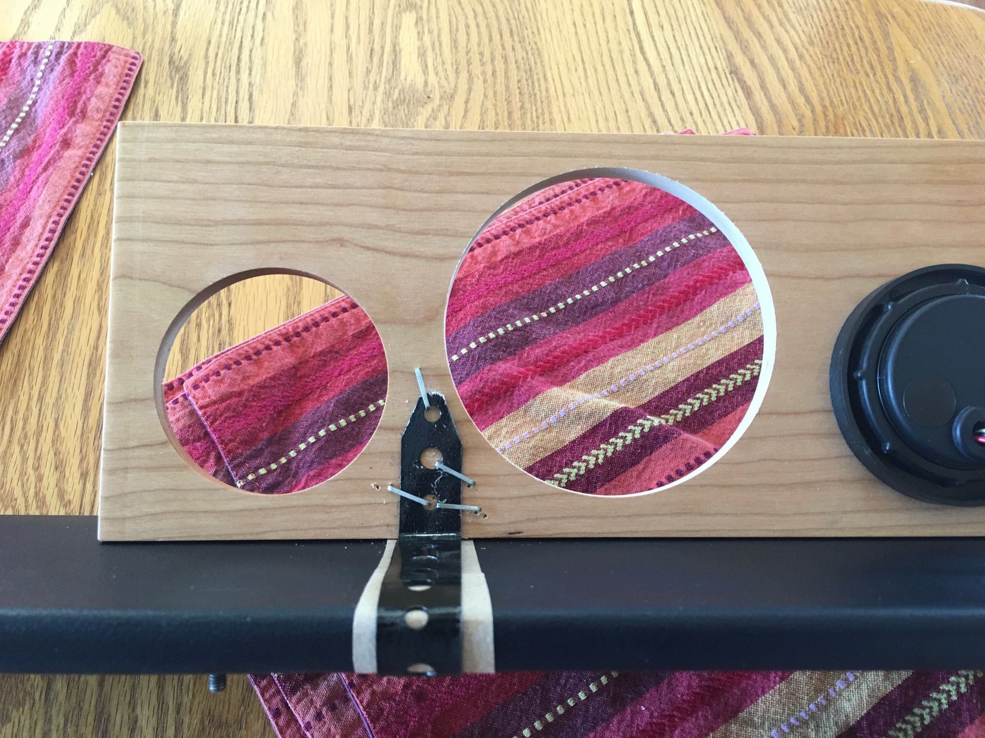

Here's a bit of the voyage along the way:
I never cut into a factory wire harness, and I make it a point to not leave any visible scarring, such that some caretaker 30 years from now could return everything the way it was originally.
Cardboard mockup for the mounting panel
I made a decent mockup, and Michael the carpenter did amazing work!

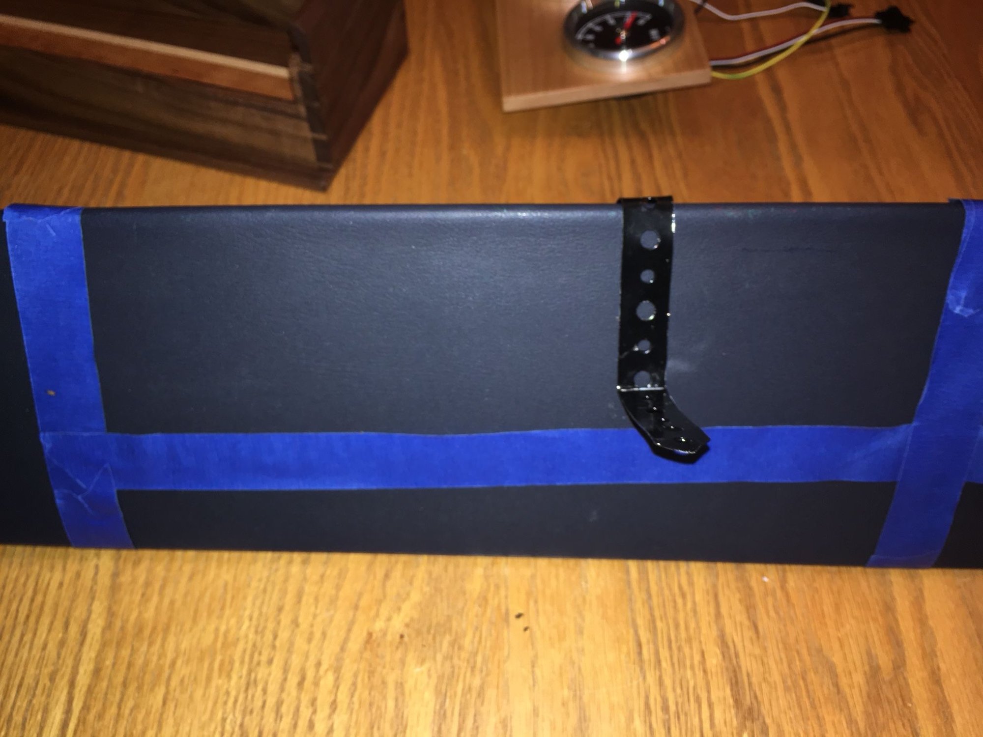

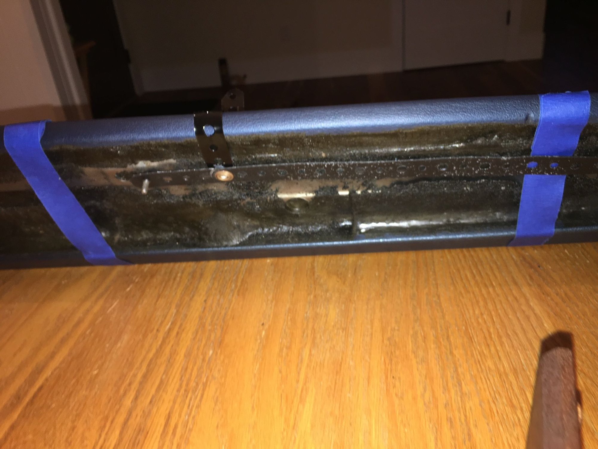

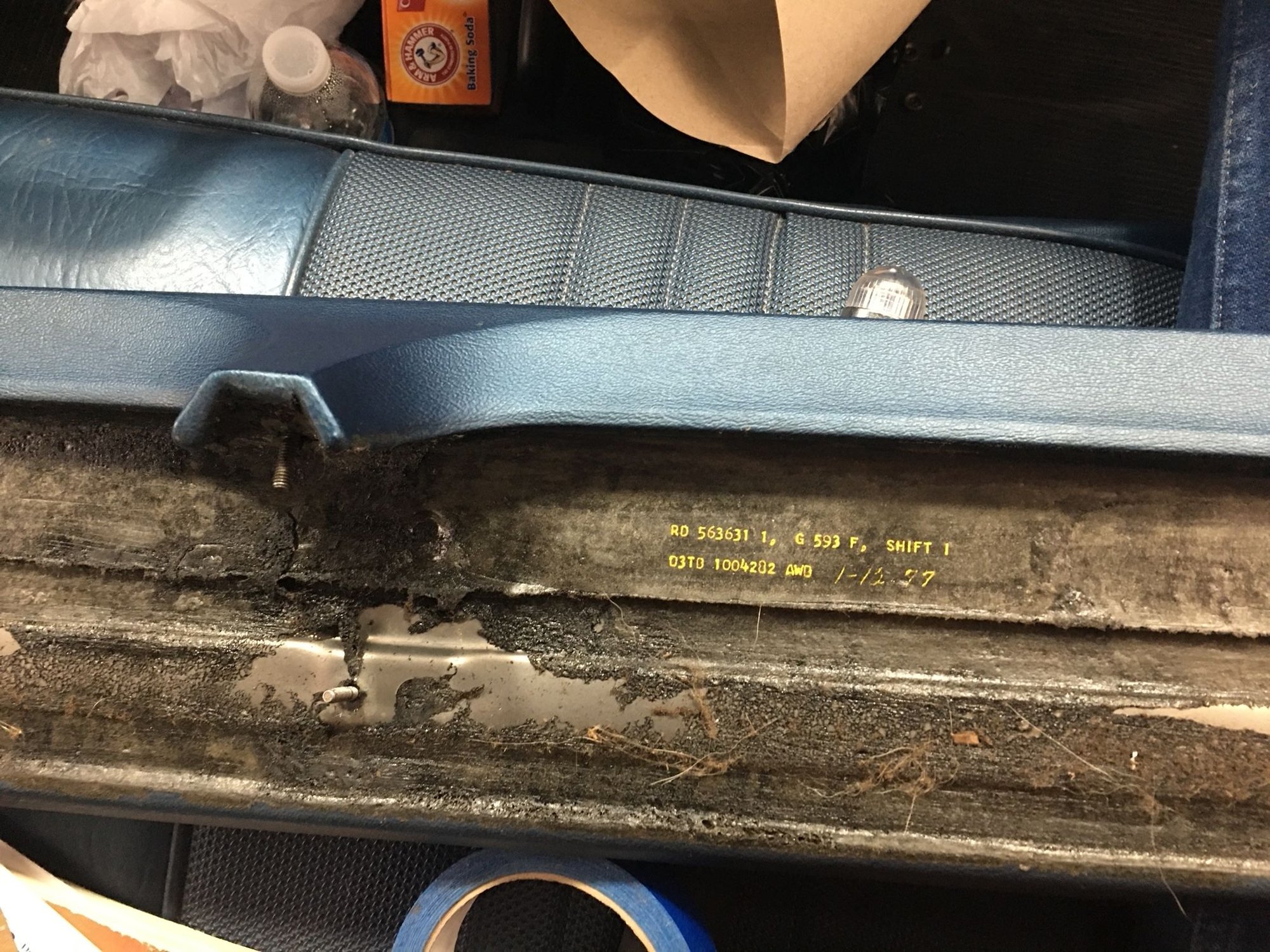

When I pulled the non-cracked (but slightly oxidised) dash pad out...... well lookie there! factory original! And all 10 mounting studs are still in place too.
I used some "plumber's strap" to make a mount that would be secured by the dash pad hold-down studs.
Just about ready for a test fit in the truck...

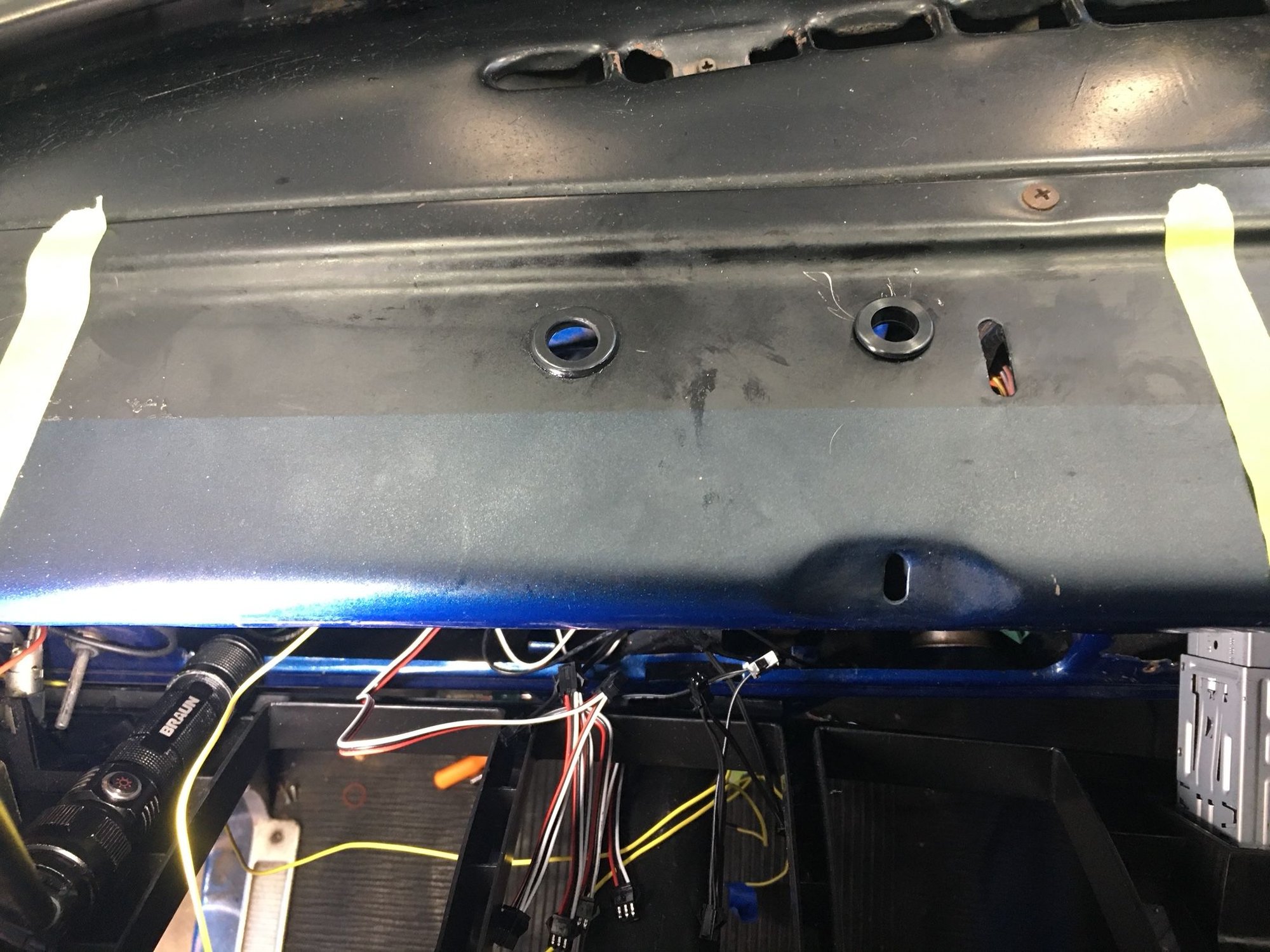

I did have to make two hidden holes with the step drill to pass the wiring down into the cavity.
And of course I tested everything before putting it all back together.

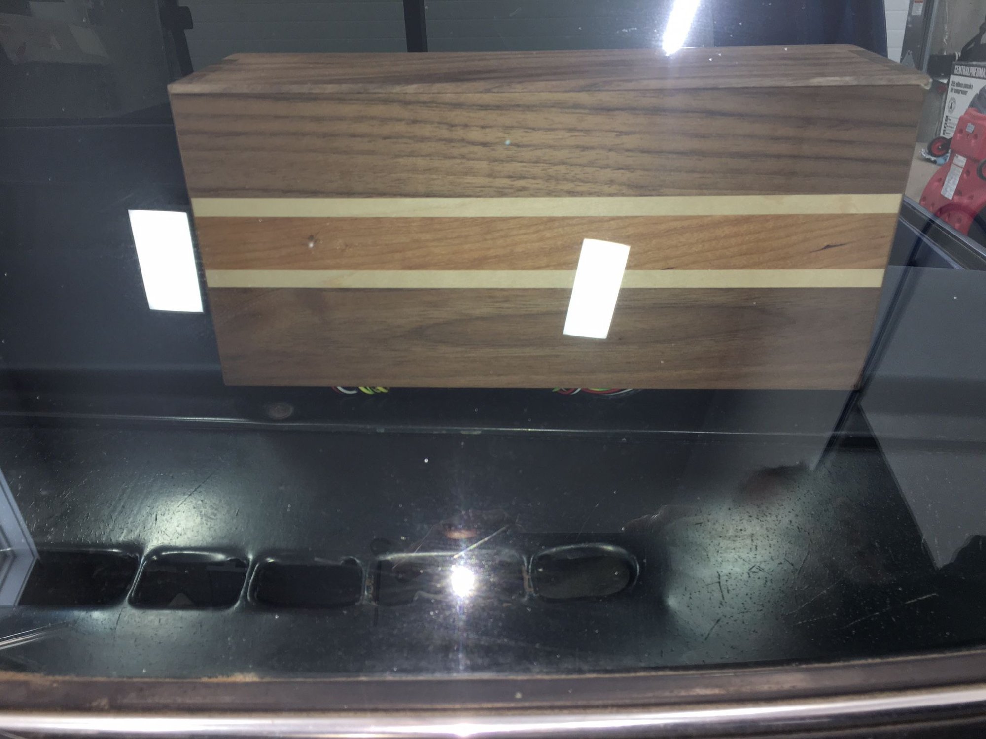

Finished look:
Yeah....the dash pad doesn't sit perfectly flush, but the 'lip' on the box covers most of the wiring.
