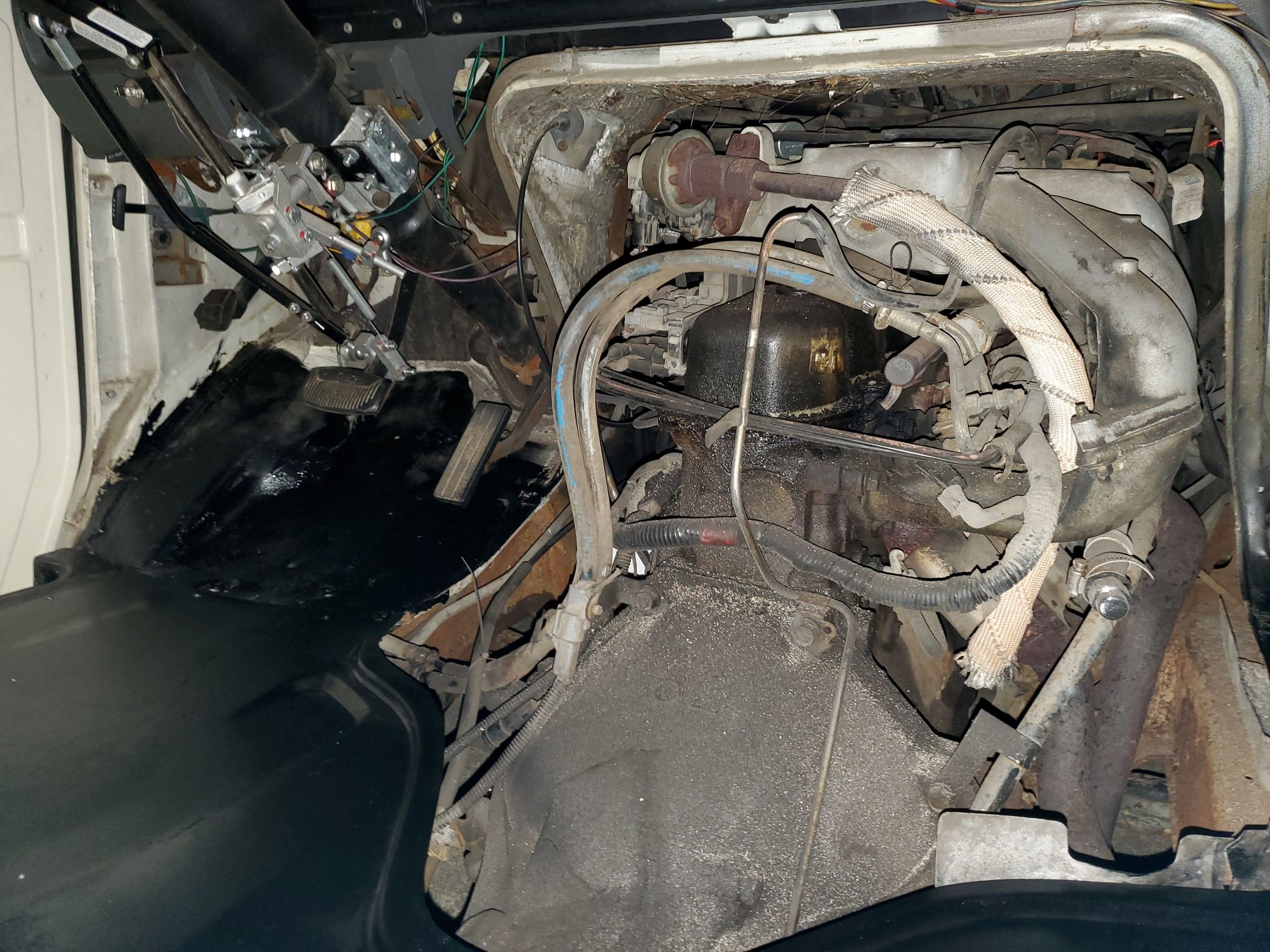

Been tons of fun, radiator broke from its mounts and spewed coolant upon touching, mechanic was getting ready to remove the transmission lines from it to add an external cooler, so radiator upgrade, aluminum built for a big block, relocation of the lower hose was needed to attach it, and moving the AC condenser, a custom scoop to direct air to the transmission cooler was added. Before I could get it back, dead battery, alternator was removed and rebuilt, there were no brushes left inside, completely worn down, when it was reinstalled still no charging, the external voltage regulator had a wire broken off of it, no way this has been charging my entire ownership, months of work and I may be getting it back tomorrow if it doesn't break anything else, practically rebuilding it, need to find a priest to exercise it, I believe it must be cursed. From a corroded ground wire, broken charging wire, burnt up alternator, I don't see how the ECM was getting required current without a drop, add in the hole in the vent above the heater box pretty much drown the ECM every rain storm, enough to completely rust out the floor up front. Well I sold my spare wheelchair, so I hope I got enough cash to square it with my mechanic, he's gone above and beyond on this thing as it just keeps breaking as fast as its assembled.
Ebay now has welded aluminum radiators for the 4.9 again, they had been out for some time, no plastic tank junk, I had been waiting for them to come back in stock, I knew mine was on borrowed time, was stained green all over.
Plug wires were replaced again, a heavier set was used, it has more power than when we got it, but still isn't running completely smooth, I believe fault rely in the ECM as everything else is new and tested out as good now, even got that valve cover leak dealt with, was a mess.
