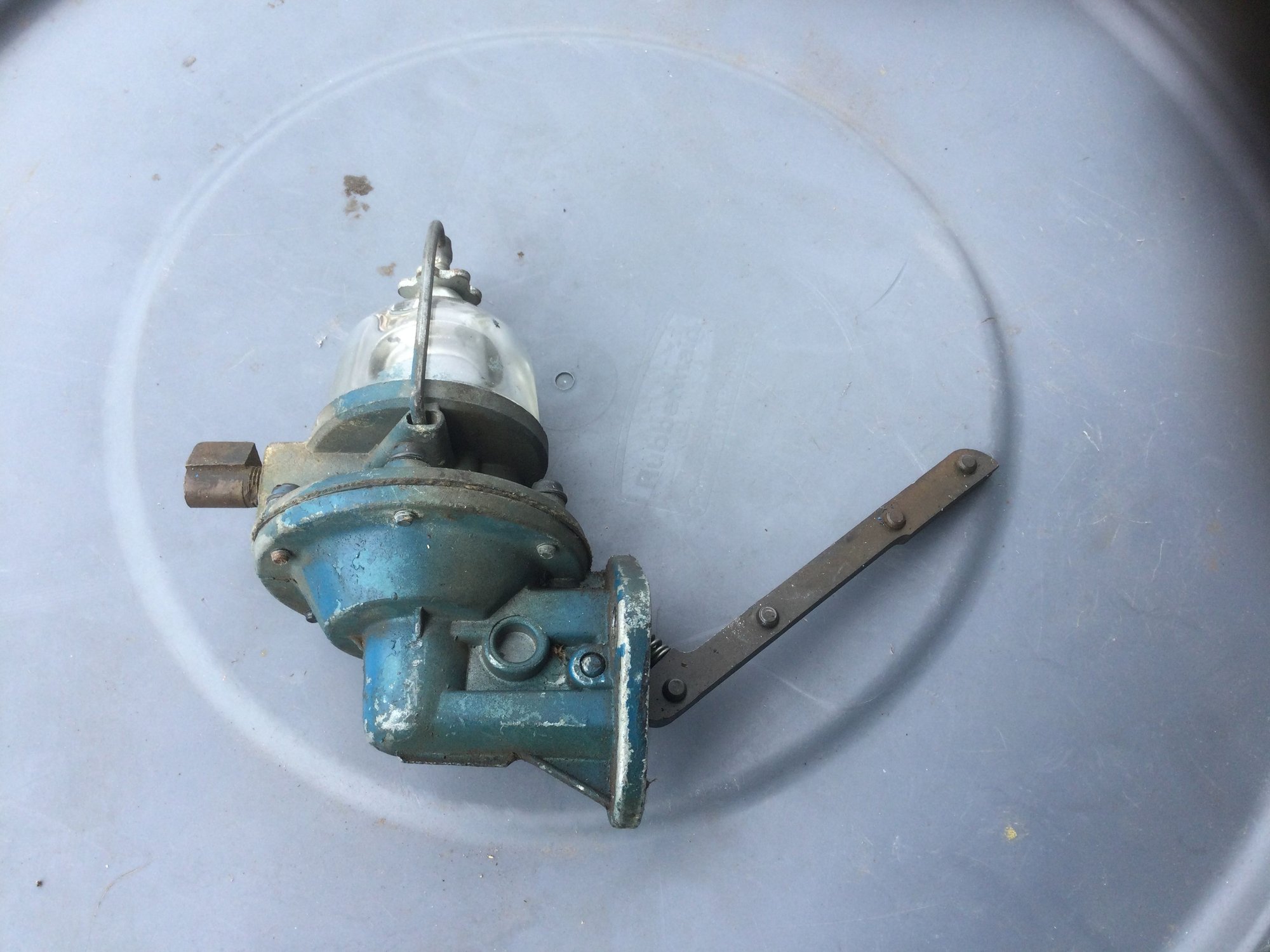

Phil, be careful if you order that one. I googled Delphi and the part number and came up with this picture. The arm looks way to short to reach the eccentric on the camshaft.
that Delphi looks like a 223 pump
Originally Posted by fastphil
you'll have to switch out the rod with the original one.
​​​​​​Seems like @fastphil is very aware

For those that need a fuel pump for a 239 OHV yblock, Napa has a replacement but you'll have to switch out the rod with the original one. The part number for the Napa fuel pump is mf0092. It's made by Delphi.
if that's the case, why not get one from auto zone for a FE 360/390 and change the arm. They fit right on a 55 and newer y block. I don't know the difference between a 272/292 and the early 239

The early 239 has a straight arm. The 272/292/312 has a bend in the arm.

Just have to switch out the arm with the original. Knock out the pin on both and put the long arm on the new pump. Fits perfectly.
