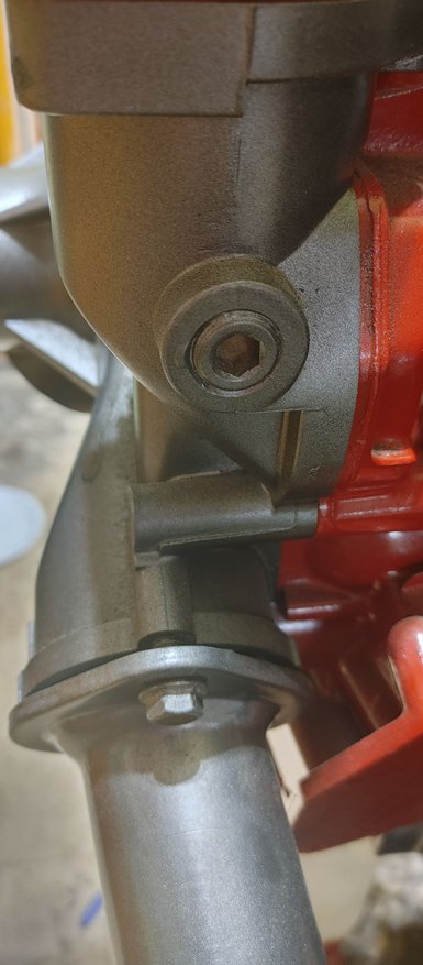

My truck has been leaking a small amount of coolant for some time. Just did the oil cooler again with a new front bracket. That seems to have slowed up the leak and area is still clean around the cooler. However the front driver side battery engine block ground is saturated in coolant. Maybe someone out there has seen this leak this before. Thanks

Yes after sitting under the truck I could see fresh red coolant drops appearing. The leak definitely appears reduced but still going.
Zoomed in photo about to give her a quick rinse

I'm not sure how much was disturbed while doing the cooler but from the pics it looks like the leak is coming from above. See how the grime is cleaned from the fuel line bracket.

Appears to leak from above the orange line after laying under the truck for some time.

How about this flange and that port plug?
