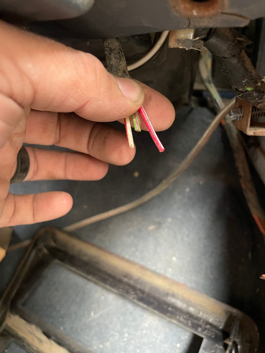

So what exactly goes there? Do all 3 wires go to it? Here is a picture of the wires if it helps at all
Old Aug 16, 2023 | 05:03 PM
jas88's Avatar
jas88
Joined: Feb 2002
Posts: 7,970
Likes: 595
From: Greater Austin, Texas
Red with white stripe should be battery power.
White with red stripe goes to the turn signal switch.
Green with red stripe is the brake light signal from the brake light switch.
Do your emergency flashers work? I can't imagine why somebody would cut off that connector unless they were going to relocate the flasher somewhere else.
Jump the white/red and green/red and then see if your brake lights work.

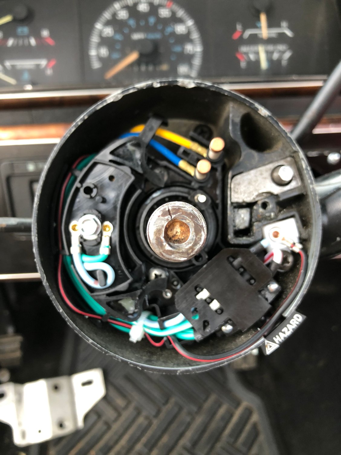

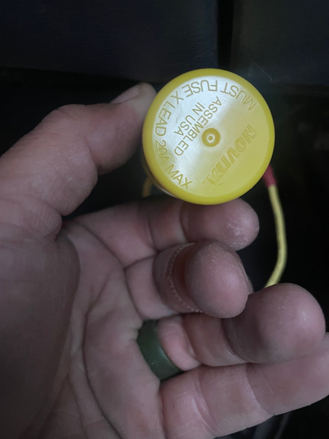

Old Aug 17, 2023 | 11:22 PM
Gibrojake's Avatar
Gibrojake
8th Gear
Joined: Aug 2023
Posts: 8
That was helpful I found the flasher button. So. Added some pics of what I had installed. And everytime I pushed on the brake it would be like the flasher was on. So instead of a solid brake light it would flash. I have it working now by just running the hot to the brake switch and it’s working. But what am I doing wrong on having it hooked up correctly? The wiring diagram I found shows the 2 going together so I tried that. Did I buy the wrong piece ti plug in?
Old Aug 18, 2023 | 05:40 AM
toolman60's Avatar
toolman60
Joined: Apr 2018
Posts: 551
Likes: 151
From: King and Queen Virginia
Looking at the alldata image you posted and your wiring you have it wired wrong.

Old Aug 22, 2023 | 07:03 PM
Gibrojake's Avatar
Gibrojake
8th Gear
Joined: Aug 2023
Posts: 8
Yeah you were correct I had it hooked up wrong. But I hooked it up correct way and brake lights worked but as soon as I crimped it all down, for some reason brake lights still work but when I turn on hazards it stays on not flashes. Honestly for right now I’m okay with it. And I did double check I had wiring right and when I plugged everything in at first it worked correctly. I probably just need to re do the connections. Thank you for your help
Old Aug 23, 2023 | 10:52 AM
jas88's Avatar
jas88
Joined: Feb 2002
Posts: 7,970
Likes: 595
Are you sure your flasher is good?
