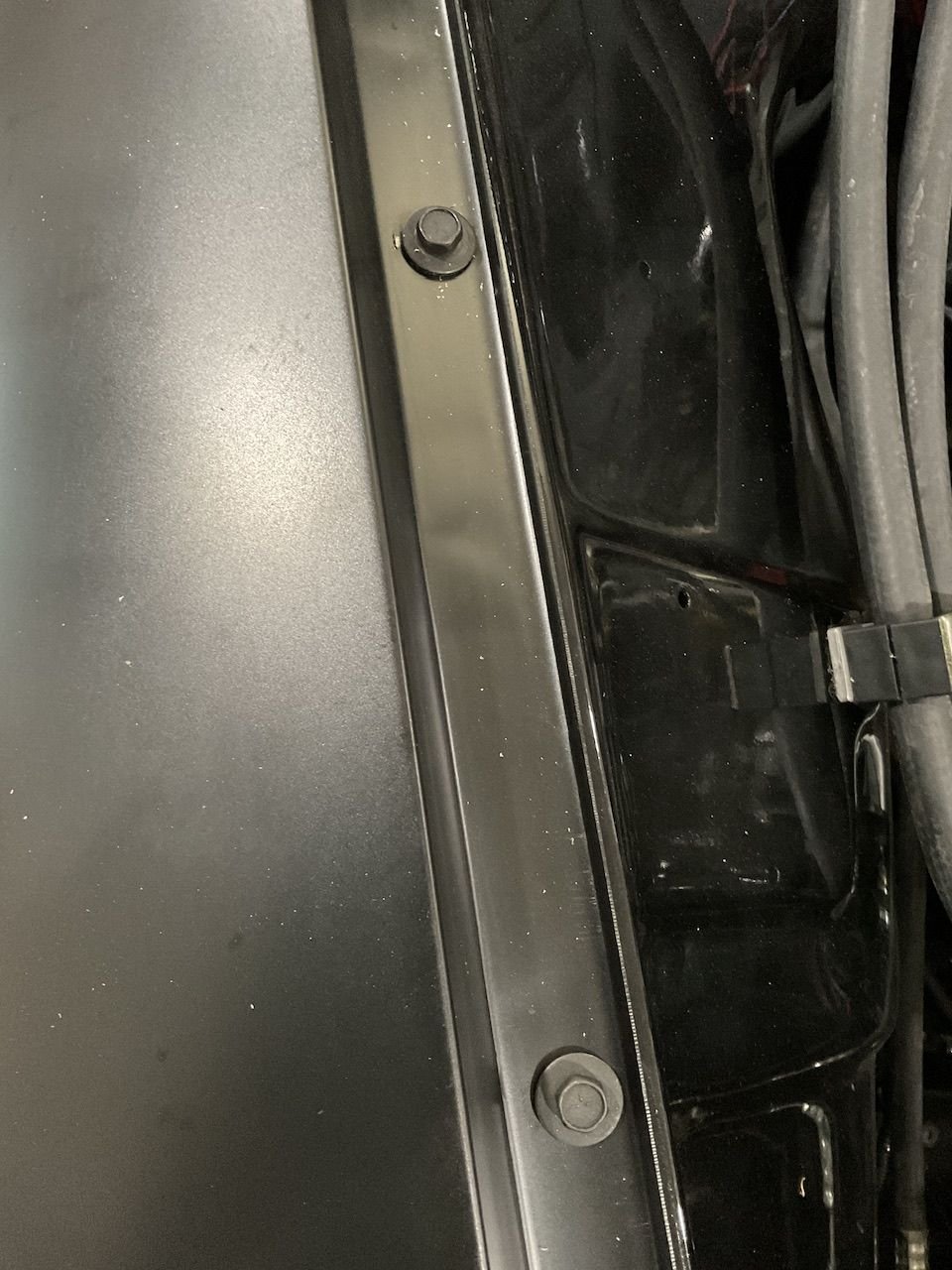

If you're not hung up on staying stock I'd go with fender bolts and flange head nuts. The original bolts are 5/16 X 3/4" fine thread. I ordered mine on line. I like the fender bolts because if you need to lengthen or enlarge the mounting holes their built in washer covers those spots.
