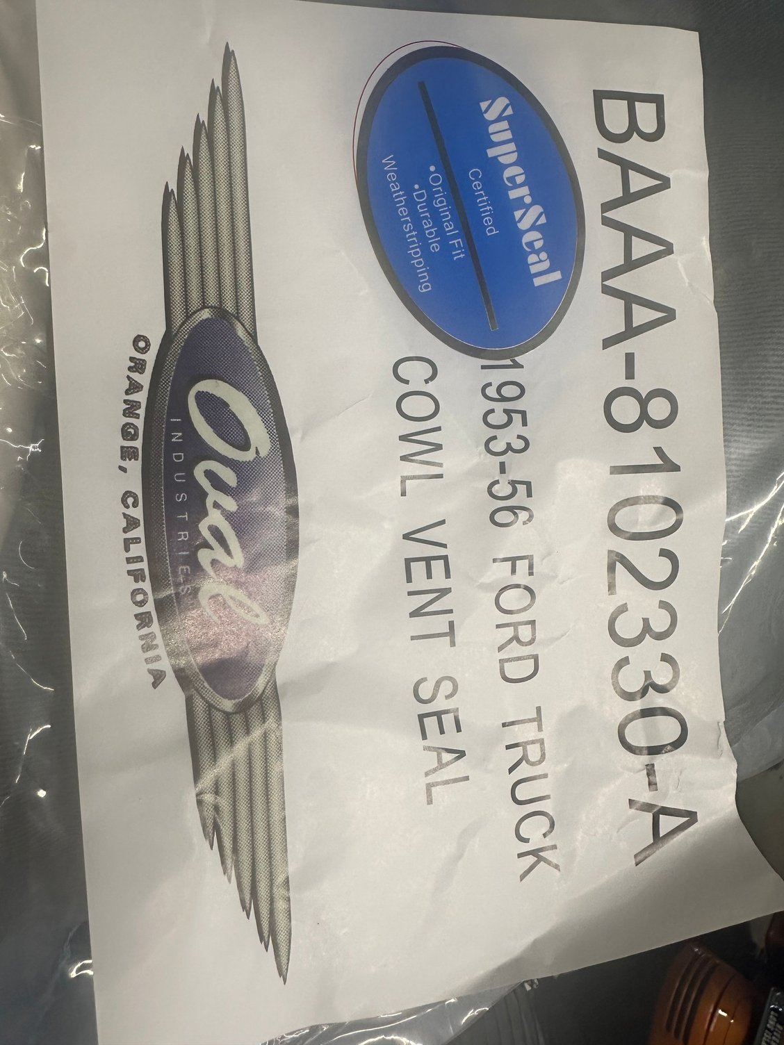

So I just wasted the day trying to get the cowl
seal to work on my ‘56, I was actually able to get it to finally fit let the weather strip adhesive to dry for a few hours in the sun then installed the cowl
itself and the weather strip will not compress at all as if it’s to hard, took it all off and without the seal it lines up perfectly, does anyone make a softer seal or any suggestions to get this one to work, it’s made by oval performance industries, trying to think about another type of weather stripping that could possibly work, thanks Pete

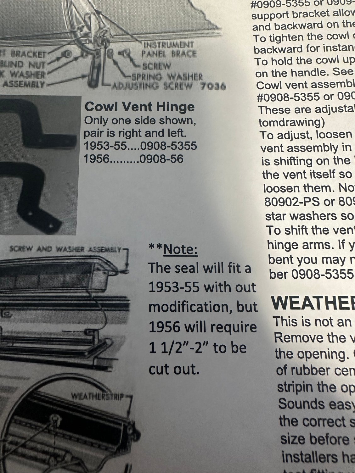

After reading a bunch of articles online they say for a 1956 you need to remove anywhere from
1 1/2”-2” , 53-55 no modifications, I’ll give that a try and report back
, fingers crossed

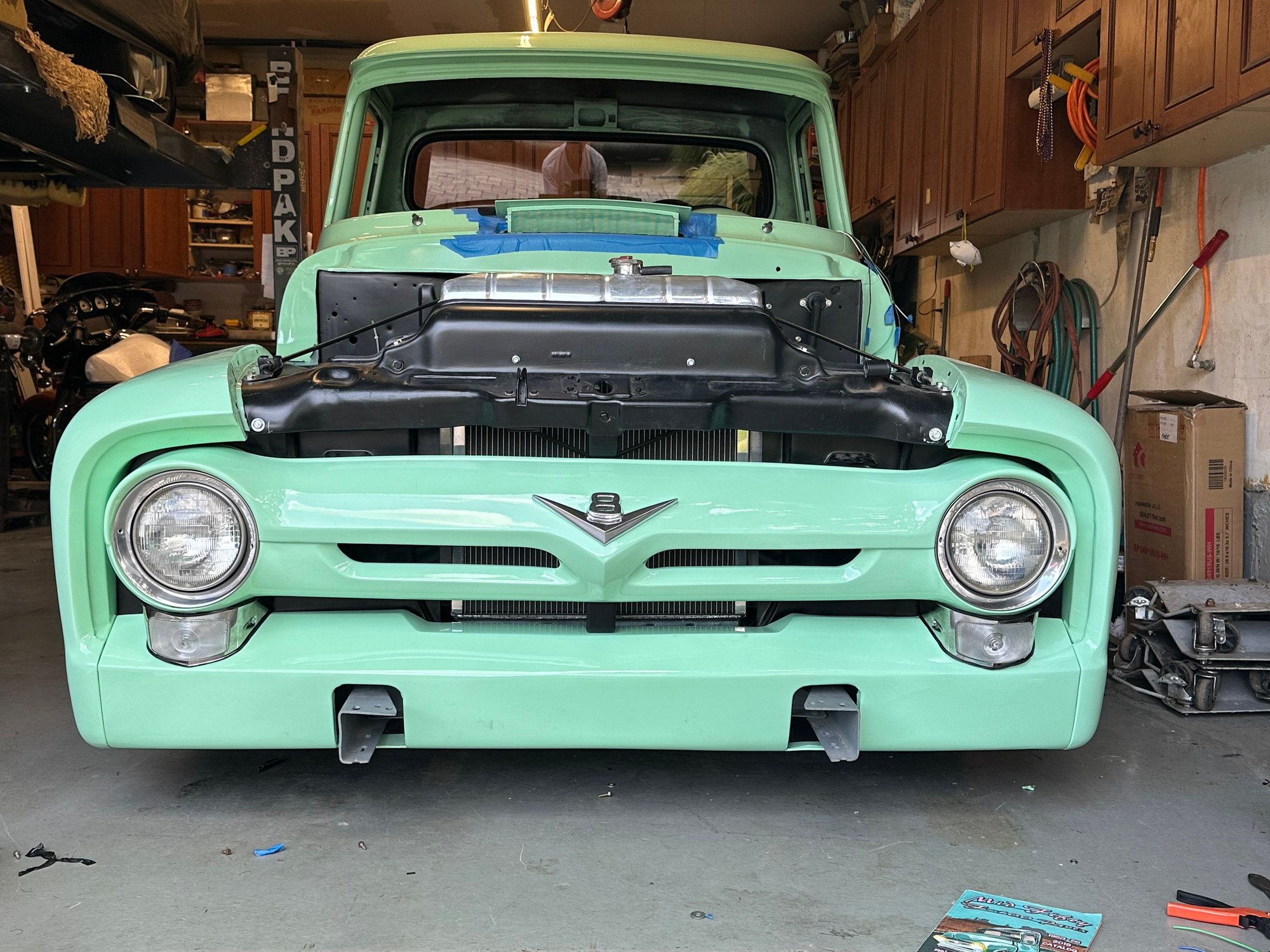

Unfortunately I am already past the point of closing it up, I actually think the fresh air is one of the cool things on these old fords , I’ll keep looking and maybe find a different weather strip that can possibly work, thanks aga
in
