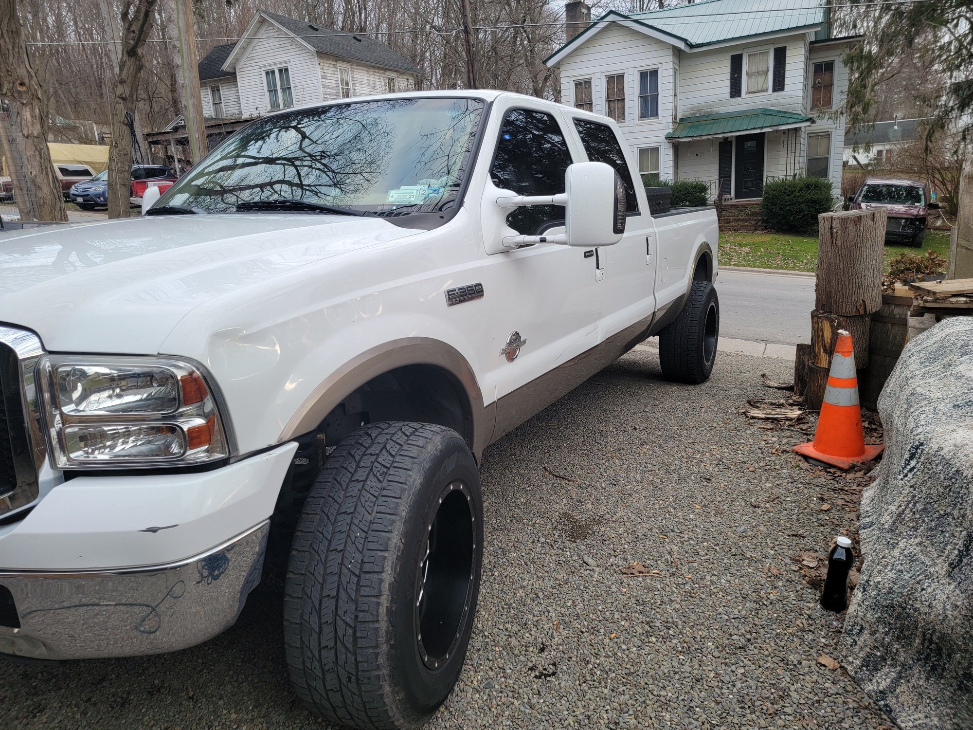

I thought you were in the wrong forum when I saw the door emblems. You're describing a typical "hot no-start," which is usually caused by a leak in the high pressure oil system. When the oil is cold, it's thicker and doesn't leak, but after heating up and thinning out, it leaks past an o-ring so that pressure is not able to build.
