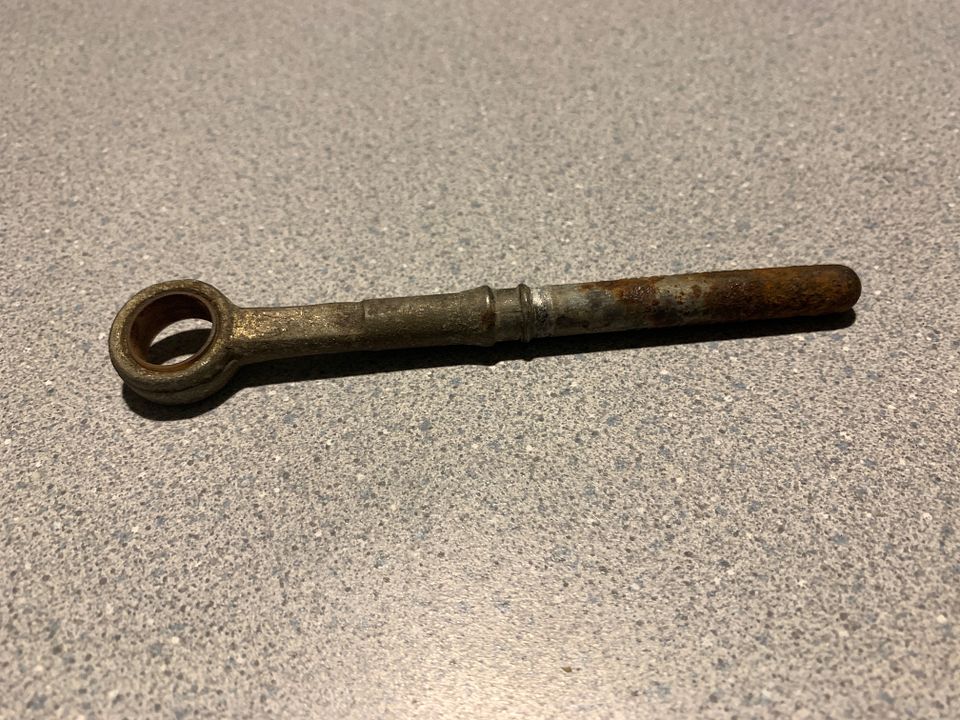

I can find at least 6 different master cylinders that Ford used for Drum/Drum systems between 1967 and 1972. Some of them used different length push rods. What push rod are you using? The one your truck came with like this one in the picture? This one is 4 31/32" center length. Just thinking if there's a chance it needs a bit more length to reach full fluid movement.

Yes the rear port is hooked to the front brakes. The pushrod is adjustable, I adjusted the pedal so it’s just touching the bump stop, the pushrod from the truck is not usable because brackets for the booster push it out further from the fire wall.
