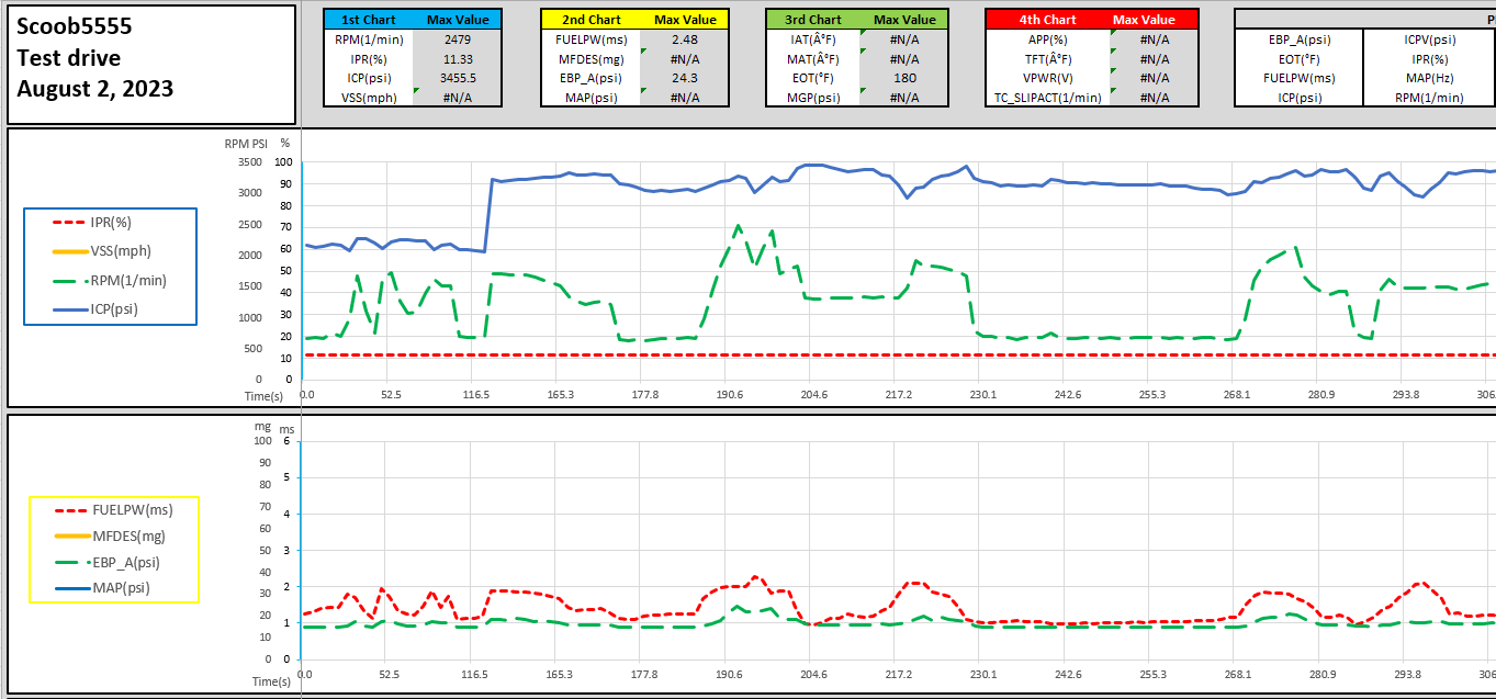

Here is the requested file. Sorry, I’ve been juggling working on the truck and racecar this week. Looks like the IPR value only changes from 11.33 to 11.72 when I was driving up our big neighborhood hill. Is that normal behavior from the IPR?

This is some pretty strange data. IPR% is stuck at 11.33%.. ICP starts around 2000psi and then jumps to 3000psi and stays there. PW looks like single shot injector values, though that might be the PCM trying to correct for crazy high ICP. In fact, the PCM could be holding IPR% at idle, given ICP starts so high.
Where did you purchase that Motorcraft IPR? There have been some fakes out there. Do you still have the plastic bag it came in? Spelling mistakes are a clue that the IPR is fake.
Check the IPR wiring for opens, short to ground and short to power, between the IPR connector and the PCM connector. You could check it from IPR to 42 pin connector first to rule that part of the wiring out.
If that checks out, the IPR itself is the next cheapest item to change. Sounds like it might be questionable given the feedback you have seen from where you purchased it.

Yeah wow that ICP jumping up and staying there is very odd. If the IPR turns out to be genuine Ford, it might either be a lemon or there might be contamination jamming it.

So the 11 percent IPR you are seeing is what the PCM is commanding the IPR to do. I don't know why the PCM isn't commanding the IPR to increase with added throttle but being that your ICP is acting wonky also I would disconnect the ICP and make the same run up the hill just to see how it compares. If the ICP is telling the PCM that it already has enough oil pressure , the PCM is not going to command the IPR to open . Did you get the ICP sensor from Amazon as well? Hang in there, and I wouldn't take the truck to a diesel shop as you are just going to be paying them to throw parts at the truck anyways, most mechanics now days don't know how to diagnose these trucks the just break out the parts cannon...
