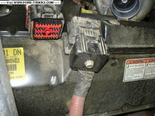

This is the problem you are looking for under the 42 pin harness.
Also, how did the injectors sound when you did the buzz test?
