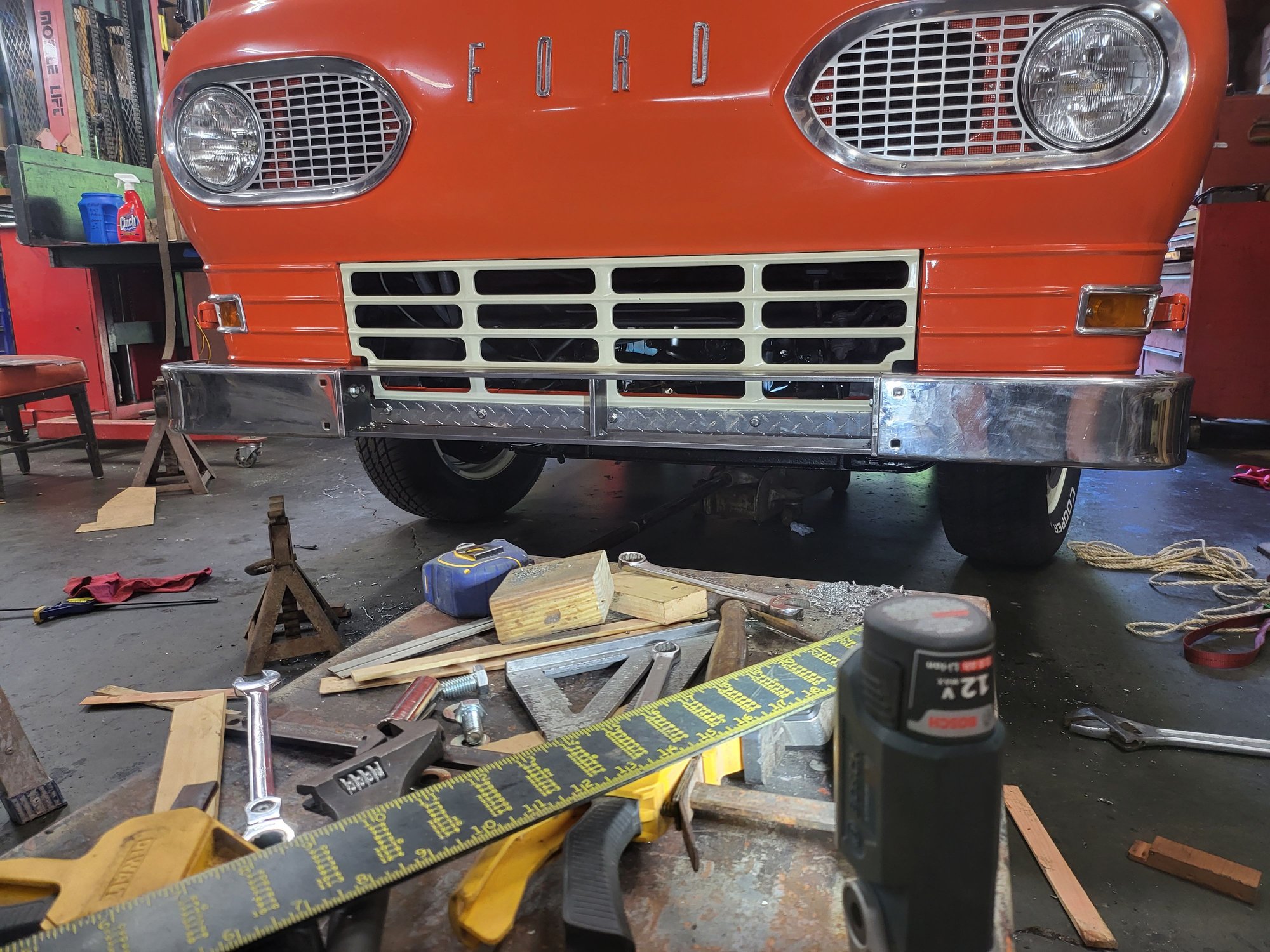

These do have temp issues under the hood, I drove mine for a full year before taking it apart to restore it. I live on Ca[e Cod, so not as hot as the boy and girls in the south, so I didn't have any overheating, or vapor locking, but mine did get hot enough under the hood after shutdown to boil gas in the carb and make the cab stink of fuel. If you insulate the inside of the hood it will help the cab a bit, but I'm going a bit further. I have a pair of small,13" fans that I am mounting under the hood facing down, and running them off of an attic fan thermostat that I can set at 150 degrees, so after I shut down the fans will run til the engine compartment gets cooled. I also built a new front bumper that clears the way for air to intake the full size of the grill. I also incorporated an air temp gauge for under the hood so I can monitor what is or isn't helping. I should have it back on the road in a few weeks to start experimenting. Keep in touch if you want updates. I'll attach a pic of the bumper modifications I started yesterday.

finished the front bumper today, just needs paint. Now I have clear air to 100% of the grill.

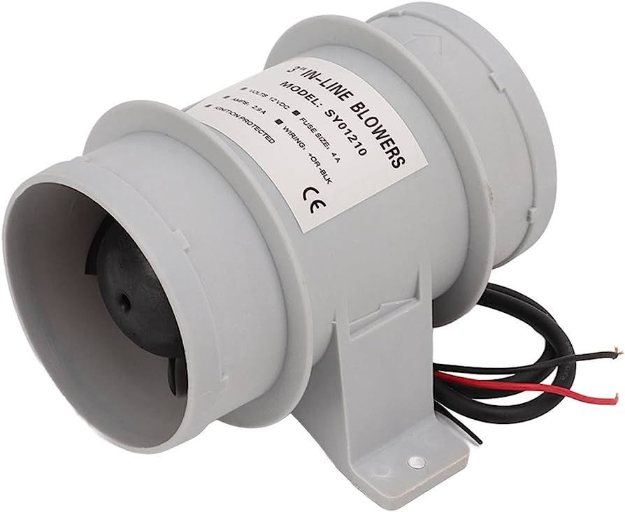

I'm thinking the same thing. I've been looking around on Amazon. Here's what I'm thinking:
bilge blower: https://amzn.to/46FrIIZ
Thermostat: https://amzn.to/46EetrT
3 inch hose: https://amzn.to/44xNIn8
Not sure if the 3 inch hose will hold up to the heat, but I guess I'll see. I think I'm going to run the hose from the driver rear corner of the doghouse down to the bilge blower mounted under the van. I'll have the thermostat set to turn on at a certain temp and shut off maybe at 150 degrees or something.

I think the problem with heat in the doghouse is only after shutdown, or when stopped. Since I installed a belly pan I never have problems while running. Just when restarting, like after fueling.
As to the hose holding up, I’d use dryer vent type metal hose.
