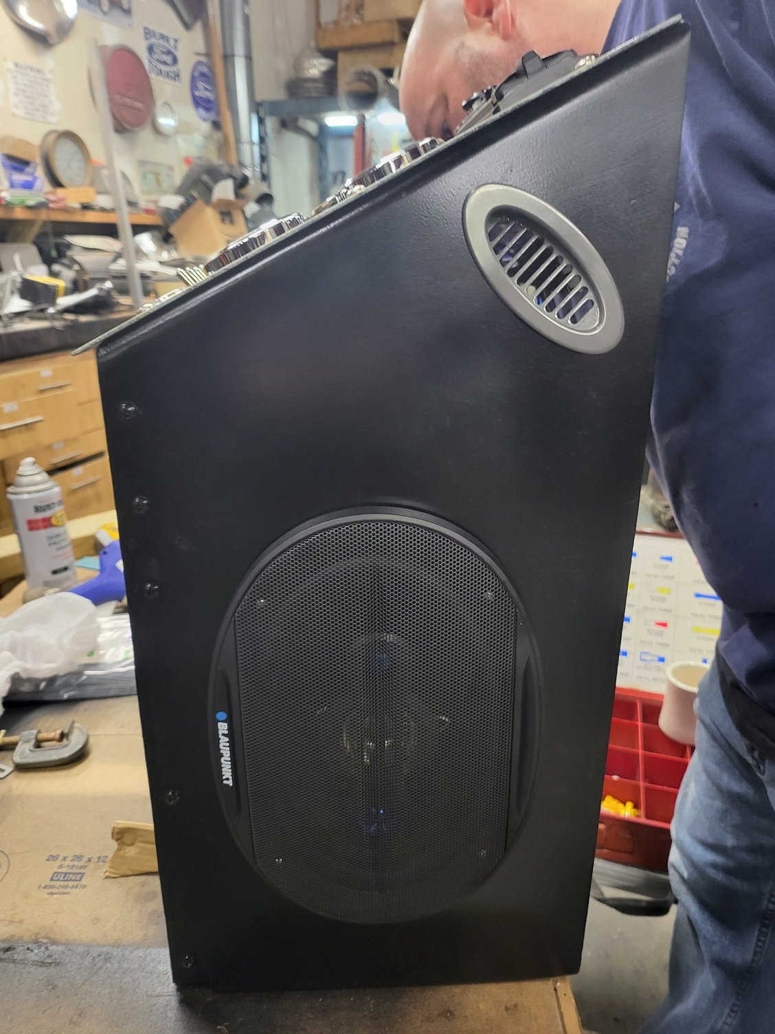

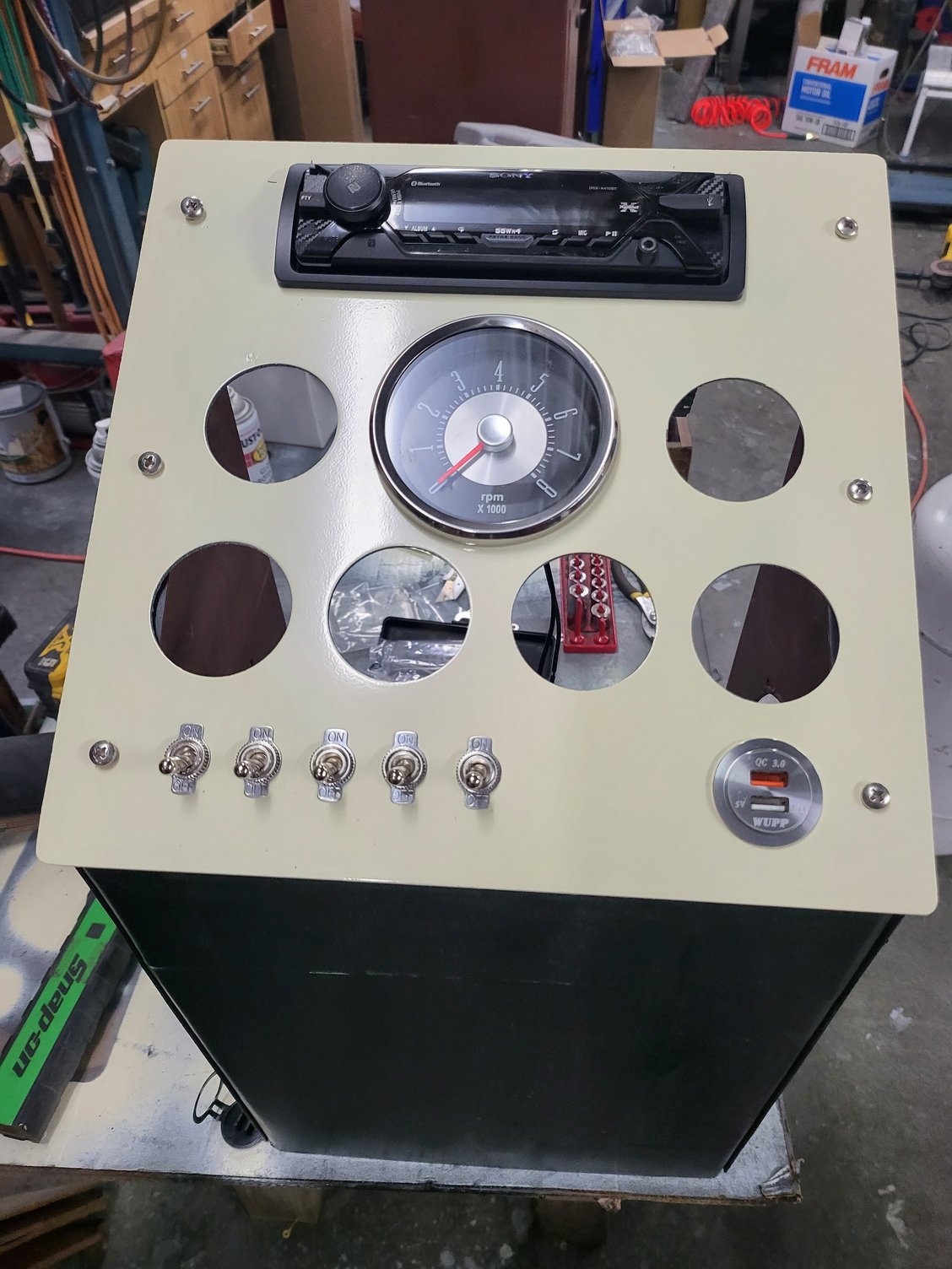

I decided to go with a Console panel in front of the engine box. I built this yesterday, I ordered some gauges from Speed Hut to match the
65 Ford Tach. Should be here in a couple of weeks.

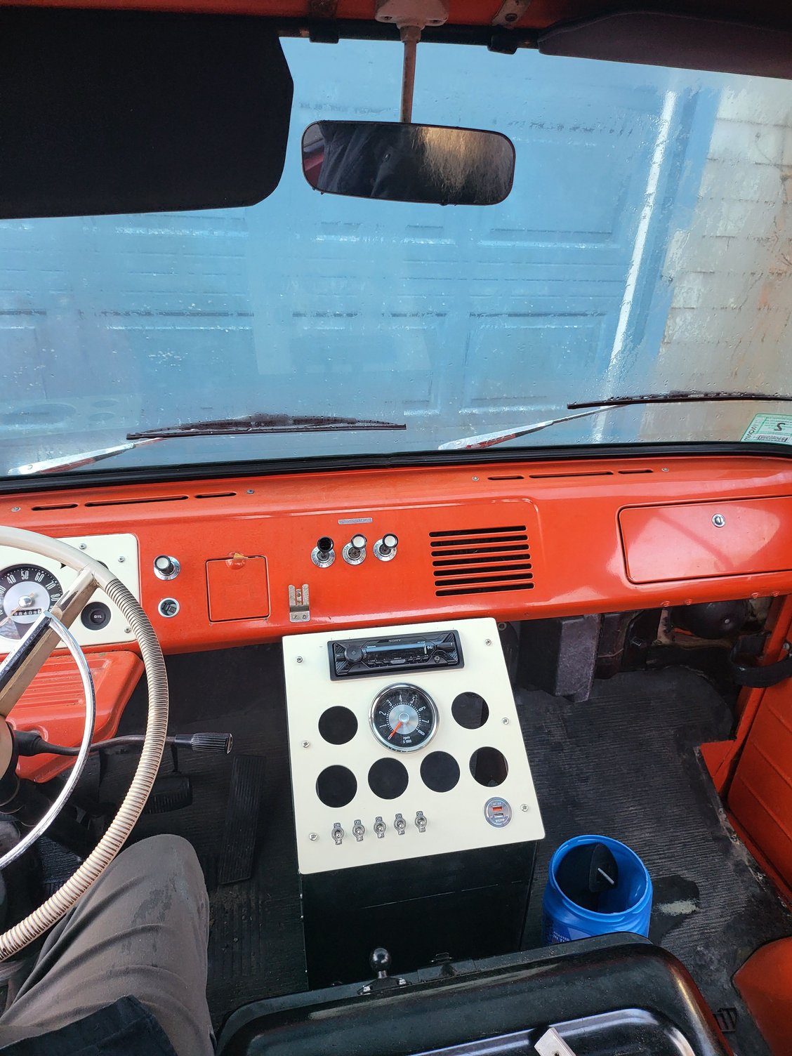

Put some paint on the console yesterday
, still waiting for gauges.

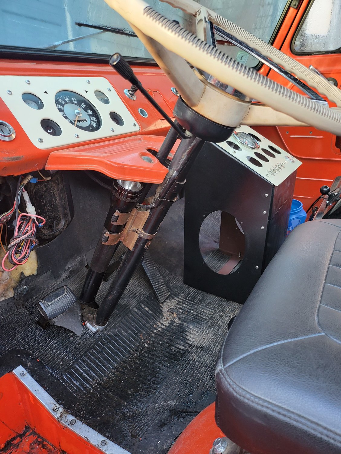

put it in place to see how it will look. Also I should be done painting the '65 Falcon on Tuesday so the E-Pup will go on the rotisserie for it's RESTORE. Going to replace rockers, wheel wells, rear corners and valance. ALso going to install '65 Mustang buckets, and do some modifications to the cooling issues that plaque us all.

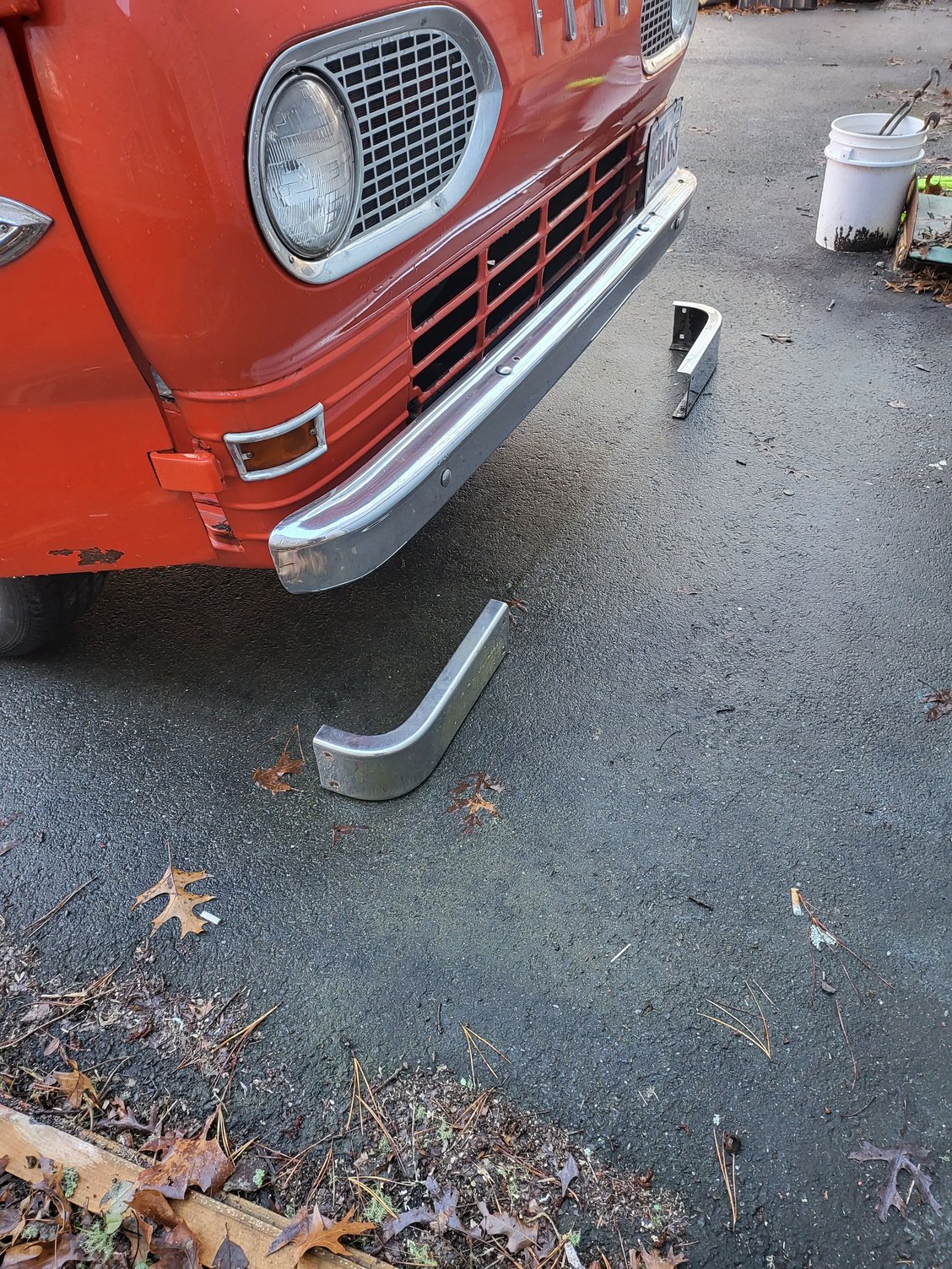

I just scored a pair of 1/4" thick good stainless steel bumperettes off an old ambulance that fit perfectly on the front of the E-Pup allowing total exposure of the grill.

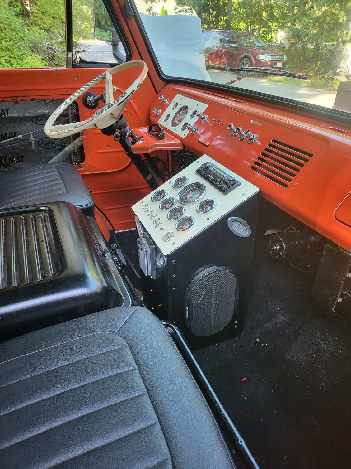

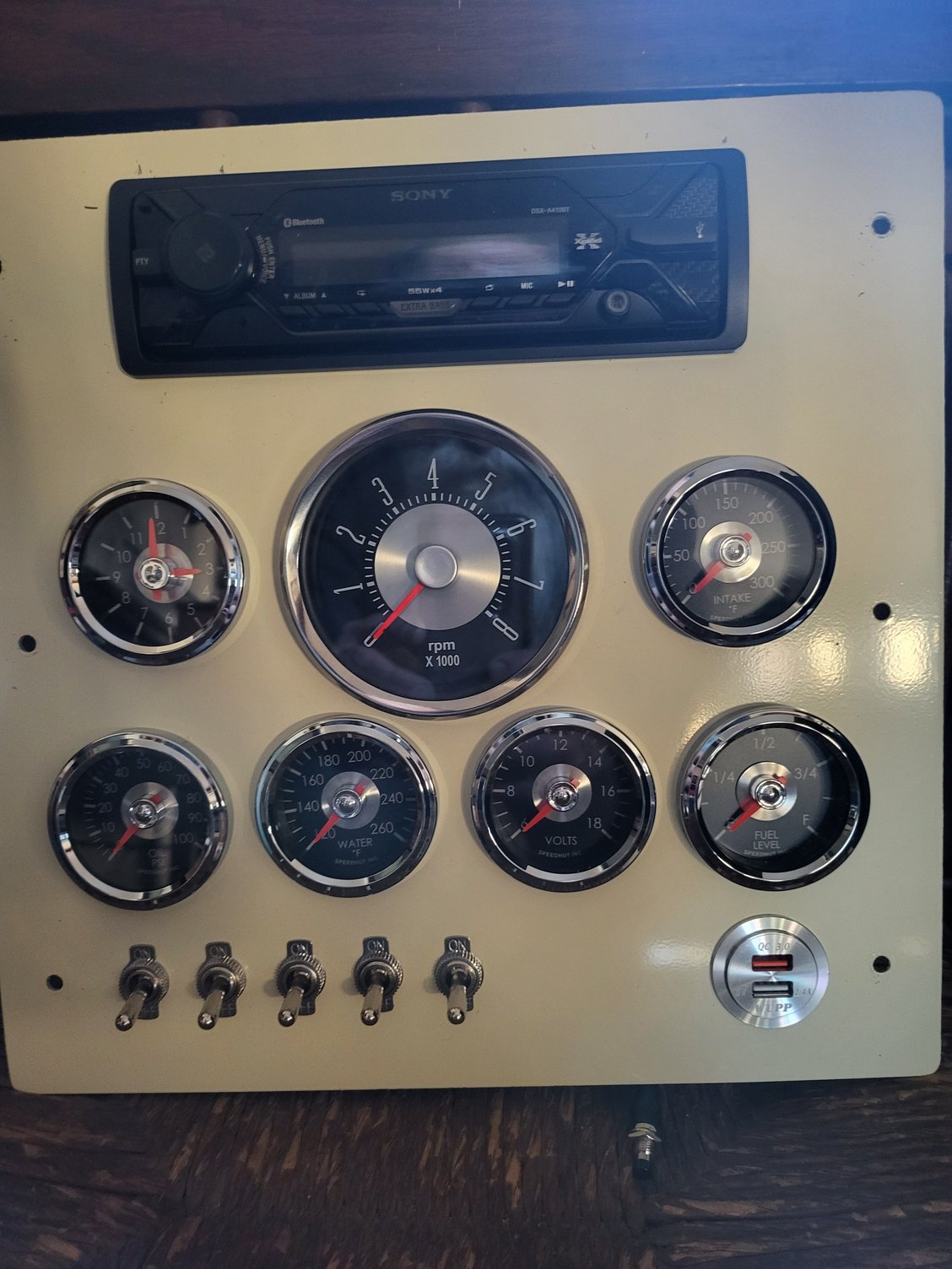

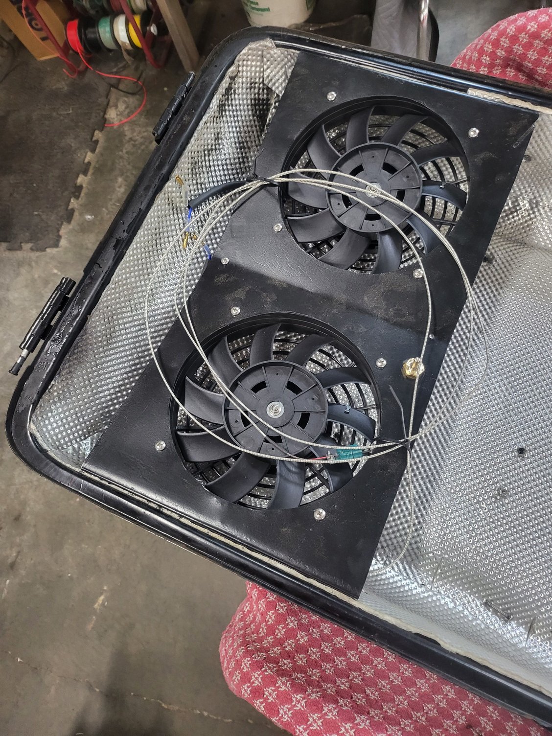

My custom gauges showed up, I have the oil,temp,volt and fuel gauge, and I added a clock and an air temp gauge for under the hood to monitor the results of my under hood fan setup I'll be installing. maybe solve that boiling gas issue many of us have.

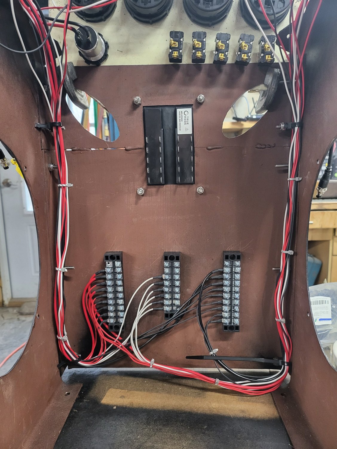

Well, I've been sick since a week ago saturday so progress hasn't been great. I've been working on sheetmetal as much as I can, trying to fit the '53 F1 cab corners to the rear corners on the E-pup and fabricate a new valance pan between them, I also have to incorporate a receiver hitch and a bumper that is still undetermined.
I did some finish work on the console and wired it on the days I felt like crap, that all came up pretty good I think.

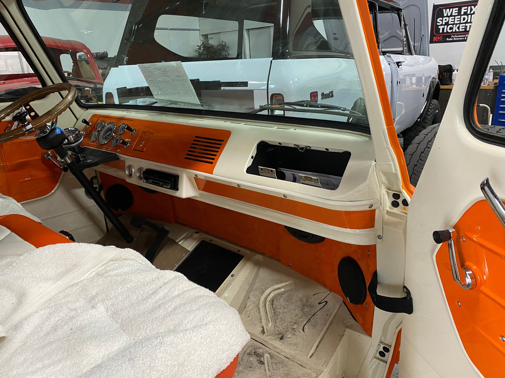

This was my solution for adding gauges and a head unit with a flip up screen.

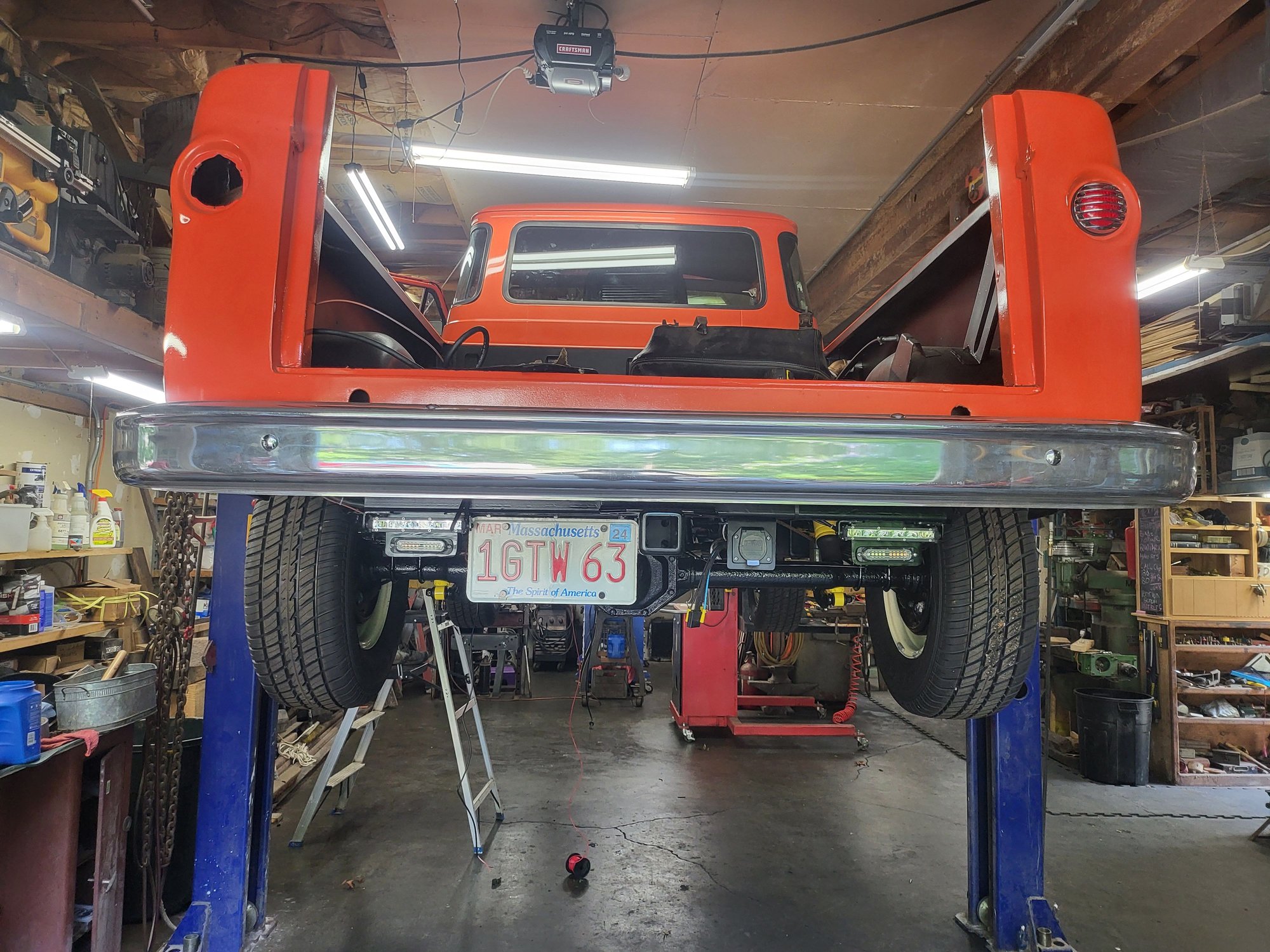

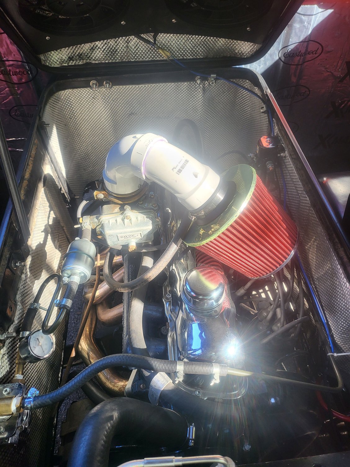

Got her back on the road about a week ago for shakedown Cruises. Didn't go as originally planned, but did a few upgrades, did the custom front bumper to allow for better air flow, put the temp sensor in the engine compartment and a couple of small fans to assist with the under hood heat. Put the original front bumper on the rear and built a receiver hitch, back up flood lights hidden under the hitch, strobes front and rear, headers and dual exhaust. I also dropped the center aluminum piece front the side SS trim. ANd added the console I built with the gauges, stereo, speakers and AC louvers. She's got the 14's in the front and `15's in the rear with air shocks. 19 gallon fuel tank with side fill and vent.

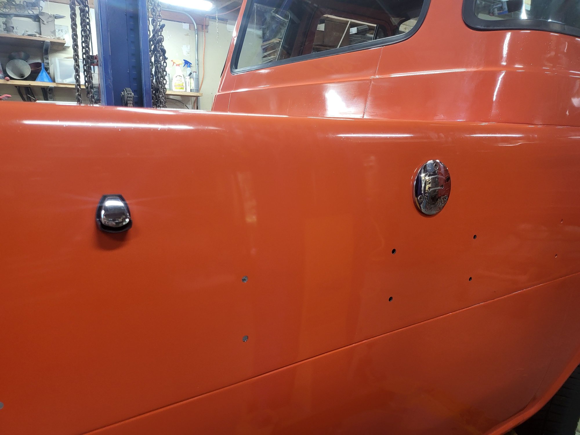

I added some tie down strips to the bed, they work nicely. Only issue I have with what I've done so far is my gas tank filler neck and vent. I need to figure out why the auto shutoff gas pumps wont stop quick enough and she spits gas out when it kicks off. there are a couple of things I want to change however.
