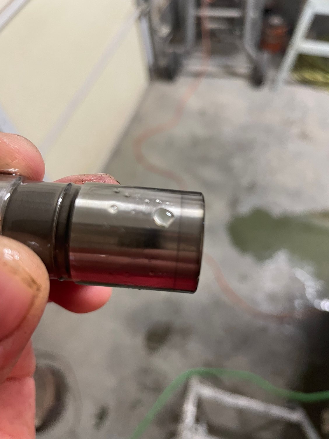

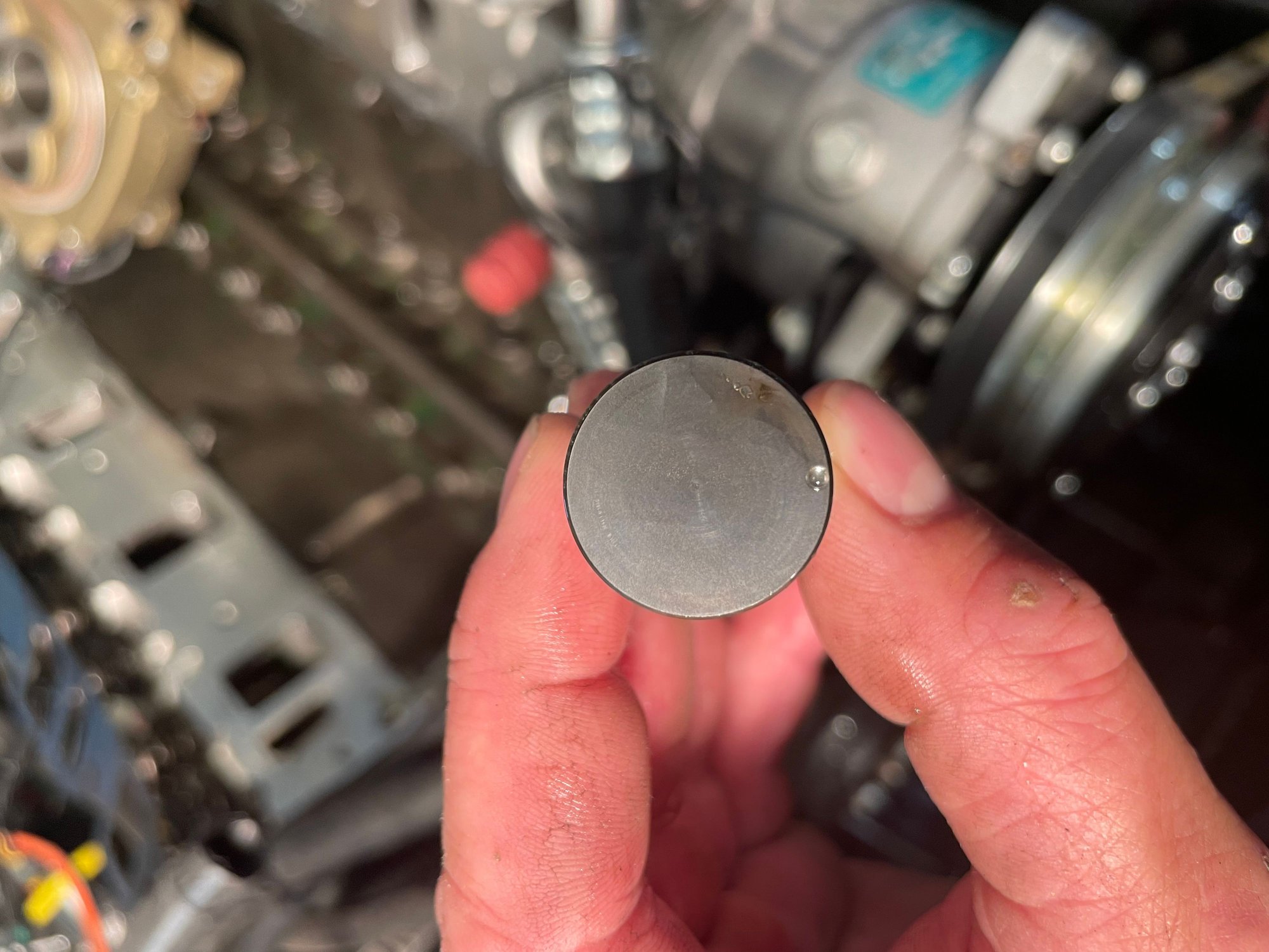

Pulled the intake and checked out the lifters this is what they look like.

I'm a little late to this, but looking at the video, you need to talk with whoever built your engine. A running engine with the valve covers off should be throwing oil everywhere in the engine compartment. I don't think the problem is with the lifters but with the oiling system. There should be oil coming out of every crack and crevis of those rocker shafts.

A correctly built FE engine does not pump excessive oil to the upper valvetrain. If it does it usually means that the rockers and or the shafts are worn out or messed up in some way. Here's a video that I've shared before of a 428 running on my dyno. This engine has a hydraulic roller cam but it uses the stock non adjustable hydraulic cam valvetrain. This is idling hot with 10W-30 oil.
Either way, the oil to the rocker arms is independent of the oil that feeds the hydraulic lifters the supply isn't derived from the same place. The hydraulic lifters receive oil from a passage way that taps into the main galley the one that's wide open in the video. You need to get that plugged and it should fix your problem.
