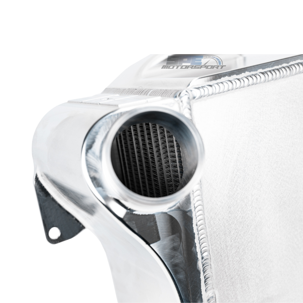

A lot of these posts are from about two years ago, so I’m not sure if the PPE intercooler was available then. Does anyone have any input on which one might be better or preferred? I’m deciding between the PPE and the Mishimoto intercooler. I already have the Pusher pipes and coolant tube on my truck, and I know the PPE works with them because Arod made a video showing it hooked up fine to the Pusher pipes.
It seems like both options are about the same. One thing I like about the Mishimoto intercooler is that I can get it to match the Pusher pipes. However, I figured I could do the same with a raw-finished PPE intercooler, but I’d rather not deal with the hassle of getting it painted.

So if money was no option, for me, I'd probably go with SPE's "booklung" CAC... because it ain't cheap and its built like a brick schitt house...
Way back when, I liked the Mishimoto CAC...
But when I saw the PPE CAC, IMO, it looks to be bigger than the Mishimoto cooler and very similar in size to the SPE...
Now, I'm no expert, so take it for what its worth, but i like the PPE cooler... more than the Mishimoto... last time i looked at it online. I have no personal experience with either, just stating my views...
either would do well in my truck. I just think the PPE is bigger, like the SPE and will flow better, than the Mishimoto... but i could wrong...
Good luck.

I really like the SPE option, but I just can’t justify the price. If I were running bigger turbos or had more horsepower, I’d definitely consider it. I appreciate your input and hadn’t fully considered the size difference before. After taking a closer look, I can see that the PPE is larger and provides better cooling compared to the Mishimoto based notes from each site. While the Mishimoto seems better built than stock, its cooling performance appears to be about the same. I’m leaning toward going with the PPE. Thanks again for your help!

No problem. Yeah the SPE would be for a track truck or puller, with bigger turbo, injectors, etc.. and definitely overkill on a stocker like mine. Since the PPE is a little more than the Mishimoto and seems to have more benefit, that's the one I want to go with...
I thought this review on the PPE CAC was interesting:
"I have a 2019 f350 with Compound turbos from Pusher intakes I was originally running the no limit air to water intercooler however, it popped at 50 psi so I tested the PPE it didn’t pop til 125psi so I ordered another one in red to match my pipe kit ! Besides booklung air to water by SPE ($3500) this is the best there is specially considering price !! I haven’t been happier and I definitely notice the difference in the way the motor runs under pressure and my EGT’s haven’t hit more than 930ish and that’s punching it on 5sotf switch with a hot clean proven tune !"
This is interesting though...
SPE's cooler core that runs vertically:
PPE's:
Image 10 of 15
